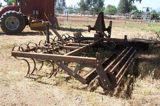

mine somehow looks alot like an arena vator does an excellent job. the teeth fluff it up and break up the big clumps, the blade behind the teeth levels and flattens and the roller packs it down alittle. the wife loves the way it leaves the footing. jon
