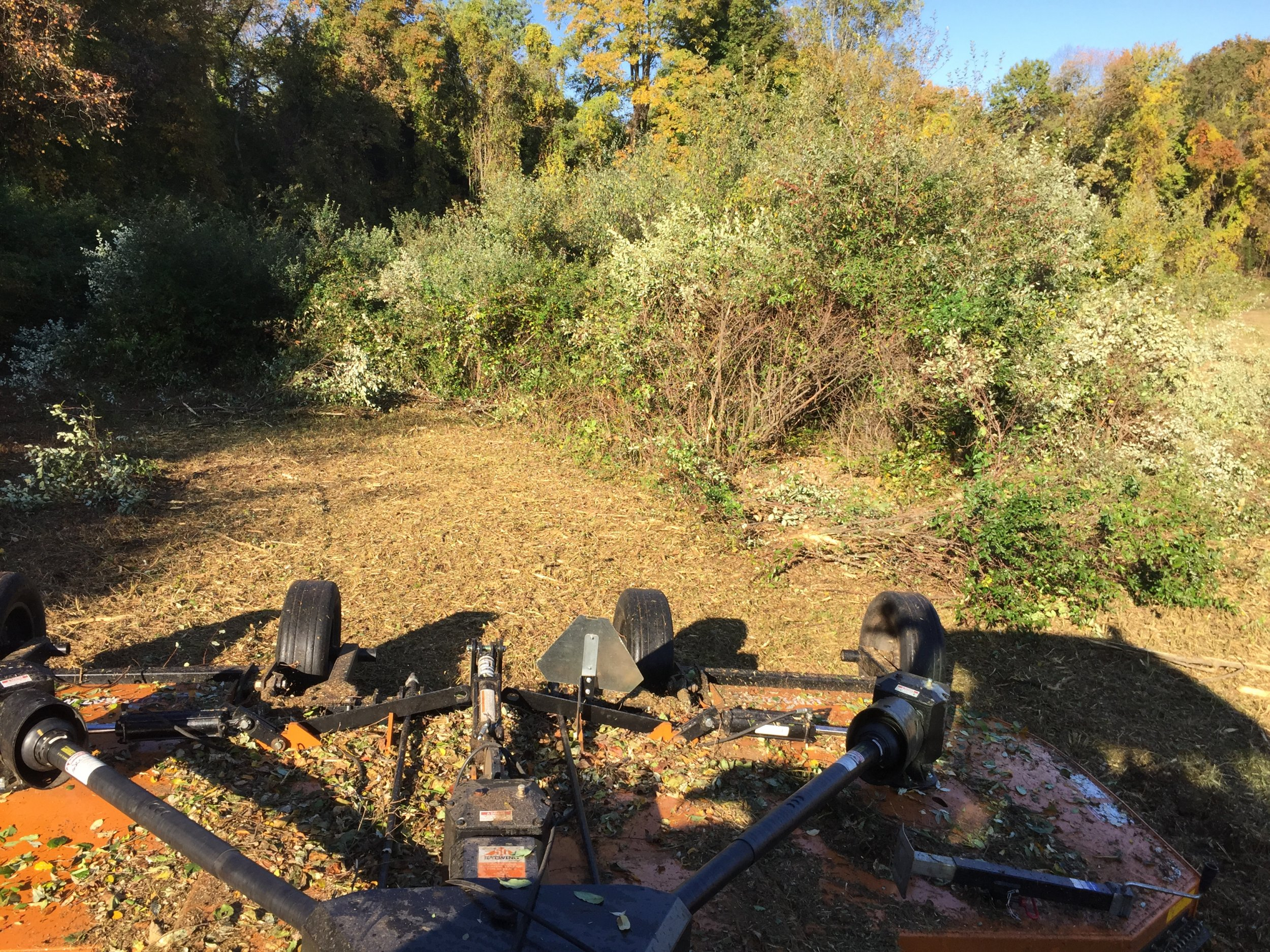

Once the brush is cut and the rocks are marked so you don’t hit them, I would mow the existing vegetation down to the ground (I call it scalping) in late summer. It would be at this time where you would get soil tests to see what your soil needs. My guess is it will need lime, or other key minerals. Lime is pretty easy to spread. See if you have any local compost available. It could be poultry litter, mushroom compost, composted leaves, etc. Inquire about cost for delivery.
I would then rent or hire a seed drill and drill in the best choice of hay grass that grows in YOUR area about 8 weeks before your first frost typically happens. This will give the seeds enough time to germinate and develop into seedlings to survive the winter. Before winter hits, spread your compost in a thin layer, maybe 1/2” to 1” max so you don’t smother the seedlings.
Next spring, the seedlings will become your crop.
HERE is a picture I took about 10 years ago of mowing a property overgrown for 20 years with woody brush. Picture was taken in October. The following year, I took 2 cuttings of mulch hay off of it. Today it produces many tons of mixed grass hay.

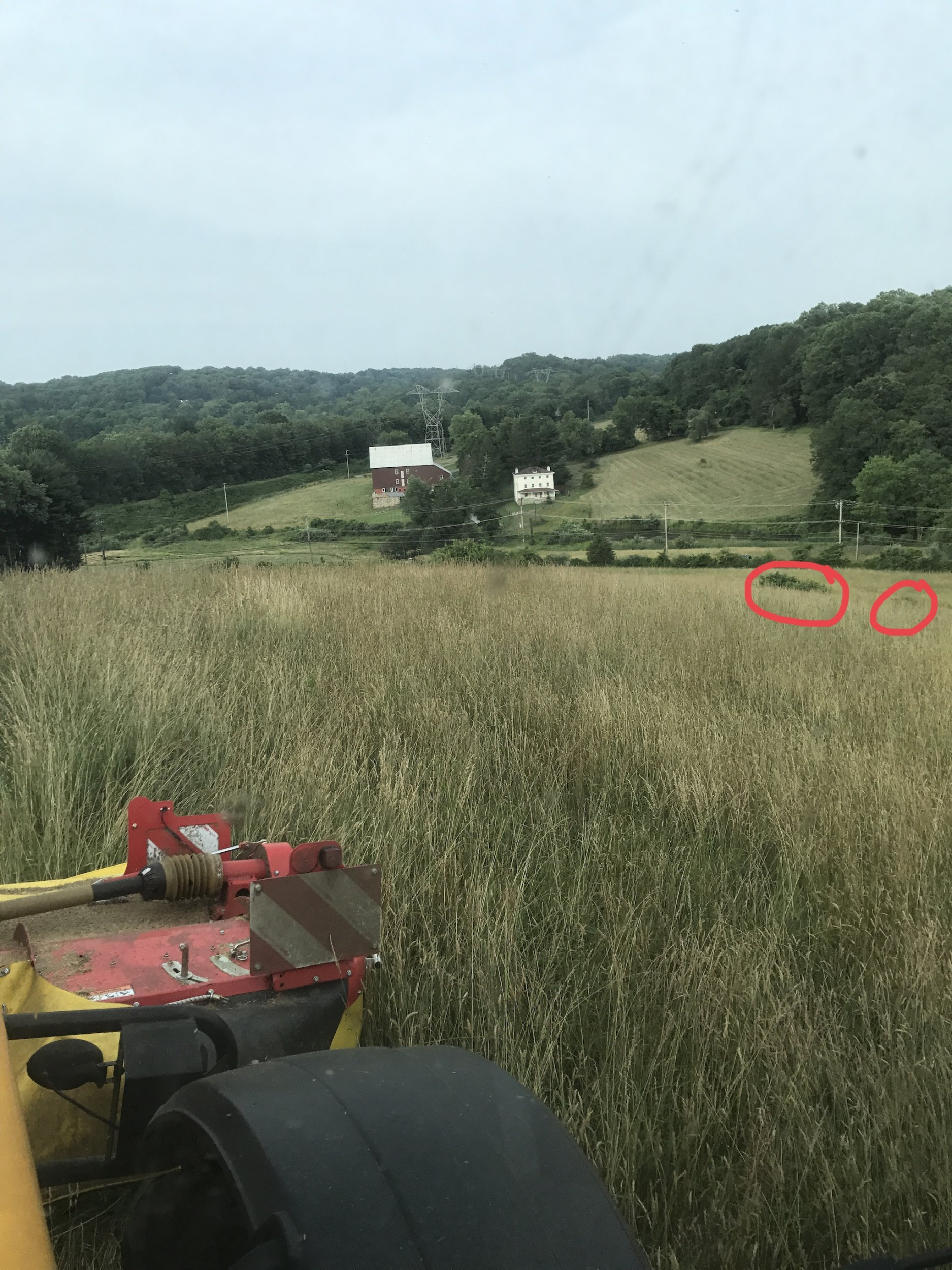

Not the best picture, but in it you see the area circled in red? There’s about 10 boulders sticking up that would damage a mower. I just cut around them. The entire field has boulders. Some I have removed, some I intend to remove, hopefully soon.
By the way, when you dig out a boulder, just enlarge the hole a little deeper and push to boulder back in the hole. That way you don’t have to deal with moving or storing the boulder.

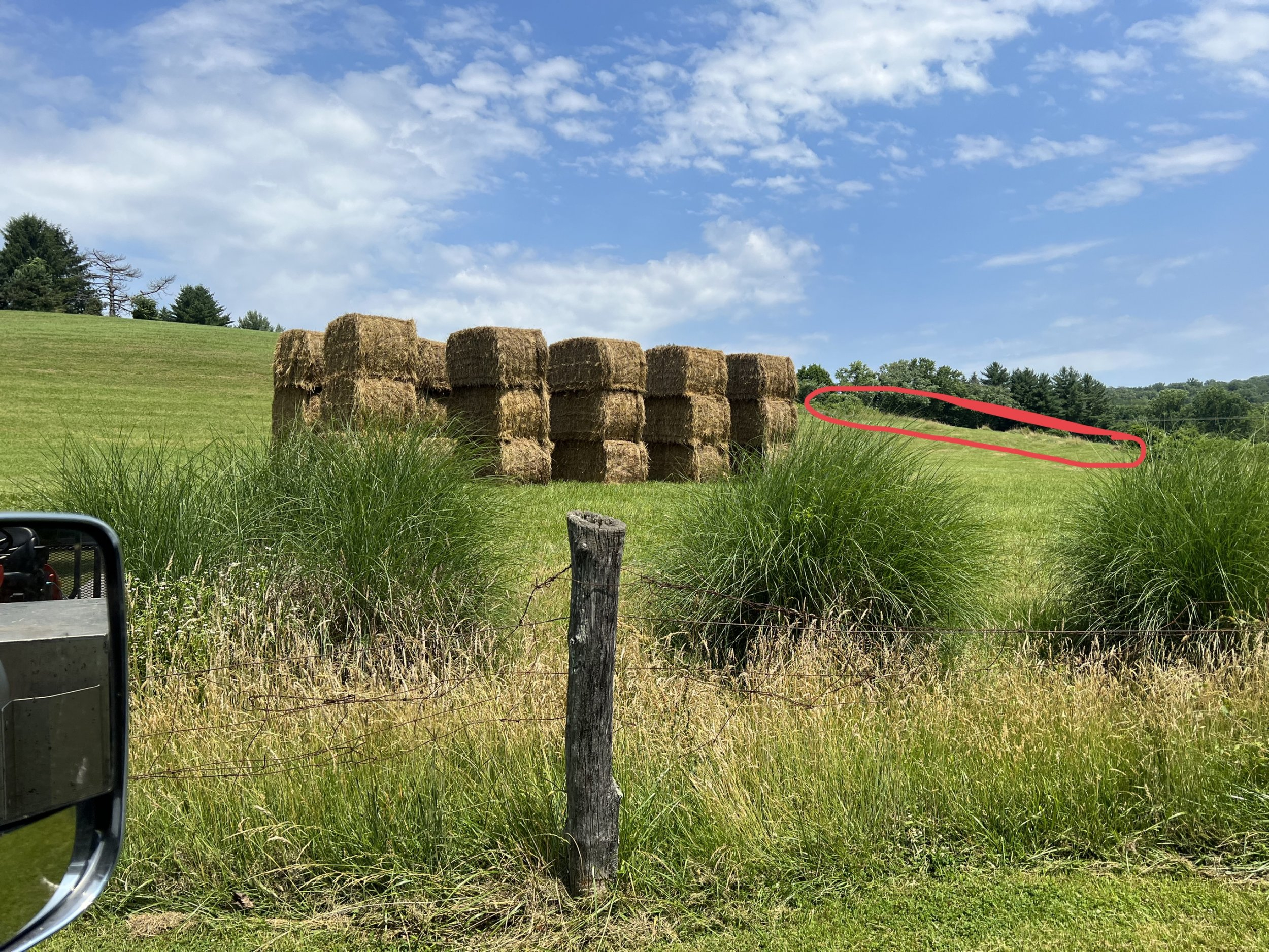

THIS pasture was nothing but weeds and stickers 5 years ago. Now it is a very productive 95% grass field that I hay 2 times per year.
It has never seen a chisel plow, a disc or any chemicals.
Rock outcroppings circled in red. The brush around them is a natural way to warn you to stay away when mowing/baling.
The simple act of frequent mowing kills brush and encourages grass growth.
You don’t need to spend a lot of money or buy any chemicals to get the field back to growing hay.
