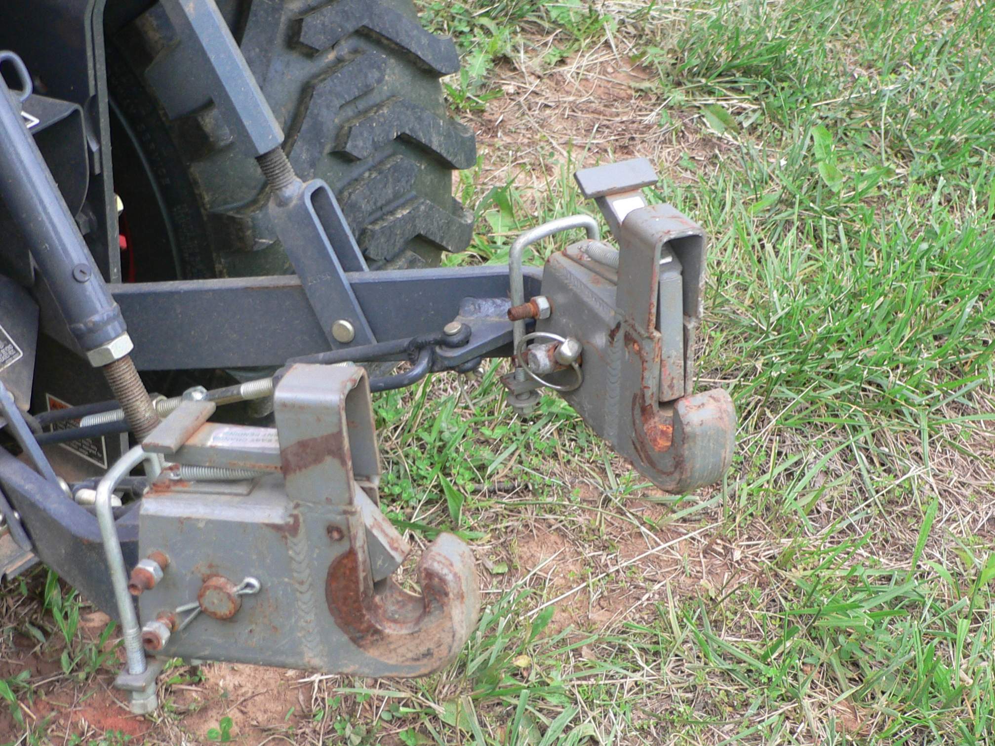

Is there a Pat's for the BX25? If so is anyone out there using it, how well does it work. I put my new sprayer on this weekend :mad:and #*#&$%^# :D. If there is one made I'm in

I have a Pat's on my L3650 and the BX2200. They work like a charm. Instant hook-up. All you need is a Cat I hitch and they slip right on. Take the time to adjust them well and you can leave them alone forever.
Sometimes you can find a steal on eBay but plan on $200 with shipping if you buy from a retailer.
A heads-up: Your top link and PTO hook up will be about 4" further away from your implement. Make sure you have a long enough top link. There are PTO extensions, both bolt on and quick attach that extend the PTO about 6". They run about $20 online if you can find them.
The impement's PTO shaft will probably be long enough but I went with two PTO extensions and longer top link for the L3650 anyway.

gwdixon has it right. The EZ Change system is not made for any particular tractor. Instead, they're made for a particualr category 3 point hitch. You have a Cat 1 hitch.
I have the system on my BX23. A must-have, in my opinion!!

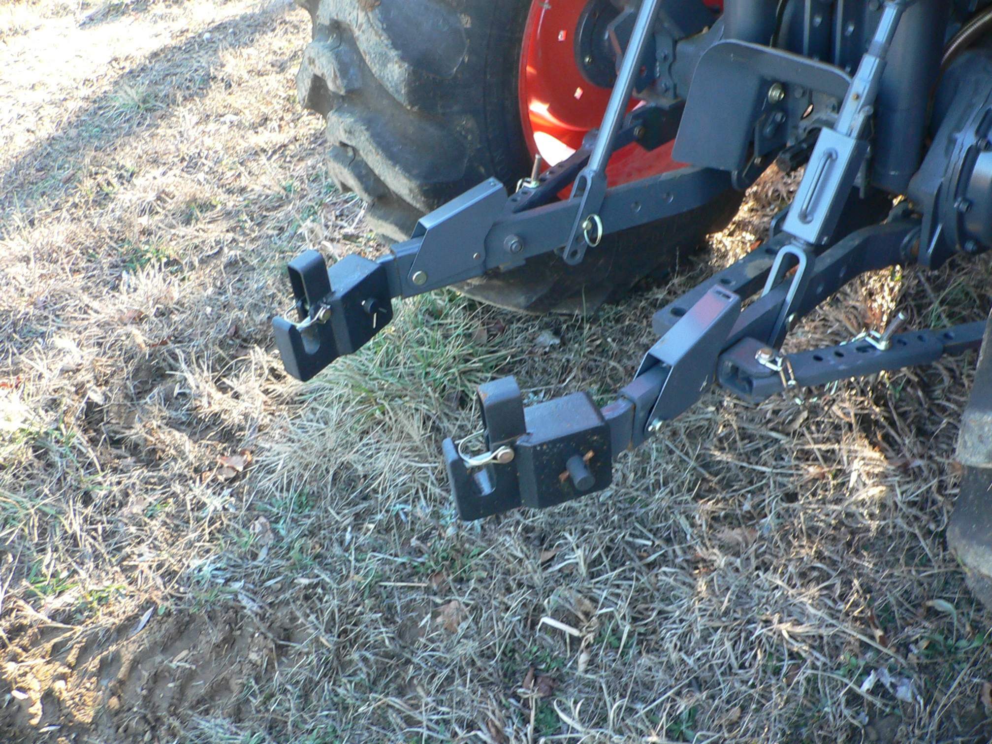

One of my first purchases and with 2 tractors I have bought another cheaper under $100 set off ebay. I feel they are almost required if someone has rear implements that are heavy and used often and you work alone.
