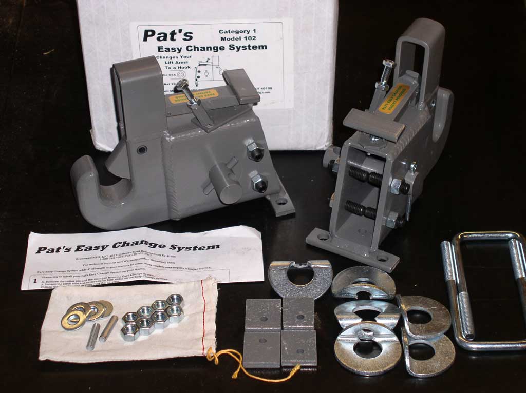

Pat\'s Easy Change System:pics,Instructions,etc.
For informational purposes. Took a pic of the contents before I installed them. Instruction sheet attached as well.

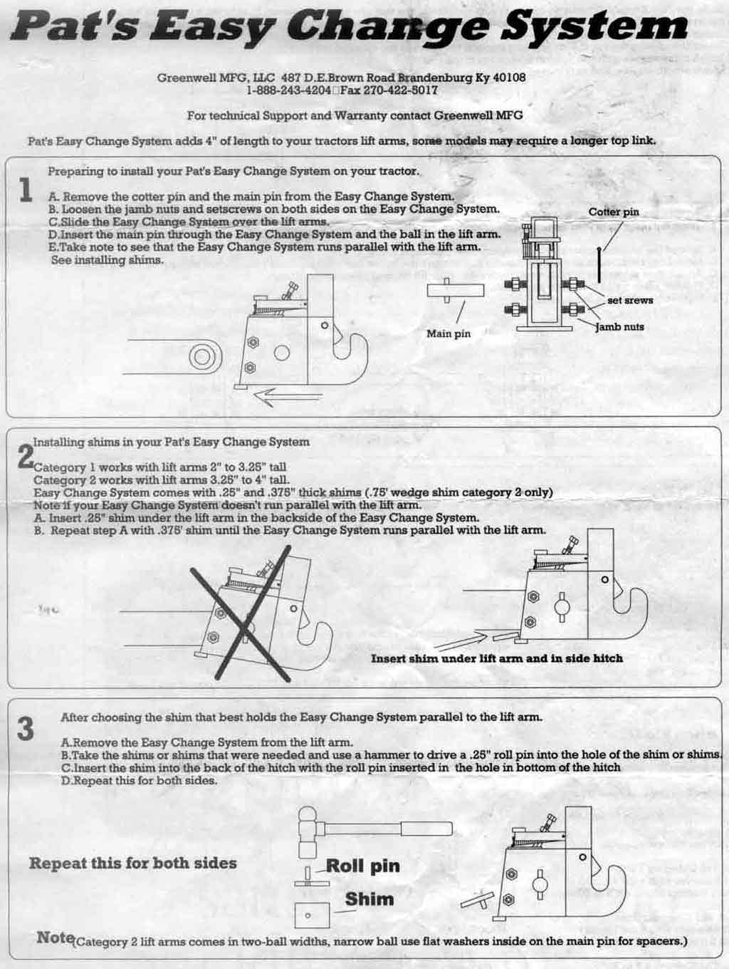

   / Pat's Easy Change System:Pics,Instructions,etc.
#2
Re: Pat\'s Easy Change System:pics,Instructions,etc.

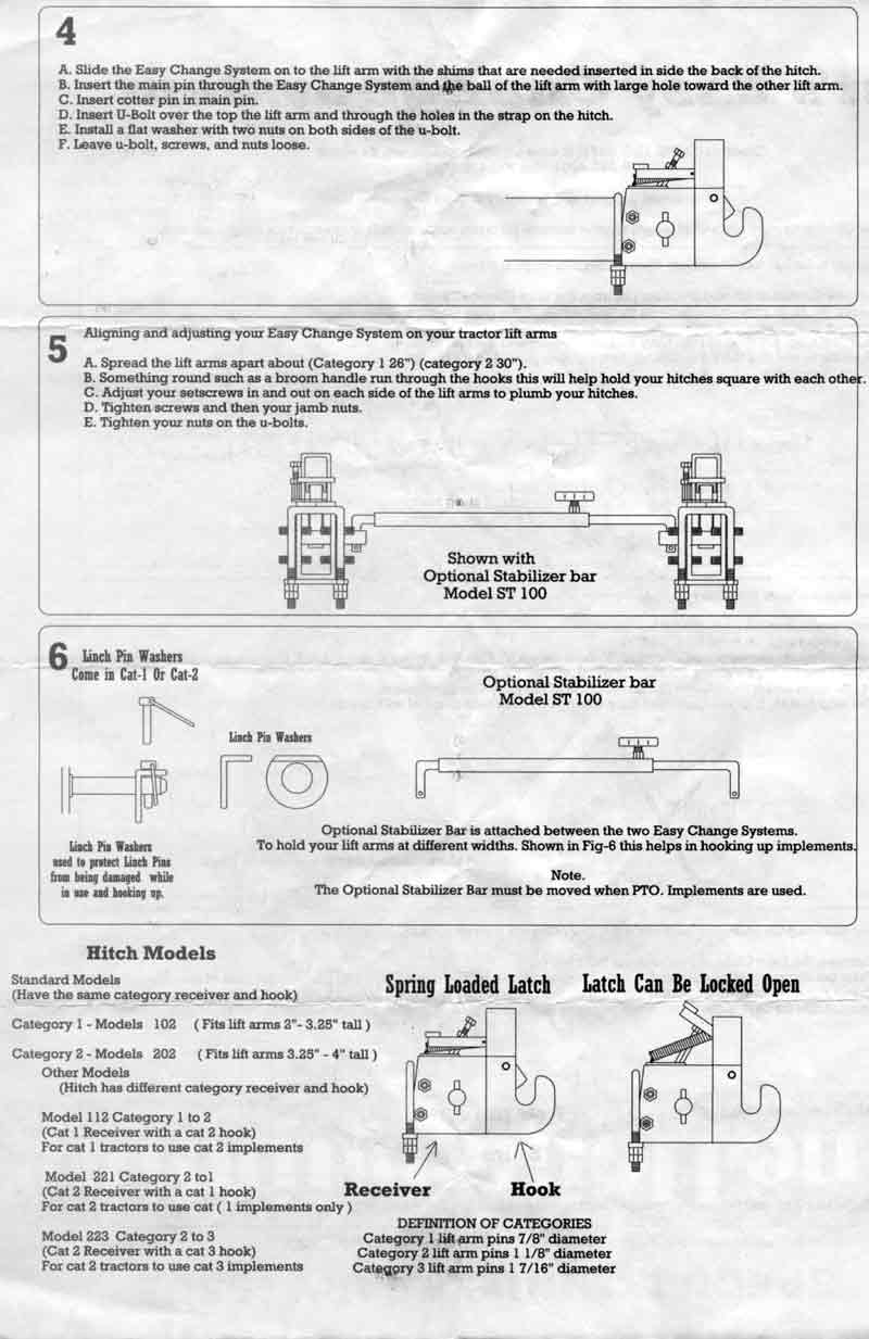

Thank you. I just ordered a PECS and should have it in a few days.
Did you need a longer top link?
   / Pat's Easy Change System:Pics,Instructions,etc. #5
Sorry to butt in here...
</font><font color="blue" class="small">( Did you need a longer top link?)</font>
Actually, I had ordered the Top & Tilt top link hydraulic cylinder which was a few inches longer than the minimum length of my manual top link. When I put Pat's system on, it ended up fitting perfectly. (The manual top link still would have been OK with Pat's, though)
