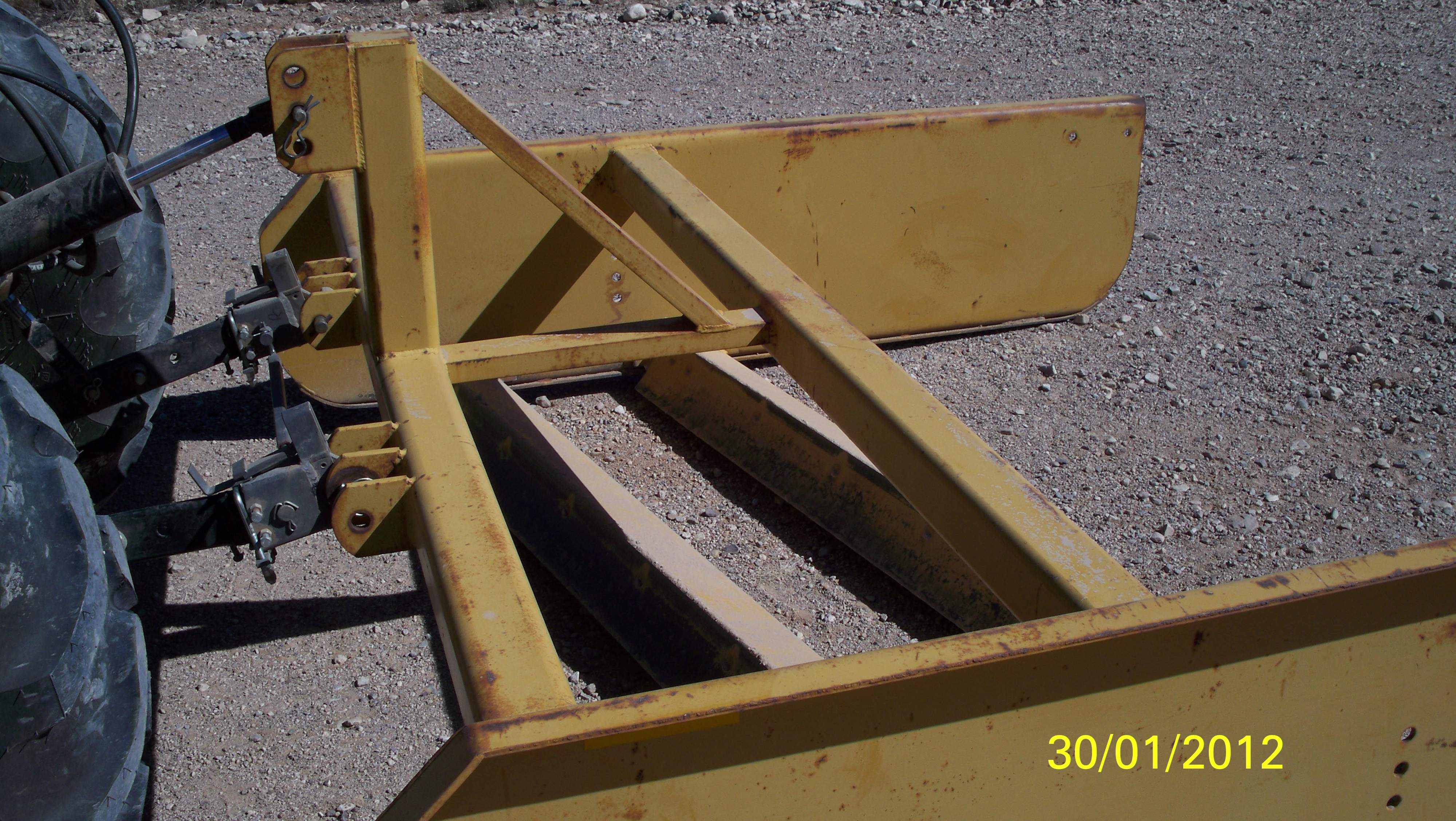

I ordered Pat's Easy Hitch System for my Max 22 yesterday after struggling with my 500# ballast box. Anyone have one installed on their Mahindra? I'd love to see some photos if you do have it.
Here is my PQH on my 5010 hooked up to my grader scraper not a great picture but all I have of the PQH. But the system works and yes use lock-tite on everything.:thumbsup:
Forgot to add GREAT customer service!!!

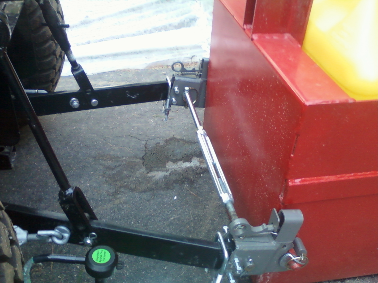

Got Pat's Easy Hitch System today and put it on my tractor in about 30 minutes. Seems well made. Picture attached.
