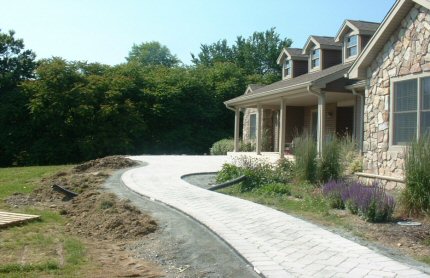

I hate pavers, here is about 1 - 2 thousand of them.
I used about 10 masonary blades, the circular saw was never the same.....
Wear protection! Eyes, Hands and Lungs!!!!!
-Mike Z. /forums/images/graemlins/smile.gif

Nice deck there.
