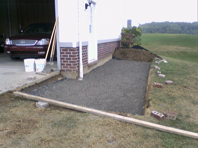

I attempted to dig down to firm soil. At the drive that depth was 6” down. I hit some very rocky dry clay and it was hard digging. Wanted to go at least 8” so that I could get a solid base capable of supporting the tractor. Got to clear the snow off and what do you think I am going to use. Towards the other end I ran into very wet silty clay with large sandstone shale rocks up to 24” wide. I had to go down 12” to get to anything resembling firm.
Compacted the excavation and filled in any areas that were low with 2A modified (crushed 1 ½” minus gravel with the fines). Built this up in 2 ½” lifts compacting each lift with a Stone SFP 3000 20”x24” plate compactor. This puppy is 200# and applies a 3,000# force. The “Base” pic is about the third lift prior to compacting.
I used 8 tons of gravel to bring the area up to the sand level. I was very carefull on the final lift to get the correct height and slope. Each lift compacted approximately ¾”

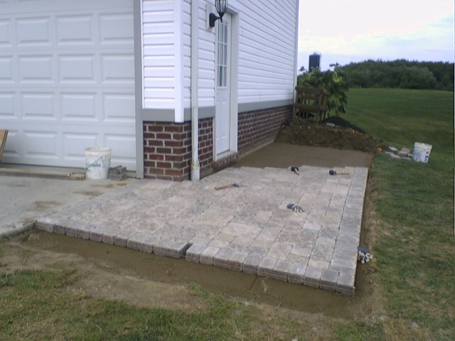

I then screeded a 1 ¼” layer of concrete sand for the setting base using 1” PVC pipe as a guide. Used 1 ½ tons of sand I believe. Finally after 6 days it was time to begin laying the pavers. It only took one day to place the pavers but moving and laying 6,500# of concrete was tiring. The 12x12 blocks weigh 32#. Good thing I had my helpers (pics below). Helper 2 moved most of the small rectangular blocks (7# each) onto the pallet himself.

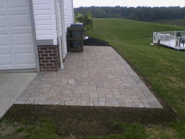

The picture of Helper 1 is after we covered the gravel pile and base with plastic. It rained or drizzled on me almost every day. After the pavers were all laid it was time to cut the pieces that needed cutting. Then installation of the plastic Snap Edge and another run of the compactor over the pavers to set them. After they are set brooming sand over the joints and a final run of the compactor. Then I backfilled around the pavers and mulched the area along the house. Now to plant seed in the grass I tore up in the wet/rain.

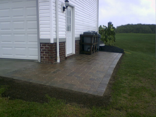

Of course the final picture was taken in the rain. Only fitting since I cursed the weather daily since I either got wet working or was inside looking out at the rain. The area that I paved is approximately 7’ x 22’ covering 150 sq ft.

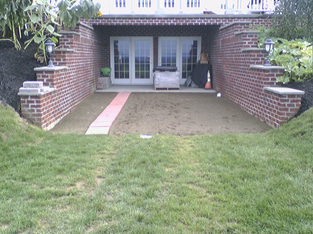

My wife loves the final product. Now I get one more day of rest then it is on to the walkout basement area to start phase 2. That area is approx 15’ wide by 19 feet long (280 sq ft) and is between 2 brick faced retaining walls. That phase needs to be completed prior to knee surgery on the 22nd of the month. Wish me luck.

Nice looking job. I saw a crook in the line of pavers or so I thought until that camera lenses showed the opposite distortion from the other perspective. Should have known it had to be arrow straight ;) You sure are putting a very good base in with great compaction (tight lifts). Those pavers will be where you put them for many years. Most skimp on that and then wonder a few years (or less) later why things are moving. Solid ground, good base, and edge control is the only way to do it.

Yeah, a buddy who came to inspect it (he lays tile for a living) said the same thing until he walked around and sighted down the edge. I even had the string line still in place and he started to point it out. It does not help that I am using a camera phone so that adds some distortion. The area that looks like a crook in the edge is the high point and it drops off towards the near corner. I wanted to match grade in the foreground since it drops off to a 20 degree + slope where I am standing and did not want to increase it. The near corner will not be walked on much but I did not want to get into a curved edge and the associated cuts yet. That will begin in phase 3, next year? I was carefull with the path from the drive to the door. It is evenly sloped from the drive around the corner to the door. The slope to the grass from the door is also mild.
