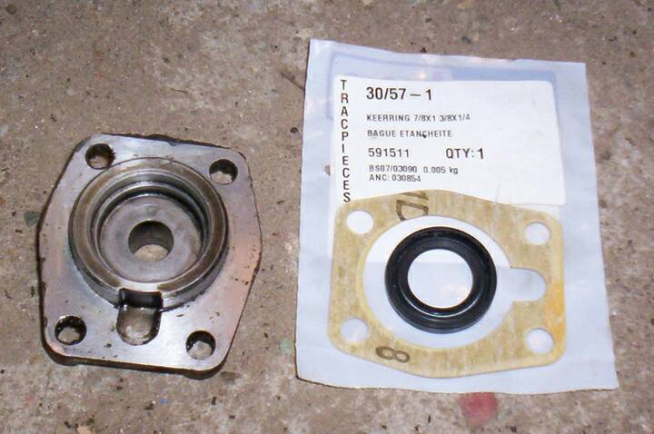

I own 1972 Massey Ferguson 165 Diesel. Have used for 18 years, it developed an oil leak from the small pot metal or aluminum plate on rear of engine, about even with the manual fuel pump.
I was trying to remove plate not knowing it was recessed into rear of engine and broke the corners off before it came off.
I need to identify name of part so I can replace it. The plate has a small factory hole in it which I believe the
oil was coming out. What went wrong in side the engine to allow it to leak is a mystery to me.
I would welcome any help. Thank you

That is your tachometer plate. It should have a little gear in it that a cable can attach to. The cable goes from there to your tachometer in your dashboard. Also known as a rev counter in other parts of the world.

Never mind. I think this is what he's talking about. Perkins ad4.203 tach drive gasket. The picture is from another forum. It's not in English either, so I don't know what the bag says.
735050m1 is the tachometer drive housing part number.
731051m1 is the tachometer gasket
636762m1 is the block to housing seal 7/8" x 1&3/4" x 1/4"
