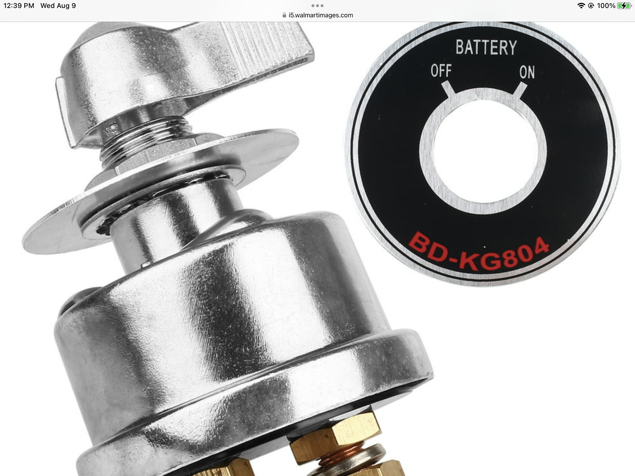

Does your RTV-X1140 have a winch? If so, does the winch have a wireless remote control? If the answer is yes, my bet is that is what is draining your battery. The winch is usually wired directly to the battery, and the radio receiver for the wireless remote is usually connected to the winch. In this case, the receiver is on continuously, even if the UTV is switched off. You can add a bettery diconnect switch, and remember to turn it off when the UTV will not be used. As an alternative, if you can find the power wire to the radio receiver on the winch, you can put a switch in that lead and leave it turned off except when you are using the winch remote control.
