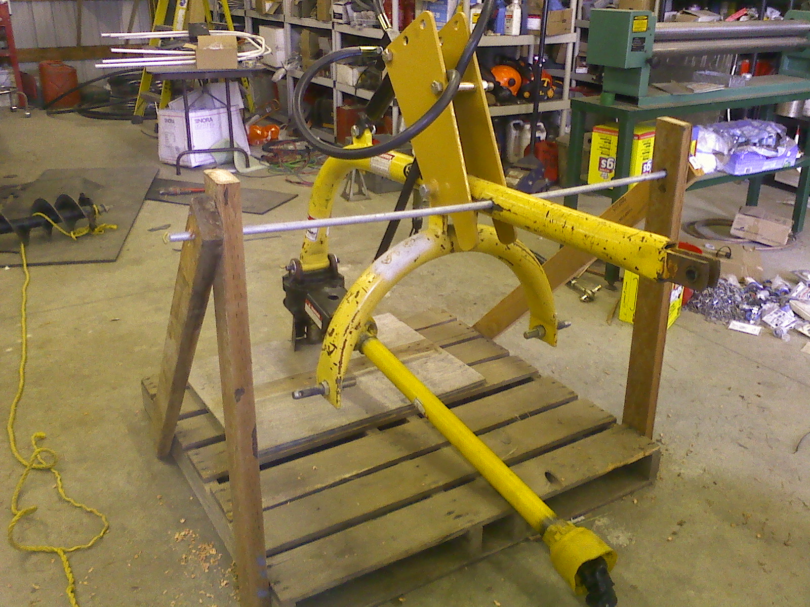

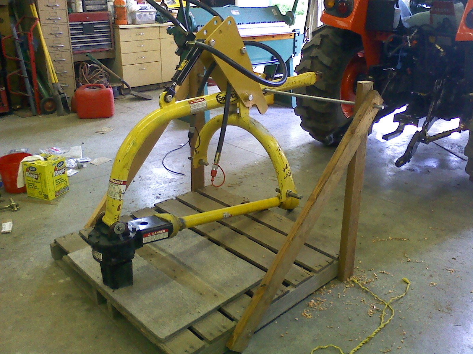

I needed to be able to move mine with my pallet forks to store it, so i made a 10 minute storage platform with an old pallet, 4 2x4's and an old ground rod. It works great, can attach it in a few minutes. I have to remove the auger though, but that only takes a few minutes also, and then i am sure that the bolts are tight before operation.

I just take mine apart and lean the parts up in a corner of the shop. Doesn't take that long.

I bought a 2000 lb chain hoist from amazon and used it to remove the PHD. It made a huge difference and it will make putting it back on very easy. I used a tow strap wrapped around a beam so I need to find a better way to install the hoist. I might be able to use the PHD after all!
