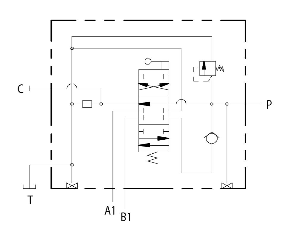

2.) Determine which Spool Valve to use. I've selected a 1 spool, 8 gpm, Prince MB11B5C1 (Surplus Center) that comes set up for open center hydraulics and bi-directional flow, for that all important reverse auger rotation. The integral relief valve comes preset at 2000 psi. Will there be a problem with overpressure of the components from this valve back to the tractor pump? Or will the tractor 1900 psi relief open first? Would a hydraulics expert select this valve for this application, or is there one better suited?
3.) How to plumb the system hydraulics? Looking at the Prince MB11B5C1 schematic, I can see that I connect the tractor pump supply hose to port "P"? I would not install the high pressure carryover plug because I want the open center hydraulics to work, and I don't need power beyond. I also see that I would connect the tractor pump return line to port "C"? Ports A1 and B1 would be connected to the Dynamic hydraulic motor ports. Now the tough question Should I connect the tractor direct return to sump hose to port "T"? I don't know enough about tractor hydraulics, so I'm again looking for an expert's opinion before I go off and do something stupid and regrettable.

You should mount the new valve as a remote and feed it from the PB from the FEL, or if one of the hoses to the back is PB fluid then that goes to the IN port of the new valve.
The return/tank port from the valve should go to tank, and the PB adapted port of the remote should go to the 3pt, so you will have lift.

So, it sounds like the "pump supply" hose feeds the remote valve. The "pump return" hose must be connected to the return side of the valve to operate the 3 pt hitch, and the "direct return to sump" hose must be connected to the return side of the valve too. Please correct me if I'm wrong.

I've attached a schematic of the Prince valve. I assume P=PB supply, C=PB return, and T=direct return to tank.

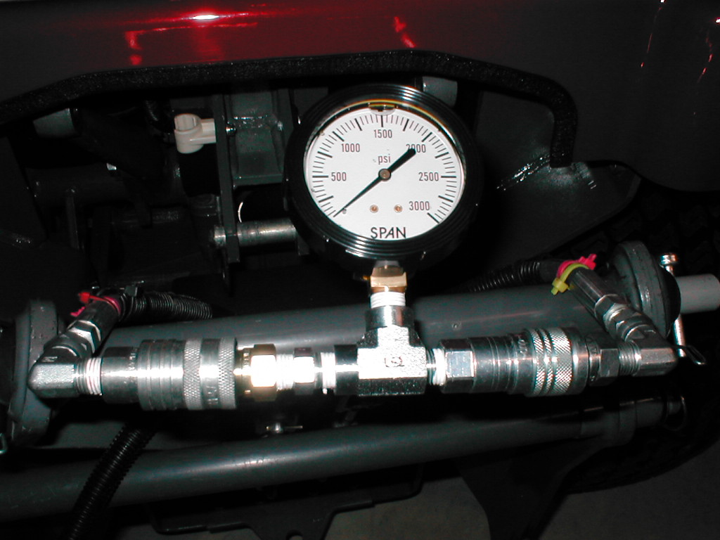

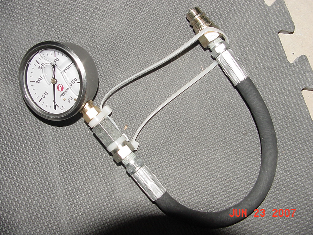

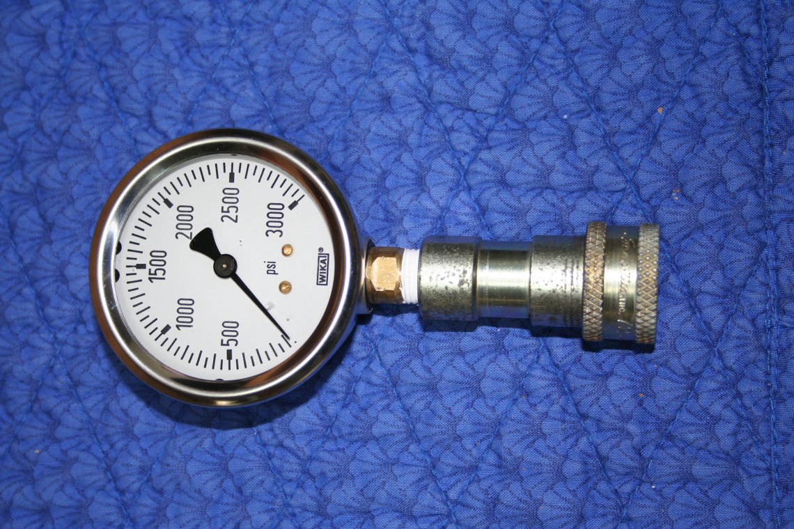

Here is an example of two 3000 psi hyd test set. Just match up QD's for your QD's. They are liquid filled.
You could also mount a hyd gage in a tee going into the FEL IN port, and use it to monitor your hyd system.
These test sets were made by some of our TBN members.

Hi JJ. A gauge will certainly help me determine actual hydraulic pressure at the rear remote hoses. It would also be useful for trouble shooting. I favor a tee setup. I'll see what I can pickup locally. I have a couple QD bodys, all I need is a QD stem, 1/4 Tee, and a liquid filled gauge - I'm thinking 0-3000 psi. I'll post back when I find out what the rear remote pressure is.

Got the remaining hydraulic test gauge parts today, and tried it this evening by installing it between the backhoe rear remote QCs. No pressure until I raised the 3pt and caused it to dead head, at which point it read 1800 psi, and sounded like the relief opened.
I asked AGCO Answers for a pump flow/pressure curve, and they referred me to the dealer. My dealer suggested a flow test at the rear remotes so the PHD hydraulic motor could be properly sized, and warned that improper motor size could cause the fluid to heat up and damage the tractor.
Could someone please explain this to me? I understand that when you compress a fluid, you add heat. I'd expect fluid coming from the pump to be warm, but as the fluid leaves the motor, I'd expect it to loose some heat through expansion, however minimal. I'm not a hydraulics expert, and would sincerely like to understand this.
Thanks,
Dave K.
Here's a pic of my test gauge setup.

Hydraulic oil is not very compressible. Especially at only 1800 PSI. You'll have way less than 1% compression of the fluid.
Very little heat is generated by the pump. The hydraulic motor will heat the system more. Hydraulic motors have efficiency percentages. As a general rule for geroler or duroler motors, use 75%-80%. Spur gear motors will be a little more efficient, around 85%-90%. I'm assuming you have a geroler or duroler motor.
So, if you're providing 4.3 GPM at 1800 PSI to the motor, you are theoretically sending 4.5 horsepower to the motor. You lose the approximately 20% at the motor. That energy is turned into heat (0.9 horsepower of heat generation).
Heat is also generated by restrictions in the system (couplers, hoses, adapters). All of these components have what is referred to as "pressure drop." Pressure drop creates heat as well.
I hope this helps!
