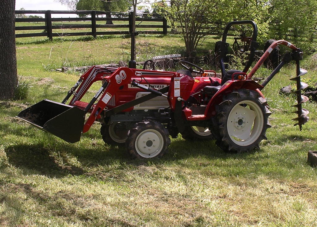

I recently acquired a YM1810D from Fredericks (thru Best Used Tractors) in Alabama. Seems to be a great little machine. A PHD I used on my old Kubota L185DT doesn't seem to fit the Yanmar. On the Kubota, the PHD auger could be raised at least 12" off the ground. With the Yanmar lift all the way up, the auger likes about 2" getting off the ground. I'm considering reworking the lift arms by drilling new holes for the side links closer to the pivot points to gain additional lifting height. I've already had to re-drill the lift arms to accommodate the stay chains that came on the tractor. Comments please.

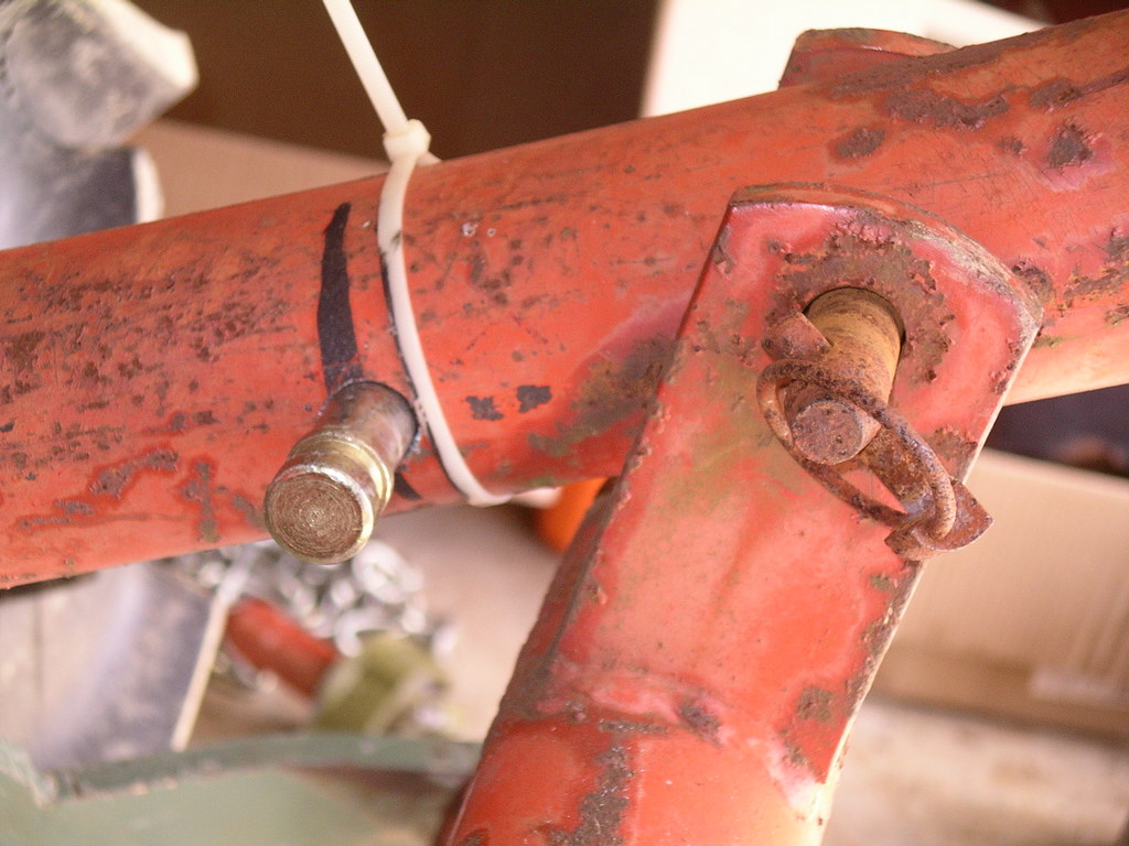

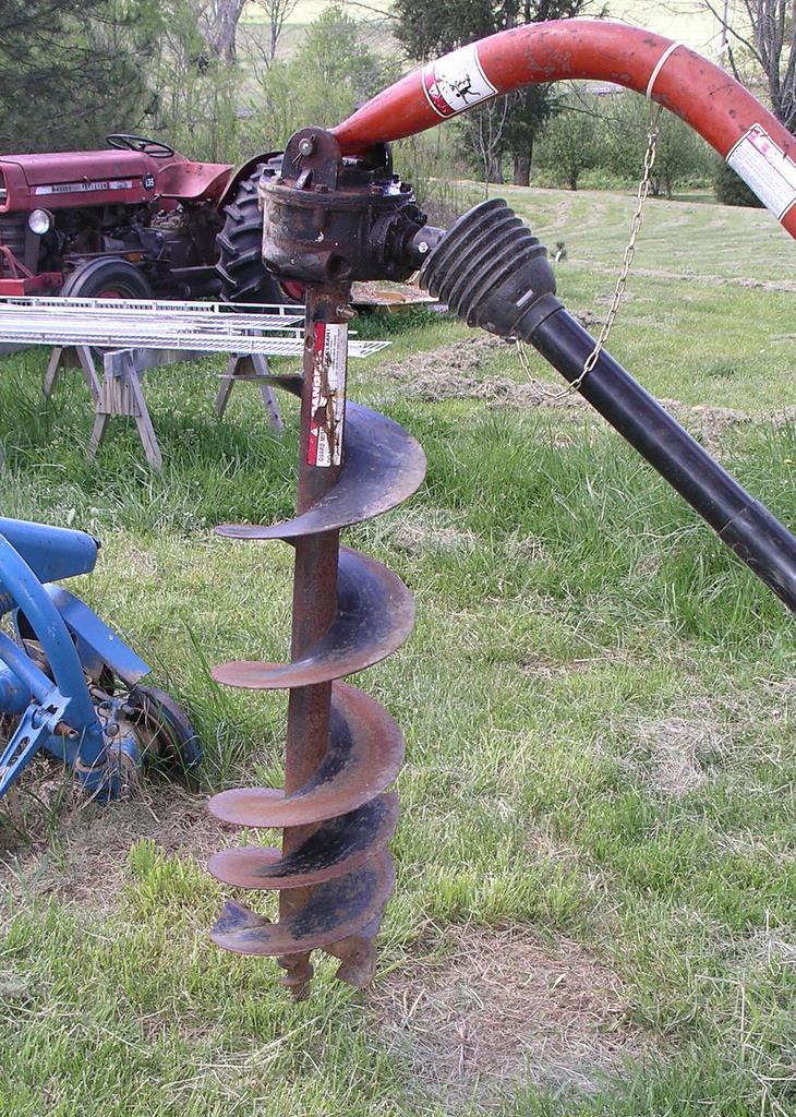

OK. Thanks for all the ideas. The attached pictures show the fix. Drilled a 3/4" hole about 4" forward of the existing mounting point and relocated the hitch yoke. This raised the point of the auger plenty. The plastic tie strap worked as a square to assure the 3/4" hole aligned side to side. See the black line.

The zip-tie square is clever. Nice job, I'm glad you fixed it.
