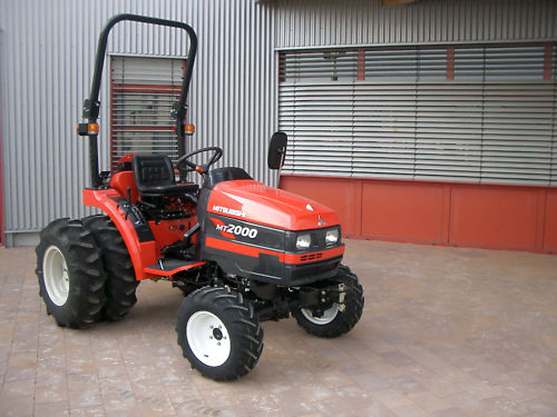

What do you guys do in the fall when living in an area with lots of rain and soggy soil? Has anybody tried double rear tires? The X-series has 26X12-12 tires. How about mounting 2 tires 26X9-12, which would give me 18 inches of width on either side. Or Keep the 26X12-12 and add another 26X8-12 which would give me 20 inches of width on each side? Could this work? Will this be added load/stress to the K92 axles? Will this extreme width tear up the lawn when turning?

I looked again at my X495: I think the dually idea will not work as there is not much space between the wheels and caster wheels of the 62C deck. There is no room for dual wheels. If they exist, 26X15-12 would probably be a good compromise, but I have no idea if wider tires as 26X12-12 do exist. Any suggestions appreciated....

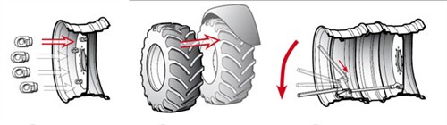

Here is the easiest way to mount dual on a tractor, make a ring between the rims and use threade rod with a hook and eye bolts on the tractor rim.
It will not stress the axles noteworthy on such a light tractor
