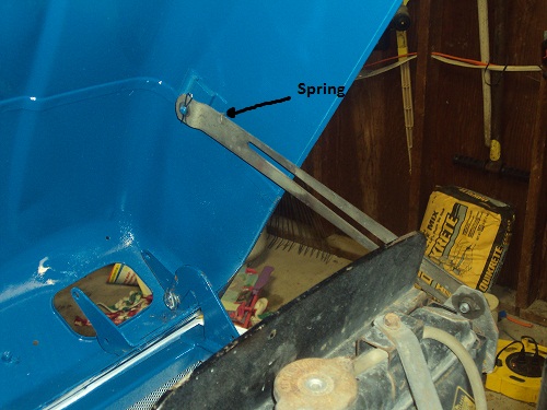

Hmmmm.... Mine doesn't reall match any that I can see from a bracket perspective. Looks like I have a bit of "engineering" to do to see how things go together.
The current implementation is rubbing all of the paint off of the hydr resevior for the power steering.
I should have taken some pics before I took it apart.
Audo

Audo,
on the first pic and looking at the spring and can't see how it functions unless the spring is long enough and hooks on the bracket behind the screen. you see a round hole in the sheet metal where the pivot support is doing nothing. As far as rubbing paint, I think you can turn the slotted flat metal rod 180 CCW so then only the pivot point can rub and not the rest of the bracket. It might have been the opposite way from the get go. it should not be difficult to reverse as you have removable pin there. I would not worry too much about the spring.
JC,
memory is short but pics stay for ever.

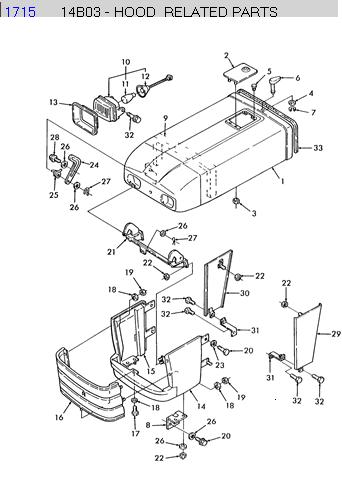

My 1500 looks just like JC's 1700. Partspring.com is another good source for diagrams. The hood and related parts are on page 9 once you select the 1715 model.
There appear to be some differences, but the main mounting system looks similar. It should show you how things go together, but I did not see any spring.

Here is a parts piture of the hood and related assembly for a 1715, hope it helps.
Garrett

   / Pics for Ford Compact Tractor Hood Support System #9
I have a 1991 1520 that I think has a similar hood support setup. Here are some pics of the spring and sliding support bar.
Ed
BINGO!!! This place is the greatest!!!!!
Thanks so much this si exactly what I needed.
I'll compare notes and get'r right.
Thanks again
Audo
