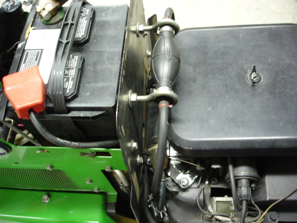

Battery disconnect: My 318 is stored in a garage with my truck and all my stuff, so I didn't want to take a chance of something happening unexpectedly to the electric system. It only takes a couple of seconds to raise the hood and spin the disconnect loose a couple of rounds.
Primer bulb: The tractor sits for weeks or months at a time during winter months, and to prevent grinding on the starter to fill up the carburetor bowl that first time, My brother, who I bought the tractor from, installed a primer bulb for a boat gas tank. It works great. When starting for the first time, I just turn on the fuel and squeeze the bulb a couple of times to fill the carb, then it starts right up.

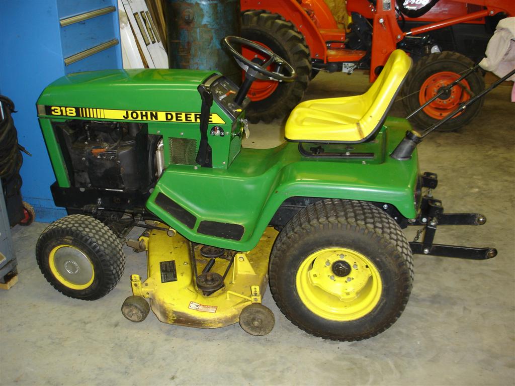

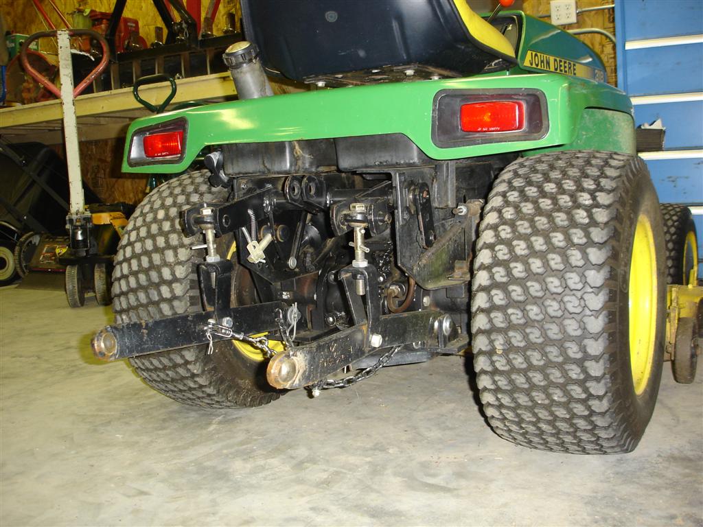

3 point hitch: Found this right after I bought the tractor. It was at the local JD dealership. Looked like it had been there for a while. Got it for $400. Best thing I ever did for the tractor. I found a cat. 0 scrape blade, then a couple years later, a box blade. I have a set of lug tires mounted on spare rims I put on when maintaining the road. With me on it, it doesn't need rear ballast (although there has been the occasional rare-up where the front could have used some).

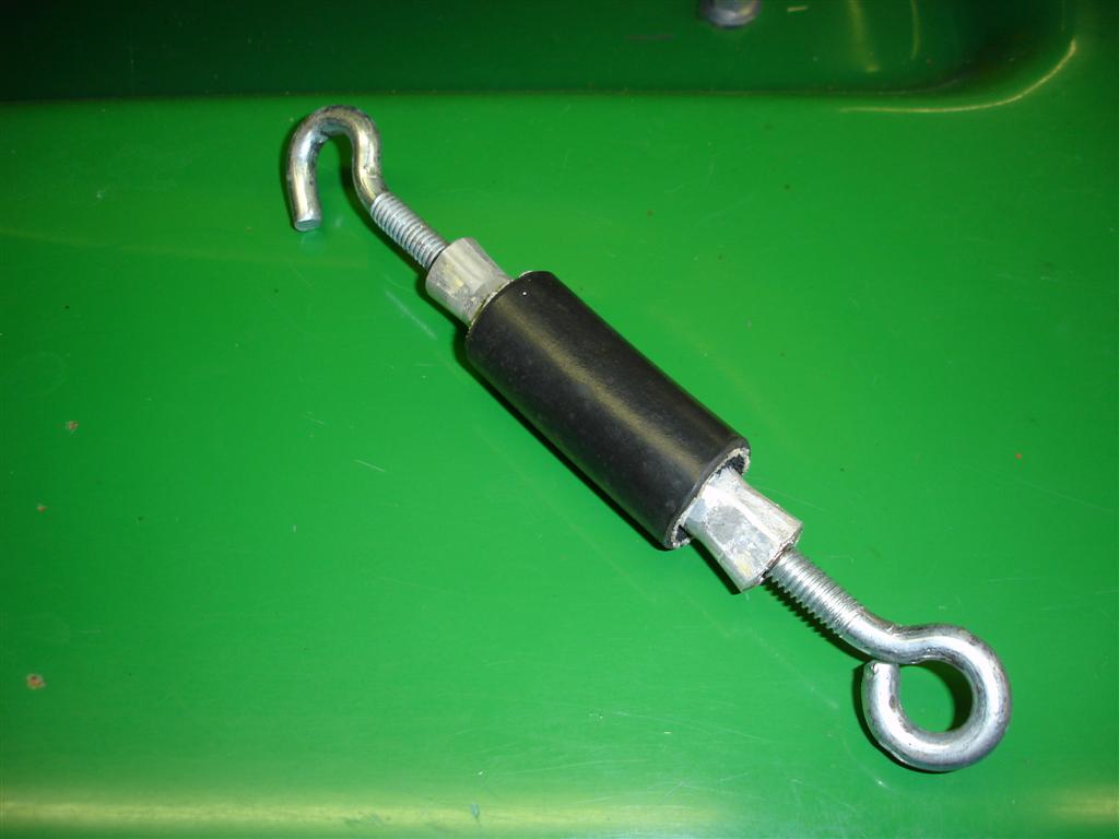

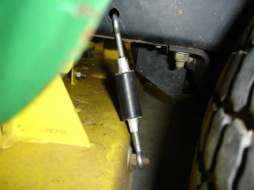

Mower deck hangers: Only took a couple of times of dragging the deck out and pushing it back in when converting from mowing to road maintenance to think there must be a better way. These hangers are my better way. When I want to use the 3ph. I raise the deck and install one of these on each side. The bolts in the deck and holes in the frame are already there, so this was simply a matter of buying two turnbuckles, one with hooks and one with eyes, then swapping one hook with one eye. After adjusting so they slipped on when the deck is lifted by hand a quarter inch or so, I beat them flat with a hammer to lock them, and slipped a piece of hose on them so my big ol' fingers can get a good grip on them. With the hangers in place, the 3ph can be used while the mower stays up, out of the way.

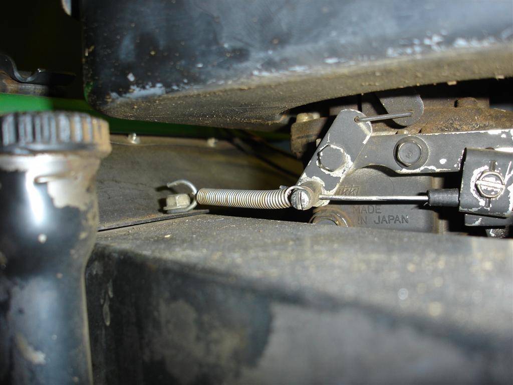

Choke return spring: If you've ever mowed half the yard before discovering the choke is still half way out, install a choke return spring. You have to hold the choke out a few seconds when cold, but it's worth it to me to not worry about fouling plugs or washing the cylinder walls.

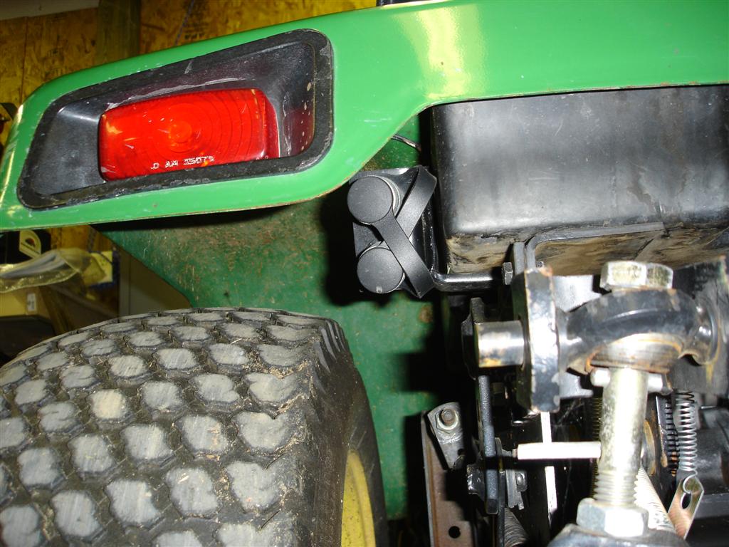

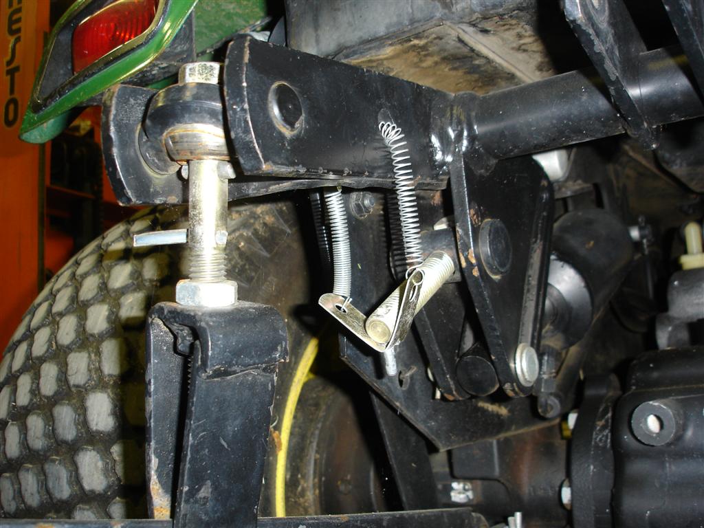

Lift setting keeper: There is no lock nut on the hydraulic lift adjustment. I kept a small vise grip clamped on the adjusting screw for years, but it was still aggravating to unclamp it every time when switching from road work to mowing. I came up with this piece of strapping and a spring to keep the adjusting screw from turning while mowing. When setting up for road work, flip the lock off and turn the screw out 10 rounds, when mowing, turn it back in 10 rounds and pop the lock back on.
