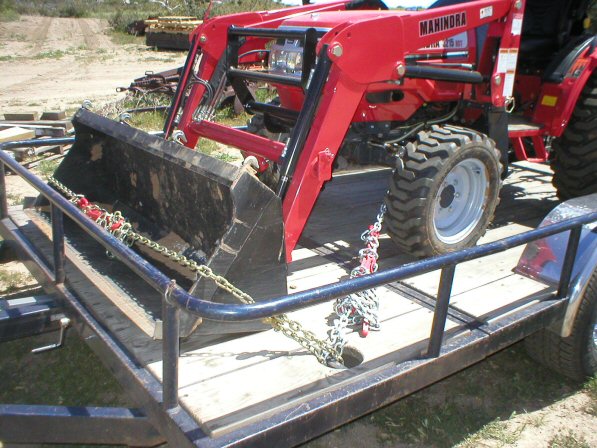

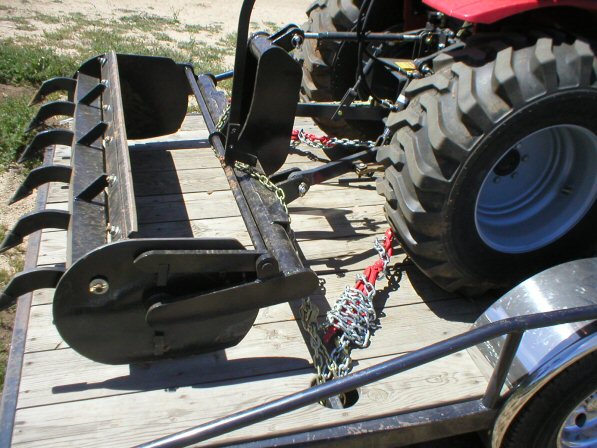

Tinman955, you asked for some pics and have not gotten very many.:( Here are some of my 3215 Mahindra, 5/16" chain on the loader and the Gannon, 3/8" on the tractor. Back chains are crossed left to right and right to left. That just works out well for me. With a machine as light as the 3215, here in Calif. that is over kill, only require the four on the tractor, but as has been said before, we don't want any problems if there ever is an accident, and all of our other equipment is a lot heaver and requires the 6 chains. I think that with a back hoe, the bucket is suppose to be on the trailer deck and secured, as is the loader bucket.
Anyway here are a few pics of my rig.

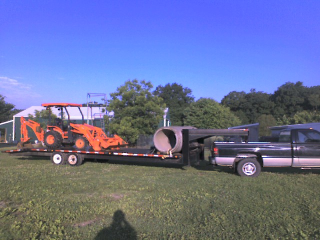

I use a grade 70 3/8 chain and 2 binders threw the tie down point on the front of the tractor and the back hoe and strap the bucket down. Then clamp the extra buckets in the 4n1 bucket.
The pipe I used 1 grade 70 3/8 chain in over the pipe hooked to the winch per regulations @ the pipe manufacture. I did put a 3" strap threw the pipe but the foreman told me that was over kill on the the pipe as all DOT requires is the chain and winch. Not saying I am perfect but I have been inspected and never had any issues and been ridiculed by many friends that I spent to much time tie things down.
I always try to picture it hanging up side down and if I feel it would stay in the same place on its side or upside down I did a good job securing it to a trailer.
