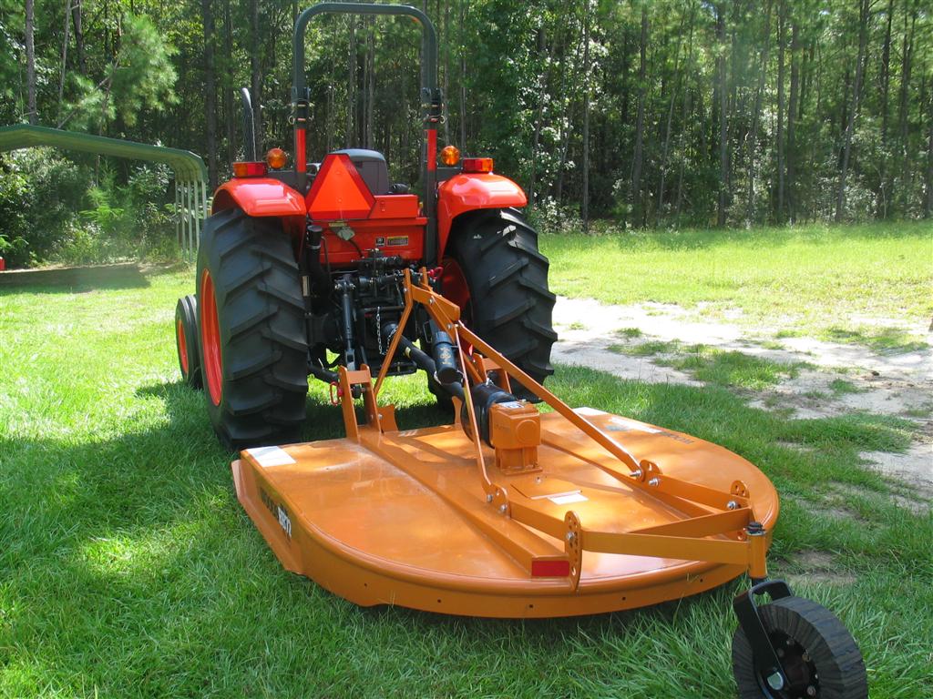

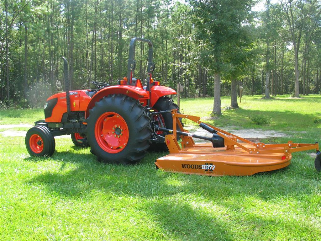

I took it out and cut about 5 acres of Bahia today!
It cut the knee high Bahia like a Hot Knife through butter! Didn't even know the cutter was back there! Spent about half the time in 3 low and the rest in 4 low.
It was nice to only have to run at 2160 engine RPM's to get 540 at the PTO.
Eddie,
The front of the cutter has a rubber shield on it, I removed the metal band from the rear of the cutter to get the Bahia to discharge better.
The tractor has 4, 103lb Kubota weights along with the front weight bracket, which weights about 200lbs.

When I test drove the tractor the dealer didn't think I would need the front end weights....but.....knowing the type of land that I have to use the rotary cutter on I opted for the addition of the weights.
This part of Florida is very hilly, and there some banked areas that I use the cutter on that I felt I wanted the weight for.
I have used a MF-135 with a Brown 460 cutter in the same areas and the front end did get a little loose in some of the areas.
I figuered that the additional front weights of around 500-600 lbs was light compared to what the loader would weigh if I had one installed.
Bob,
Having put about 11 hours of bush hogging time in I have been pleased with the fuel consumption.... looks like around 1.5 gal an hour at just under 2200 RPM..... I suspect that over time, after the engine gets broke in this fuel rate will likely get a little bit better. I am very pleased with how quiet the engine operates when compared to running my B7510 at 2600 RPM for cutting.
Overall I am very pleased with the M5040 and how well it handles, operates, and rides. I could have opted for the 84" cutter but for my use and Bahia grass, the 72" just breezes through it!
