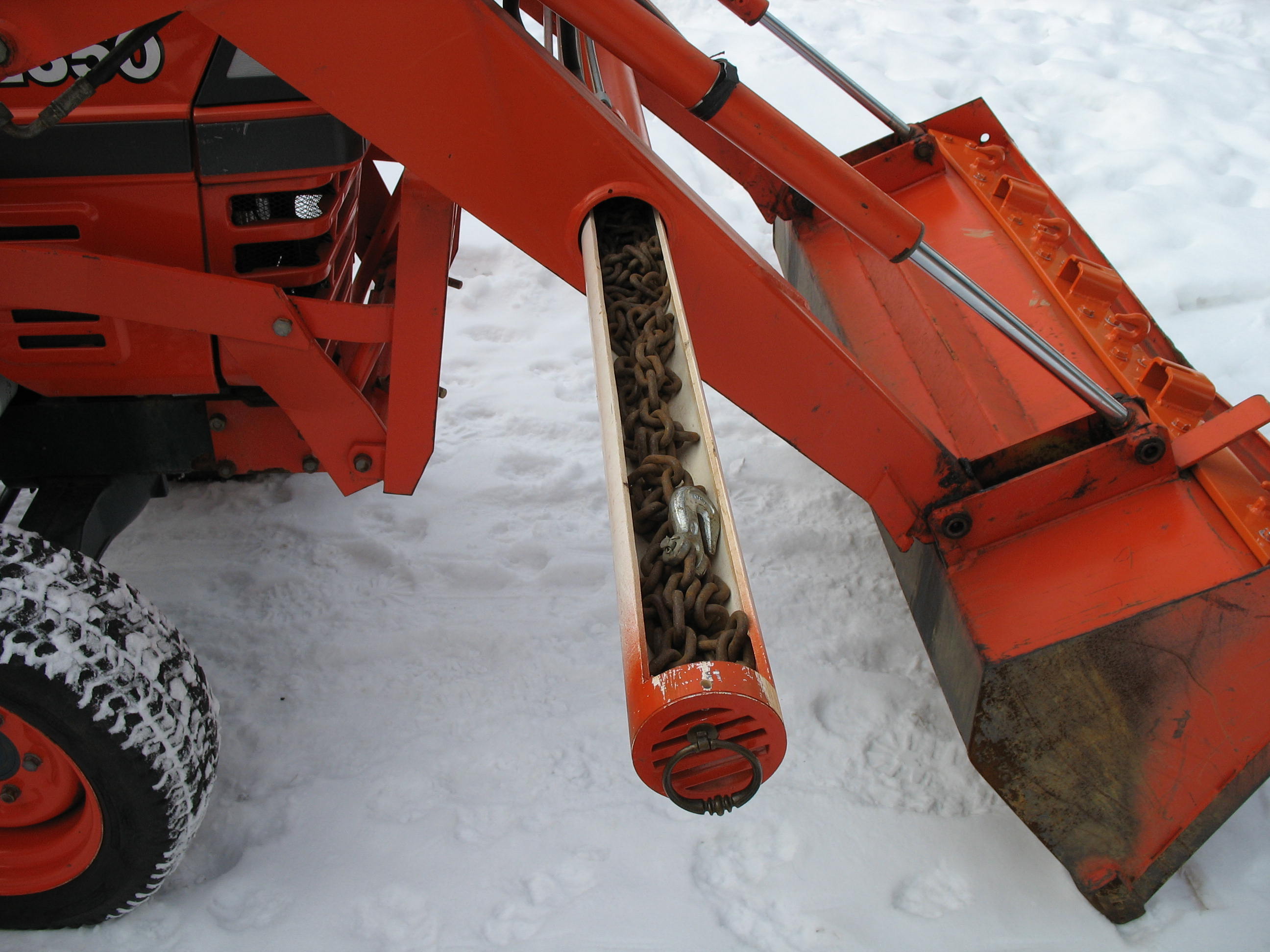

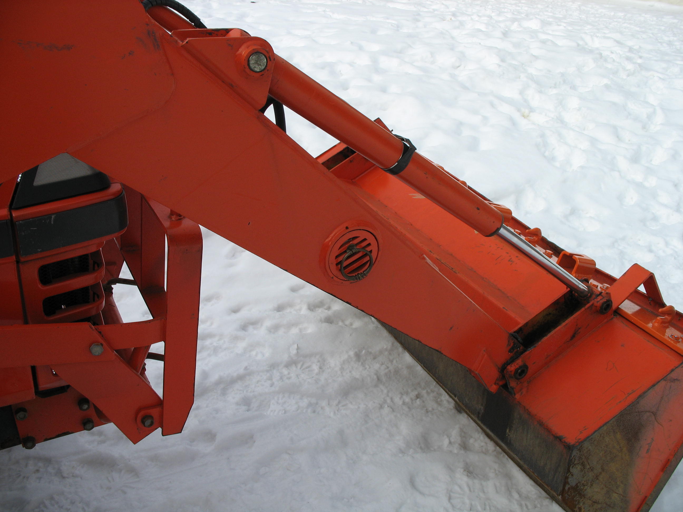

I brewed-up this idea and it works great..3.5" PVC w/ end-cap, jigsaw, old brass dresser-drawer handles and some kubota paint. Drop in a nail from each end to keep it in place, but to tell you the truth, I never use them. The thing has never shifted during operation.

My (Kubota) hat is off to you. And you say it doesn't shift. My compliment to you is to use your tubular drawer idea. Excellent!

I noticed those devices welded to your FEL. Are those to slip chain links into for lifting etc?

My hat (John Deere) is off to you also! Great idea! :)

I have seen peopel put chain there before, however the drawer idea is great! That would eliminate the need to stuff the chain back into the hole.

Great idea and I like what you did to the top of your bucket.

Slicker than snot on a glass doorknob. Kudos.

Very neat idea. I bet we'll be seeing a lot more of those now. Good job.
