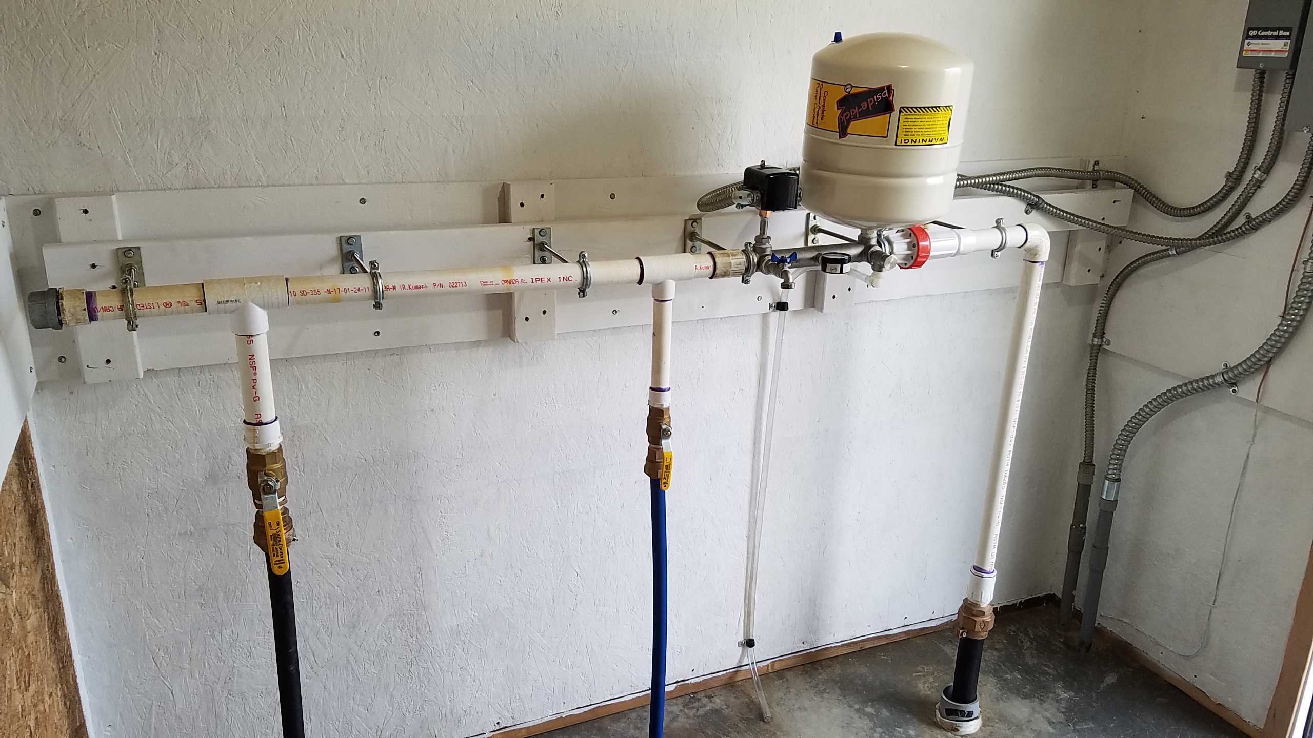

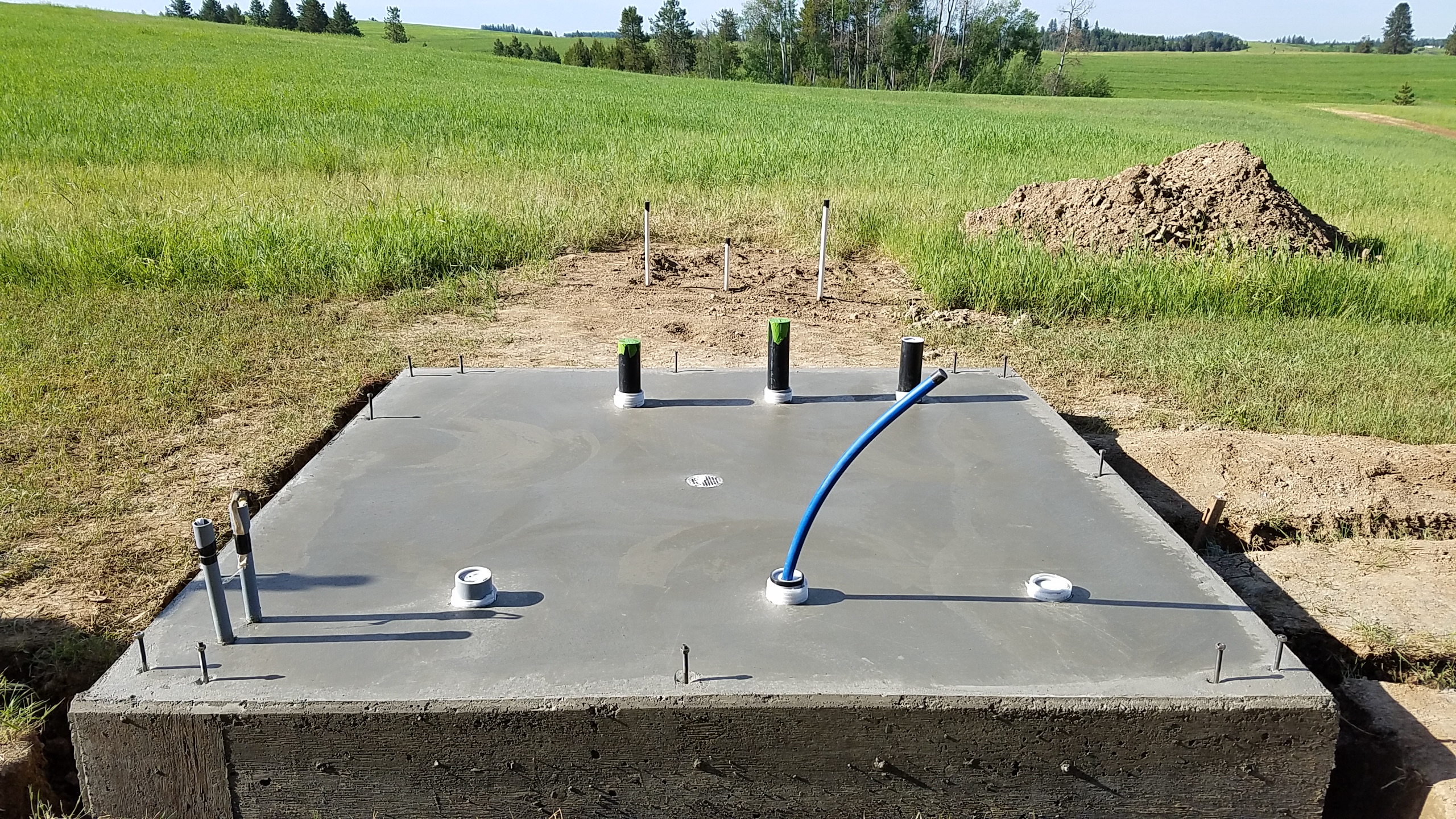

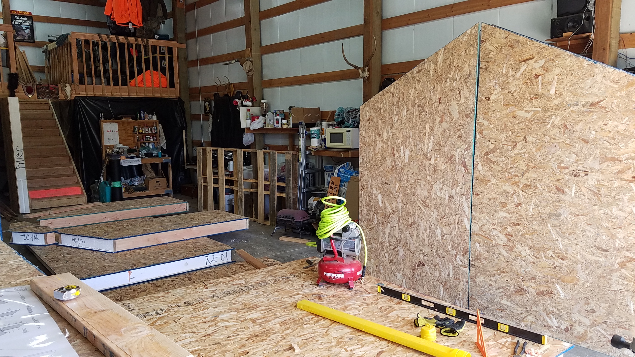

Built a 9'x9' SIP heated pump house with center floor drain and six stub outs as seen on the concrete platform. Currently three stub outs are used with three remaining for future shop, home and yard irrigation. All plumbing and electrical are 4' from floor level for ease of access and maintenance. NO back bending work needed in here ever. SIP panel walls and roof are 6".
Idaho2
Nice. Everything gets working on. Plus having to install.

The foundation image is for my pump house. Built this in July of 2017. Took one day to set up the SIP building.
