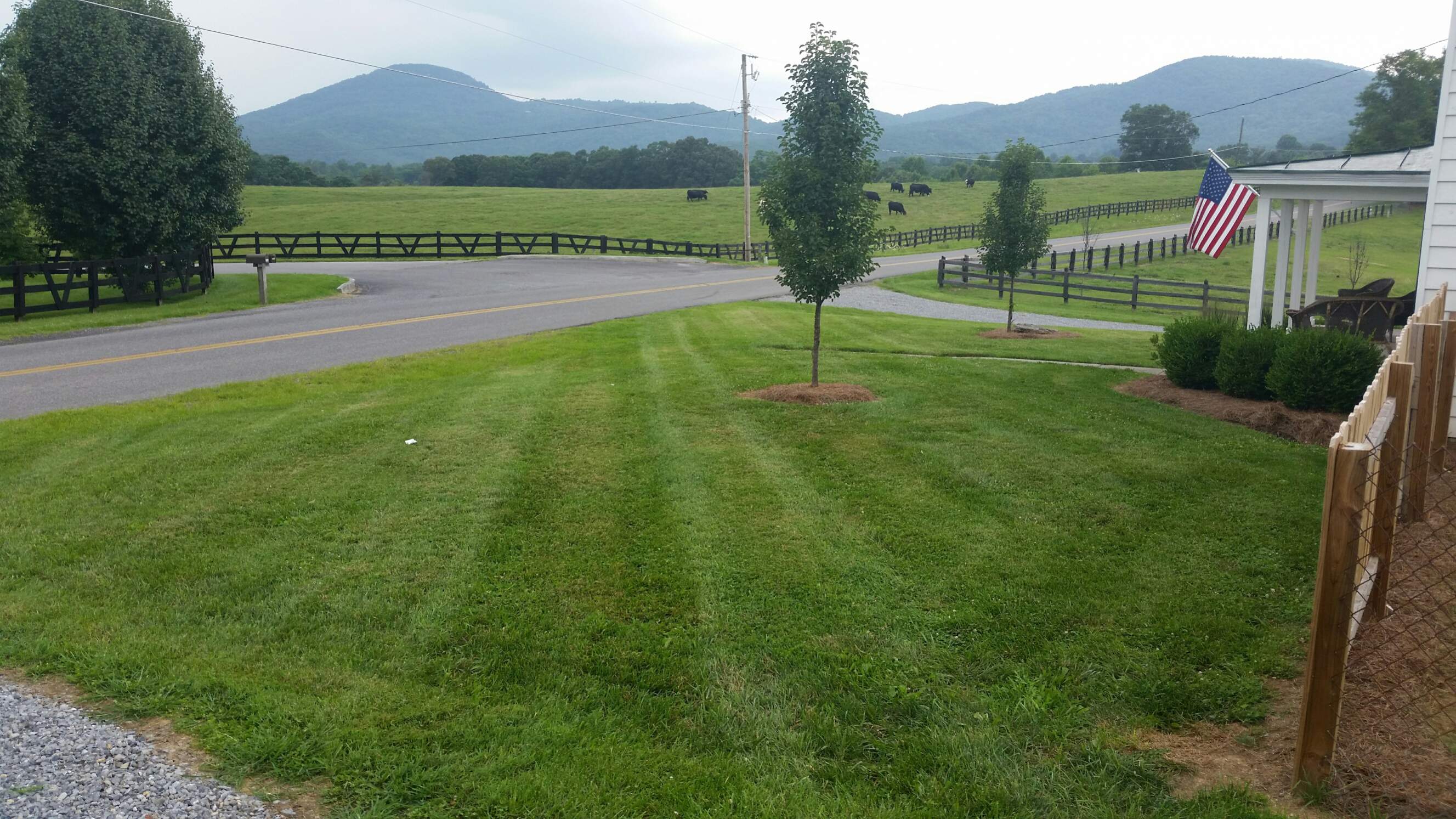

First picture is the results of the MMM using a 4" cutting height. Obviously it stripes better, the MMM also trims better and is easier to maneuver and run. It is not a floating deck, so I do have a problem on my rougher property and yard with the mower scalping and dipping into holes and leaving uncut grass. Biggest problem by far is the fact that the front tires crush the grass down before it gets to the MMM, and leaves some standing grass afterwards. Nothing major, but enough to bother me.

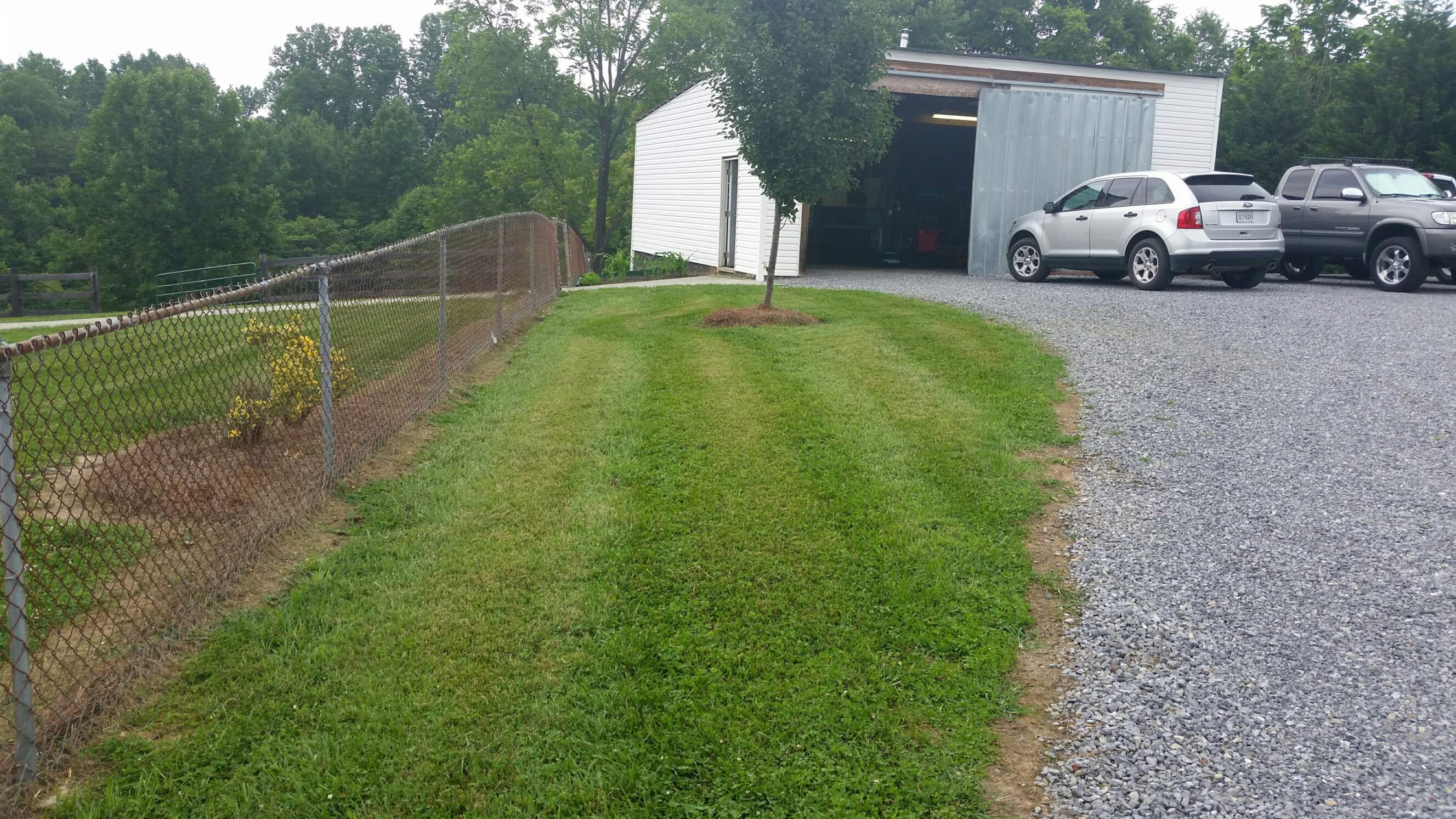

Second picture is what I was cutting with my pasture. This mower and tractor had no problem cutting and discharging grass from a pasture that has not been cut all year, some grass was waist high.

Not a fair comparison of mmm to rfm, IMHO. Rear discharge vs. side and 60" vs. 48". For the lawns you are showing, my FDR2584 84" Woods mower would work behind your tractor in short grass. The only downside to my RFM is not being able to hook up my grass vac trailer. My 72" side discharge commercial deck on a front mower does it all. A rear discharge does not produce the side windrow that often accompanies a lawn job done when you've skipped more than a few days between mowings. In my case, the only advantage of a mmm is that your neighbor is probably noy going to ask to borrow it to mow his stone filled backyard.

Perhaps not a fair comparison, however I was not going to go out and buy a 60" side discharge RFM for the sake of a review on the internet. This was meant as a simple comparison between the 2 "styles" of mowers.
