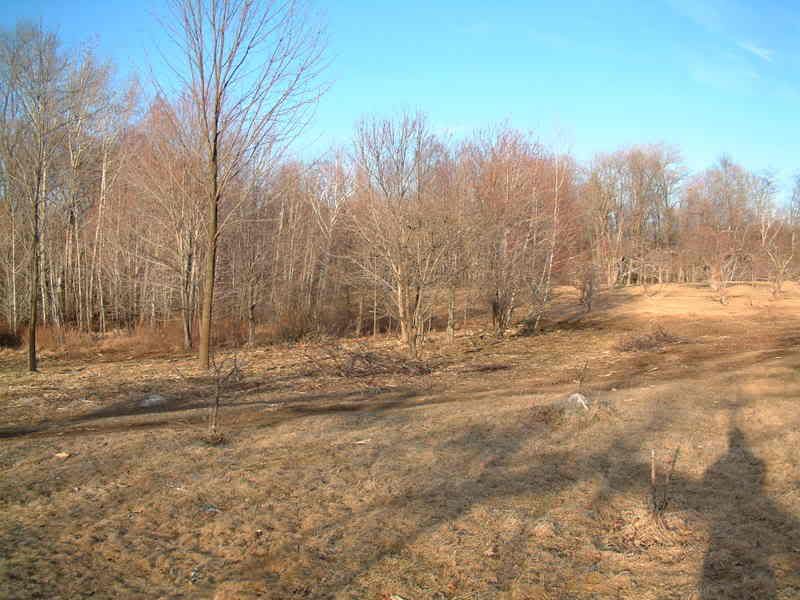

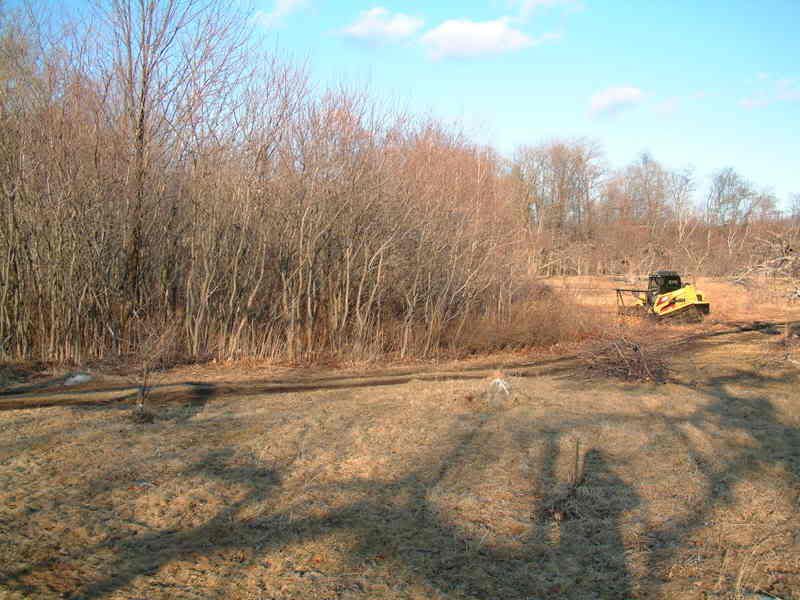

The first few jobs I rented a Bradco Magnum. These are pictures from the orchard I pruned and then mulched the branches and did some clean up around the edges.
Some before and after pics, actually during as I wasn't finished.

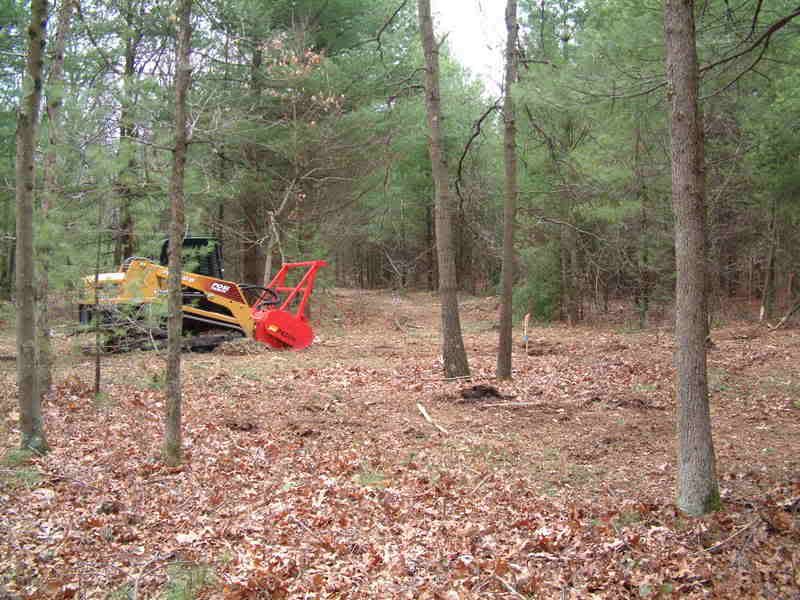

The is the first part of a road and 10 building lots I have started this week. This is a few towns over from where I live and it has totally different
trees and no rocks like near my house.
I blew one hydraulic line for the quick attach system, after this job I will be fabricating some guards.

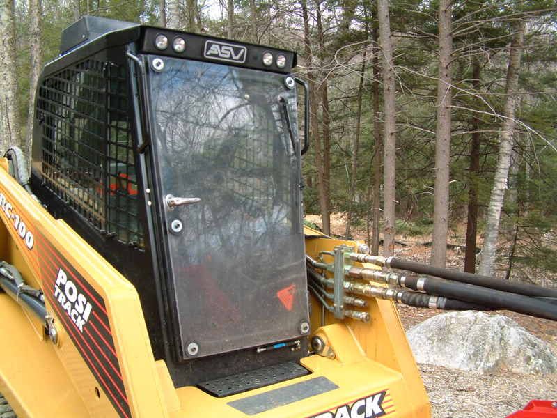

I can see where that pressurized cab would be nice, dust seems to be pulled into the cab. I'm going to try and seal them some how. I have already mounted a 1/2" polycarbon "forestry door".

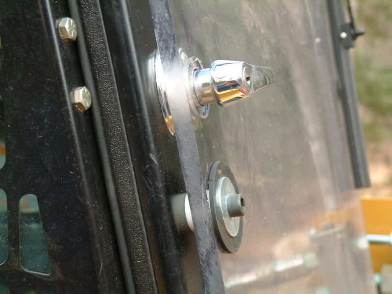

I didn't really buy a forestry door, I just added a 1/2 poly sheet to the front of the exsisting one.
It does make me slightly nervous, as I probably can't get out through the window now. I thought about securing the new safety window right to the exsisting one but wasn't sure if it would hold the weight then I could just kick both out forward if needed. I bought the poly from a friend of a friend who works with the stuff, he had this lying around and charged me $60, that plus some spacers, bolts, nuts and rubber washers was under $100.

Your door looks good. I have a friend who is offering to make me a door about the same but wants to try 1/2 plexi. I think I will try your design. I have an easy solution for your front door emergency exit. Buy clevis pins the same size as the bolts holding your window that have multiple holes in it. on the inside put a cotter pin thru it. In case of emergency just pull the cotter pins out, push the clevis pin out and out you go. You will have to use a foam spacer of some sort to keep the assembly tight. Does that make since.

Robbie you should make some calls and find a shop that uses sheets of poly, they should sell you a piece. I cut the door on my table saw and used a hole saw for the wiper and door handle, really not that hard. I am going to give that cotter pin idea some thought...
