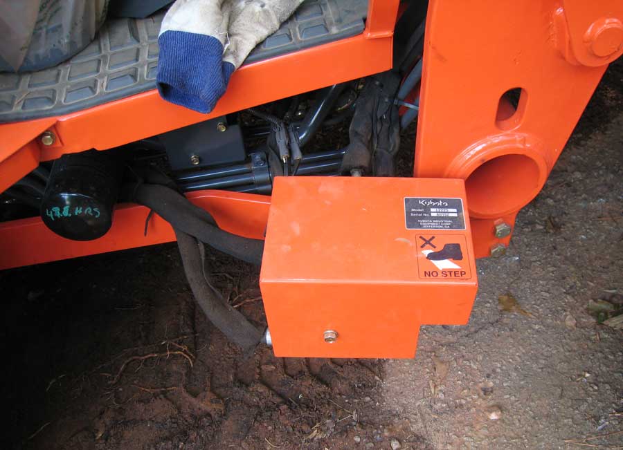

do a search on my posts (SCDolphin) on third function valves..........started with all factory Kubota but their valves leaked down so went with a mix of WRLong valves and kubota controller

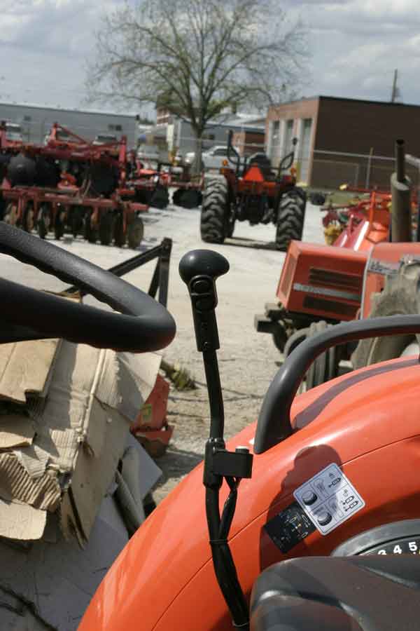

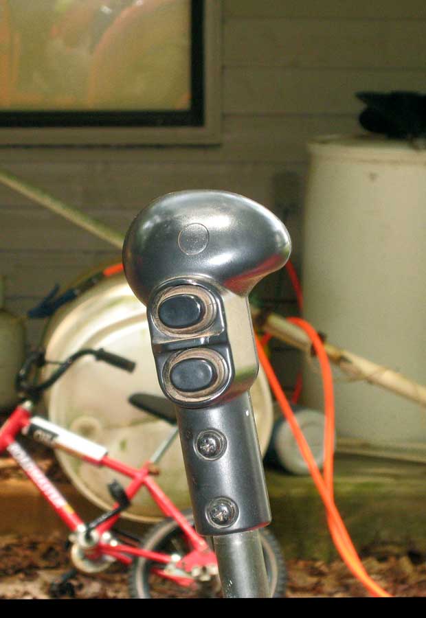

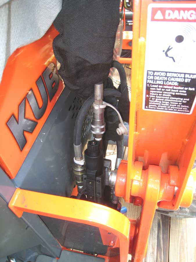

I originally wanted to stay with all kubota but that being said the Kubota diverter valve was a large clunky box just begging to be ripped off. It also leaked so when my 4n1 was open the jaws would leak down. The actual control stick from Kubota is good. The dealer replaced the diverter valve to a WRLong valve which is tucked out of the way. If you can't find my post with pictures let me know
