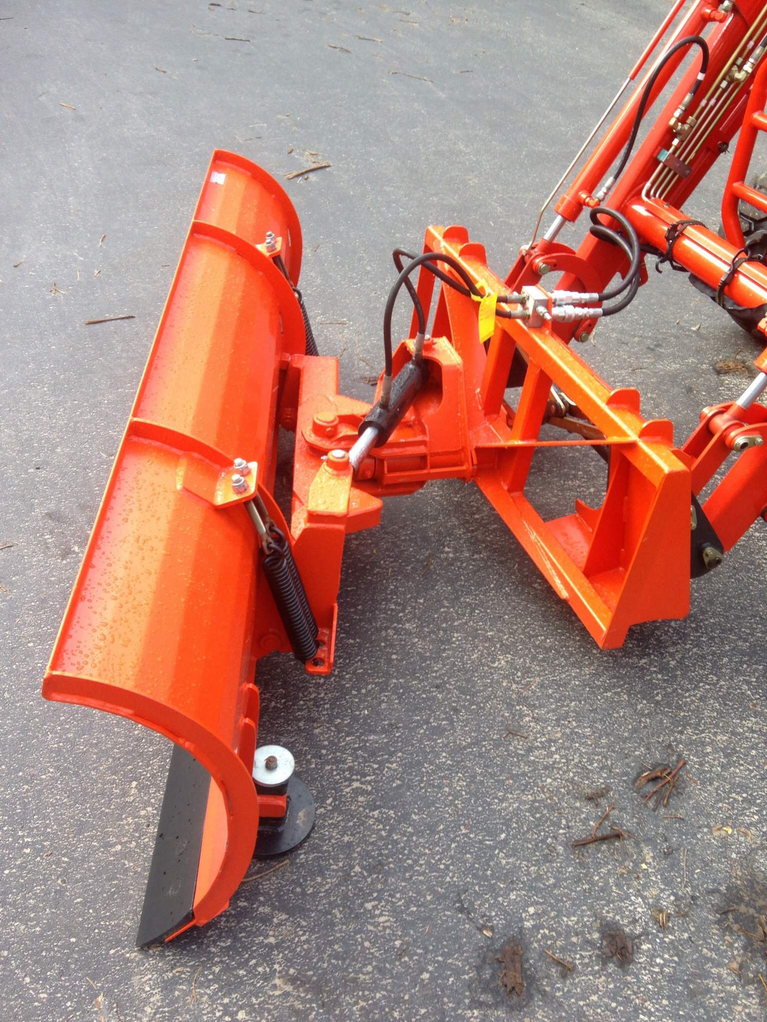

This is My HLA 3000 on my M108 Kubota, It has been a really good blade. This has been winter #4 with it and have had no problems. We have moved a LOT of snow with it over the 4 winters

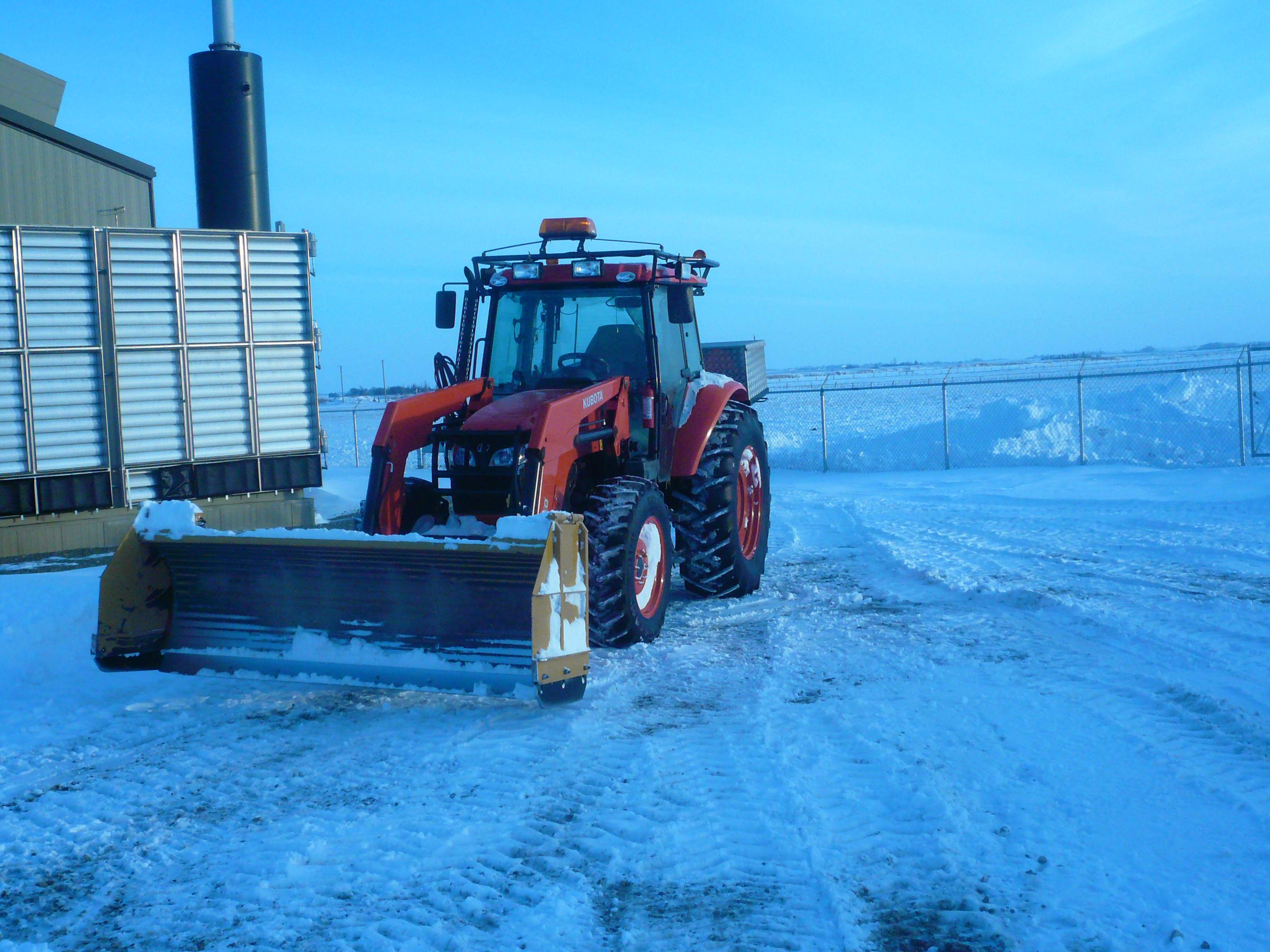

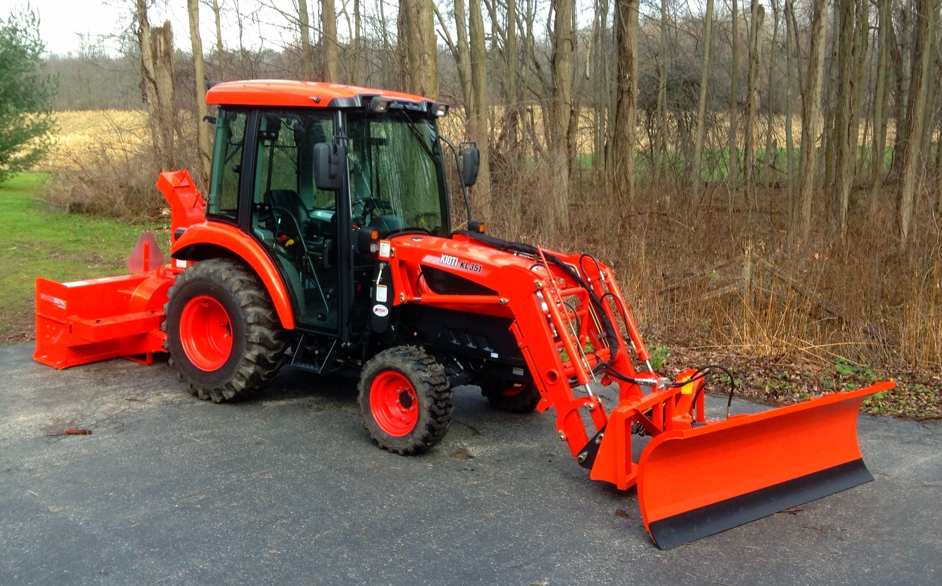

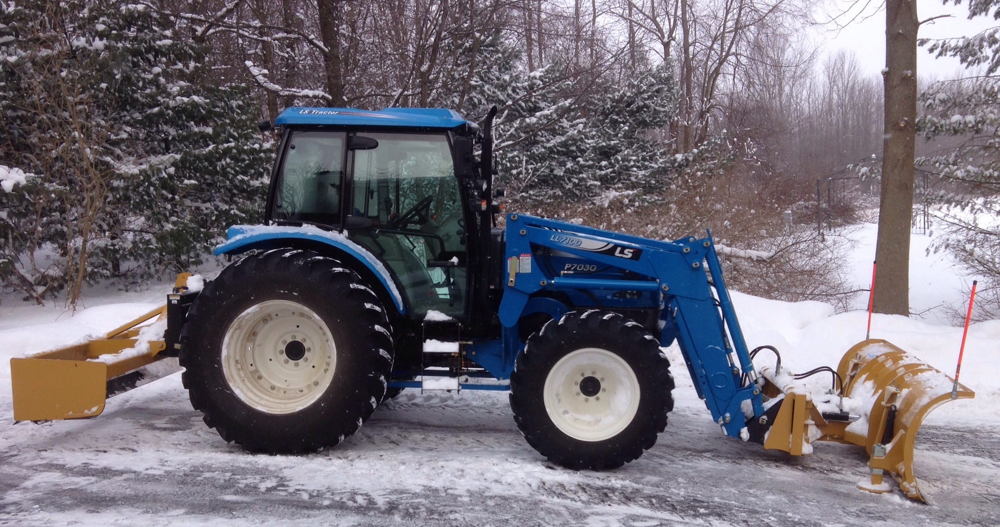

I had the 2000 series on my DK35 Kioti (35hp) and now have the 3000 series on my LS 7030 (88hp). The 2000/Kioti/R4 combo worked great on my paved/gravel driveway but struggled on the trails around the fields. Then again I'm comparing it to a much larger tractor with R1 tires. With chains I think the smaller tractor would be fine. Here's some pictures of both and a summer/winter picture example of the trails around my fields.
