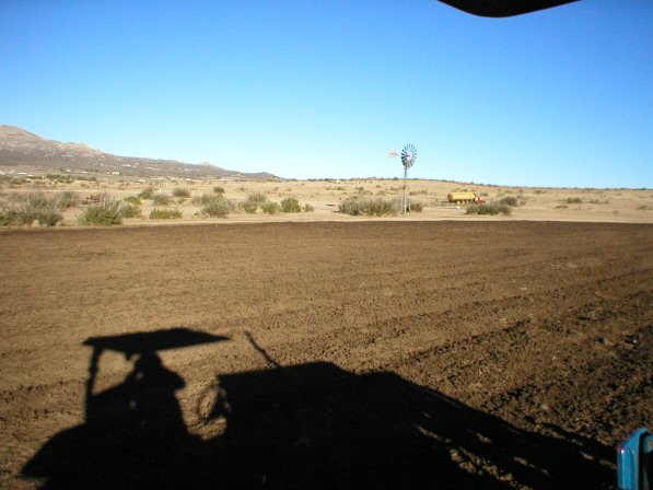

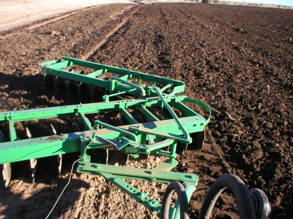

I doubt that your BX will pull a disk heavy enough to do much good.:( If it was me, I would be thinking about a rototiller, I know, more $$$$, but it will work for you. ;)
Here are some pictures of ground that has been turned over with a disk.

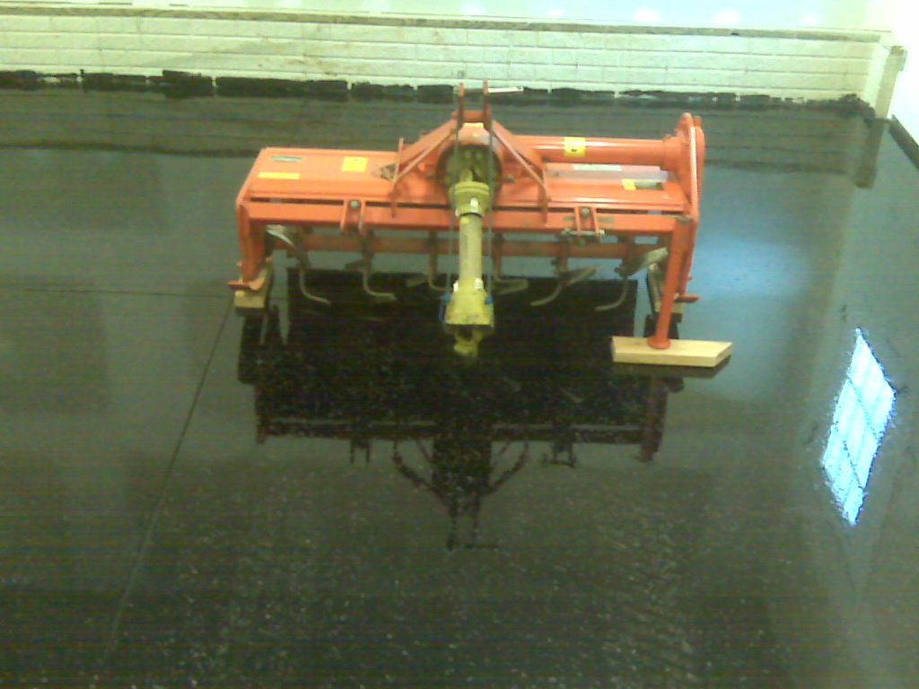

Well fine, I picked up a Howard HR3 tiller, one owner, my brother-in-law had it on his bx22xx. can't beat family discounts eh?
