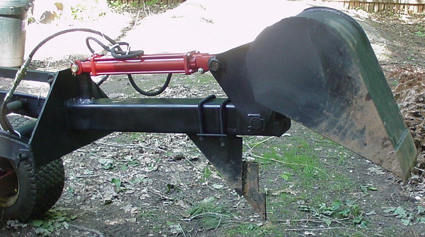

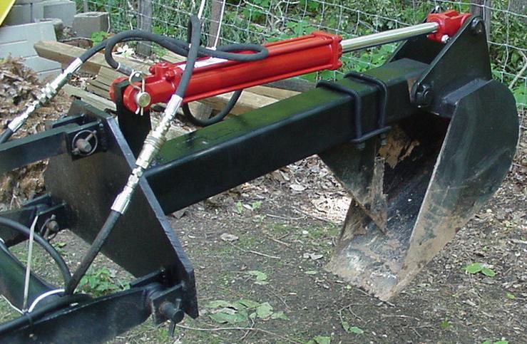

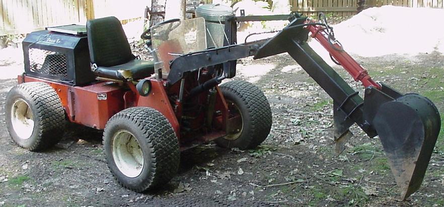

#11
It should be...the square tubing is 1/4" wall 4" wide, compared to the 1/8" wall 3" wide that PT uses for the mini-hoe. I have been guilty of under-building earlier attachments...I tried to over-build this one, and I think it probably came out just right!
Dave
