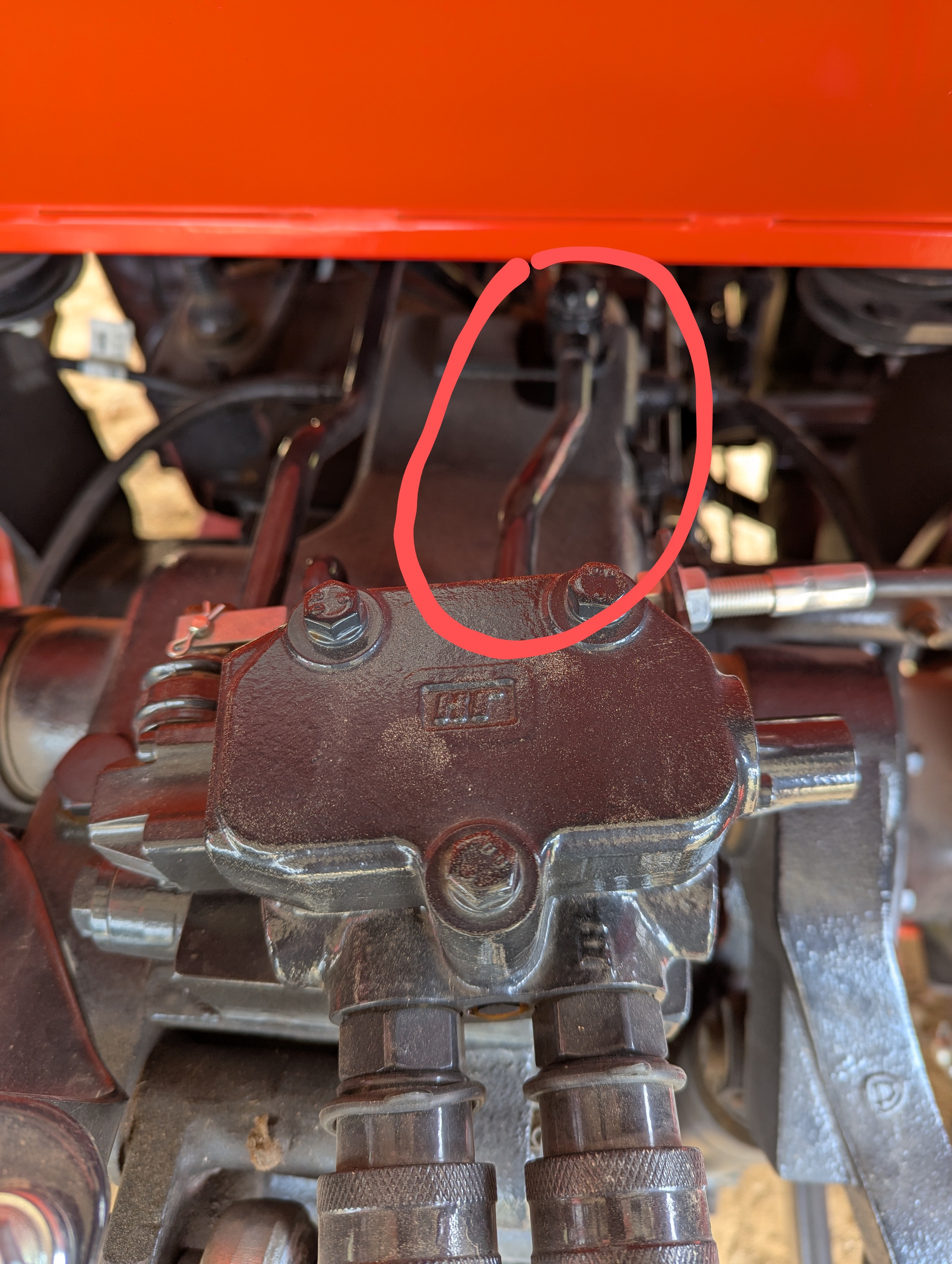

Hi Everyone,
I know there are a couple of threads regarding the 3rd function for the 7320 but none of them have specifics on the install process. Yes I agree the picture instructions are essentially worthless so hence I need the help. I know others have requested this recently as well.
I am seeking pictures of where the hoses connect into the tractor from the diverter valve. I believe the pictures in the instructions are from the Cab model or they are old as I dont have any P or T ports that I can identify near the right rear of the tractor.
I have a brand new 7320P Open Station and I only see 1 port labeled "P" (which is being used) and 1 port labeled "T" (which is being used) that sit just under/behind the right side steps.
Additionally any clarity on where the wire harnesses connect would be helpful.
I appreciate it greatly.

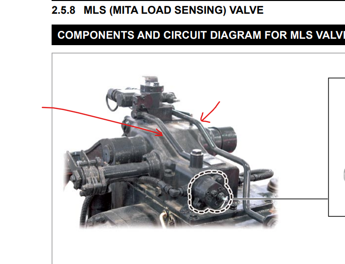

Hey Everyone,
Adding this in for the community. I called up my dealer to find out where the Tractor P and T ports are which connect to the diverter valve. I posted some pictures here for anyone looking to do this on their own. You have to remove the hard line but you will need to reuse the bolt on the T valve connection.
It would be great for someone to call up their service department to confirm. I plan on installing it all this weekend and will report back. I have the diverter and all its connections done. I just need to run hoses and connect to the bracket.

Looks like your images are pointing the lines going to the rear lift system components/MTA valve etc?
   / Pictures/Video Needed - RX7320 Open Station - RXA111 3rd Function Connection Points
Yes. Like the image I sent (which is for newer models of the RX, not sure what year it changed). My image the only one that is needed is the short hardline on the left side of the image. I believe its the same for the pic you provided. You only need to change the short hardline on the left.
