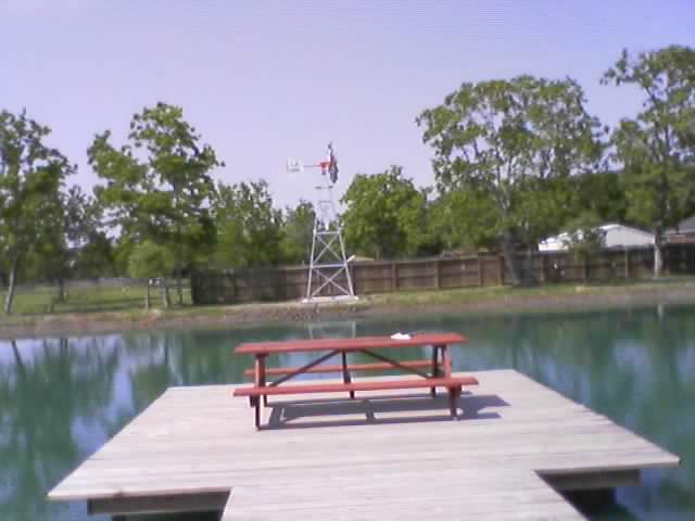

Nice looking windmill. You have a great looking pond and that deck looks very inviting!!!
Is it for looks or do you have it running something? I thought about getting one to pump water into my lake, but the prices of them were more then I was willing to pay.

Eddie, the windmill pumps air into the pond. As the fan turns it compresses and releases an airbag (like the ones used on pickup trucks for additional payload) the air travles through ~1/2" tube to diffusser stone that makes bubbles in the bottom of the pond. The areation is supposed to keep the fish happy :D Here is the link if you want to check it out: http://www.pondaeration.com/

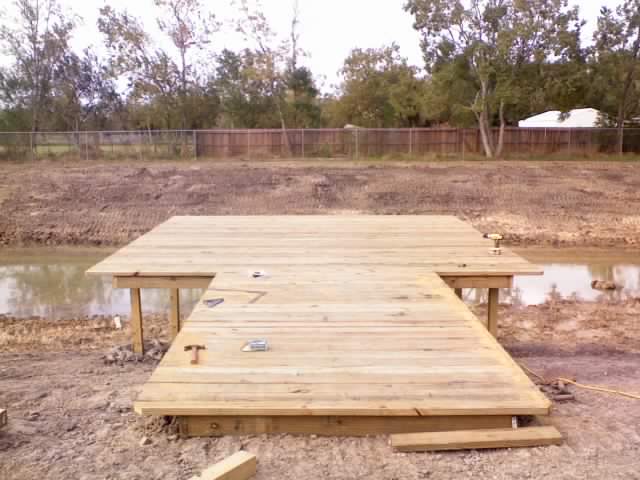

Very nice windmill. My question is did you design the dock. I am getting ready to build one on my pond and need some ideas. If you have more pictures that would be great if I could see them.

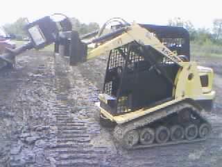

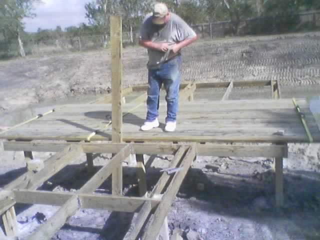

Hi Bubba, my buddy Joe "designed" the pier on a empty 12 pack box lol... I can tell you the hardest part is digging the holes while standing on the slope of the bank of the pond. I ended up borrowing a skid steer with a PHD made it a lot easier..
One good tip I have to offer is to use ratchet straps to draw the deck boards together tightly and keep them straight while screwing them down. They will shrink enough to have a nice gap in between them.
Here are some poor quality pics from my cell phone I can get the dimensions for you this weekend:
