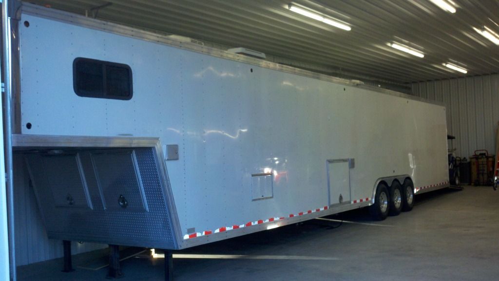

Pic of trailer in question. It's getting buffed, new reflective tape, and led lights put on.
   / Pin weight on race trailer #6
That is a nice trailer. It will look good behind that truck of yours.
Chris
   / Pin weight on race trailer #7
That will be a heck of nice trailer if it's the same ad I read. You could almost gut the extras and sell them for the price (generator, winch, hydraulic jacks, rear cabinets, etc.) Don't forget to check the roof seams.
Thanks Chris! The trailer was actually not for sale. The guy that owns it put lockers and gears in my Jeep and I saw it in his shop. I told him how much I liked it and he said he would entertain the thought of selling it and going to a diesel pusher with enclosed trailer.
