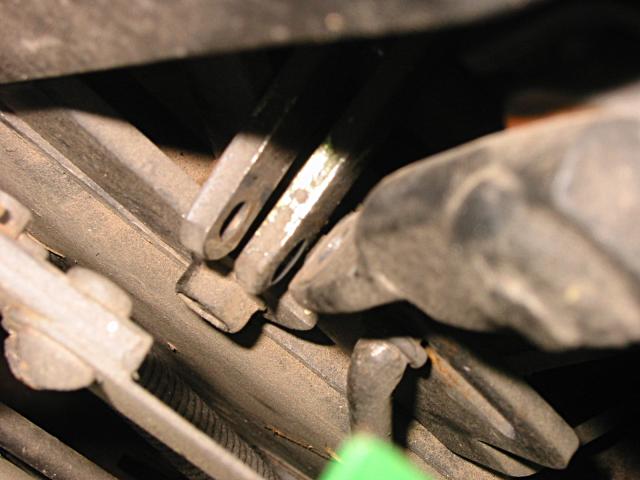

I went out this morning and took some pics of the offending objects in need of repair. This first one shows the seat lifted, and the FEL control lever at the bottom of the picture. The linkage with the missing pin is just below center of the picture.
At least it is warm today...and supposed to be in the 50s tomorrow!

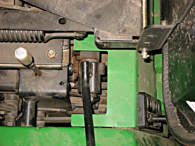

This second picture is a close-up of where I will need to put the replacement pin. The FEL control lever is the out of focus shaft, and the two fingers to the left of center need to go on either side of the control lever, and then a pin inserted through all three.
I figure I will need 4 arms and a trained monkey to get this done. /forums/images/graemlins/laugh.gif

Needlenose pliers might work, but they have limited reach. Perhaps you can attach the new pin to a strip of wood (or ruler) by drilling a hole thru it so the pin is a tight fit and once the pin is started the wood can be broken off. Or use hot melt glue. I don't know how much tension the arms have where the pin inserts but if you cannot reach them by hand try using a magnetic or claw pickup tool to line them up. Or wrap some solid #14 wire around the arms to give you some grip for moving them.

I broke that piece on my 855 a few years back. Take the fender off. It'll make the job much easier. There are only 4 bolts if I recall. You don't even have to remove it. Just unbolt it and slide it to the side.
If you haven't already, check out jdparts online - you can get a good idea of how each part goes together, and what cotter pins / washers etc. you might have lost.

By now, you may already have it fixed.
One suggestion that might work (if you think a piece of wire might be able to be threaded through the linkage holes where the linkage pin should go) is to fasten the linkage pin to the end of a short 16-18 ga wire (by running the wire through the cotter-pin hole of the replacement link pin). Then thread the other end of the wire through the linkage pin holes and pull the pin through the holes with the wire. It will give one hand (with fingers) free to guide the linkage pin on the wire through the three holes, lining the links up as you pull the pin through when pulling on the wire.
Not a sure thing, but the wire extends the hand doing the pulling while the other hand lines things up for the pin.
