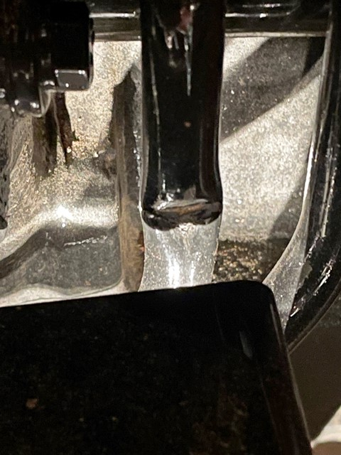

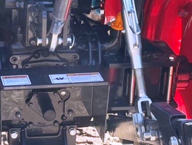

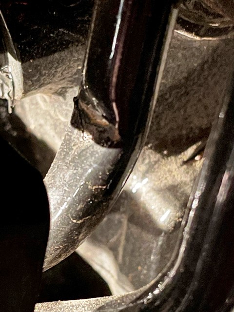

I was using a subsoiler to pull some large roots and one came up under the rear of the tractor, caught bottom edge of the PTO cover and pushed to top corner up into one of the two metal hydraulic tubes and partially pinching it. I'm not exactly sure what this tube is supplying but is it possibly the PTO drive on this Hydrostat Branson 3620H? I've been using a tiller and have not noticed any performance problems but interested to get opinions on if I might cause any damage if I don't replace the tube.
Here are some photos. The first shows where the tube is located on the rear of the tractor before the PTO cover got pushed up.

My worry would be a restriction causing excessive heat build up. I would be inclined to replace it.
   / Pinched Hydraulic Tube Should I Replace? #3
Cut the dent out and splice it with a tube splice connector. Worked just fine for me get the stainless one for high pressure just in case.
   / Pinched Hydraulic Tube Should I Replace? #4
I would "FIX" it ..Either repair or replace.... Dent like the is a failure point (stress riser) that could cause tube to crack or bust at anytime specially if it high pressure line ... Probably at worst time for user...
   / Pinched Hydraulic Tube Should I Replace? #5
I would look at the parts book and shop manual to figure out exactly what that tube does and then use that to guide my decision.
If it is a high pressure supply line to something that uses a lot of flow -like the HST- I'd replace it.
But there isn't any downside to first checking what it does.
rScotty
   / Pinched Hydraulic Tube Should I Replace? #6
That tube is indeed for the PTO clutch pack. It comes from a solenoid valve on the right side of the transmission housing, then it feeds the PTO clutch pack with those two steel lines. One of the lines is pressure to the clutch pack, the other is lubrication to the clutch pack.
I don't think that pinch will cause any harm as the lines look slightly oversized for the flow that goes through it.
That being said, it's always better to fix it as it may cause a stress point and eventually crack with vibrations.

All good points. Where the kink is is not straight enough to just cut it out and put a union/coupler back in. Same for brazing in a new section of pipe. I did determine its the high pressure side of the PTO clutch control so I will price the replacement part and if its not outrageously expensive, just replace it for "peace of mind" because as we all know, if its going to fail in the future it will happen at the most inopportune time possible.
I appreciate all the great input.
