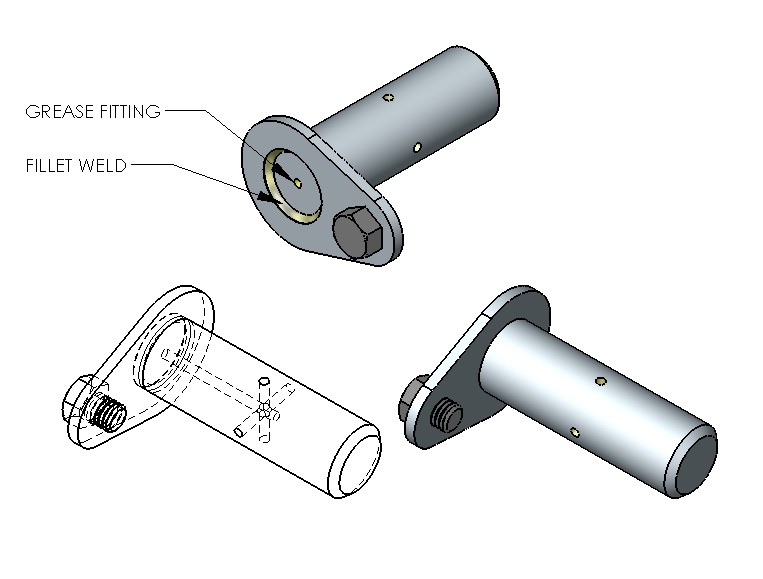

Guys
I am designing a FEL in Solidworks for my little Kubota, and was stealing ideas off of a bobcat. I noticed they use the pins (see attached Solidworks jpeg) for the pivot mounts for the cylinders. Any idea what these little gems are called and where one can get them? I may also try to use Large Bolts if I can find some with grease fittings and grease channels already cut in them.
Thanks

I made some pins for my FEL mounted plow before I made it work with a quick coupler. Purchased them from TSC. They are 1" in diameter. Drilled them for a grease fitting and put a hole that put grease in center of cylinder end. Since the fitting was behind blade and out of the way. I did not need to counter bore pin to recess grease fitting like your illustration shows. In the attached picture it is only being used to match up to my quick coupler. Quick coupler does not move so it does not need grease. The pins come in 6" and 4" lengths. Hope this helps.
