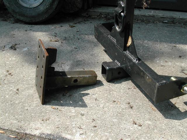

How does everyone attach a pintle hitch to a tractors drawbar? I do have a welder. Check the attached picture of the 2 to see what I'm looking to do.

Here is an inexpensive solution to your problem. With this idea you can "plug" just about anything into your tractor.

Chris; This photo shows how I would do it, using mt 3PH adapter. /forums/images/graemlins/grin.gif

This one is another view.
If you dont have an adapter, or want one, you could do like Pineridge, and weld the adapter plate to a spare drawbar.
I vote to make yourself or buy an adapter, like many us have done. /forums/images/graemlins/grin.gif

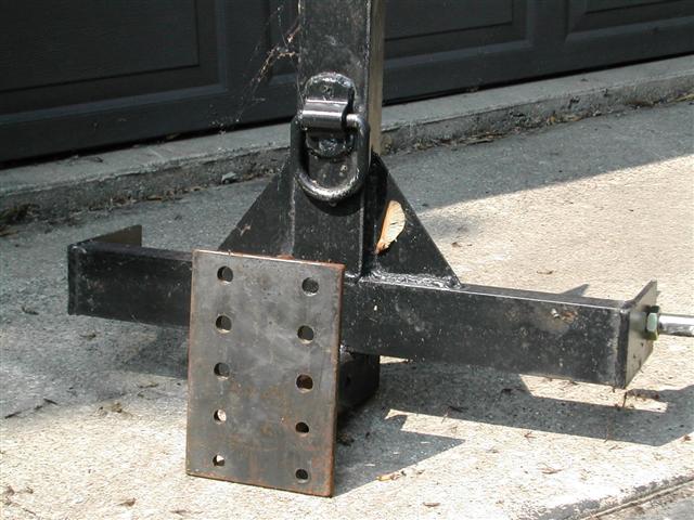

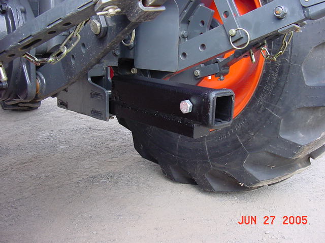

Welding time is a hair below seat time. Here's my welding time that in turn makes for more seat time.
I welded a 12" x 2" receiver to the drawbar and now I can adapt to tow anything.

Another view with pintle hitch attached.
