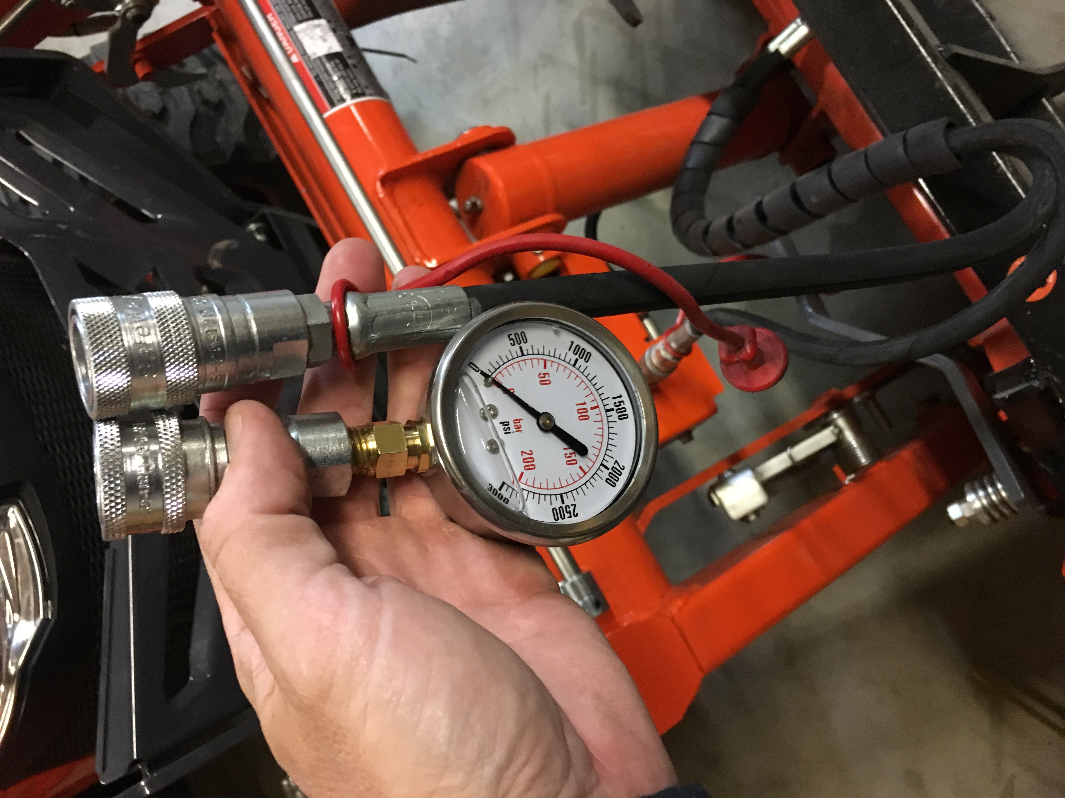

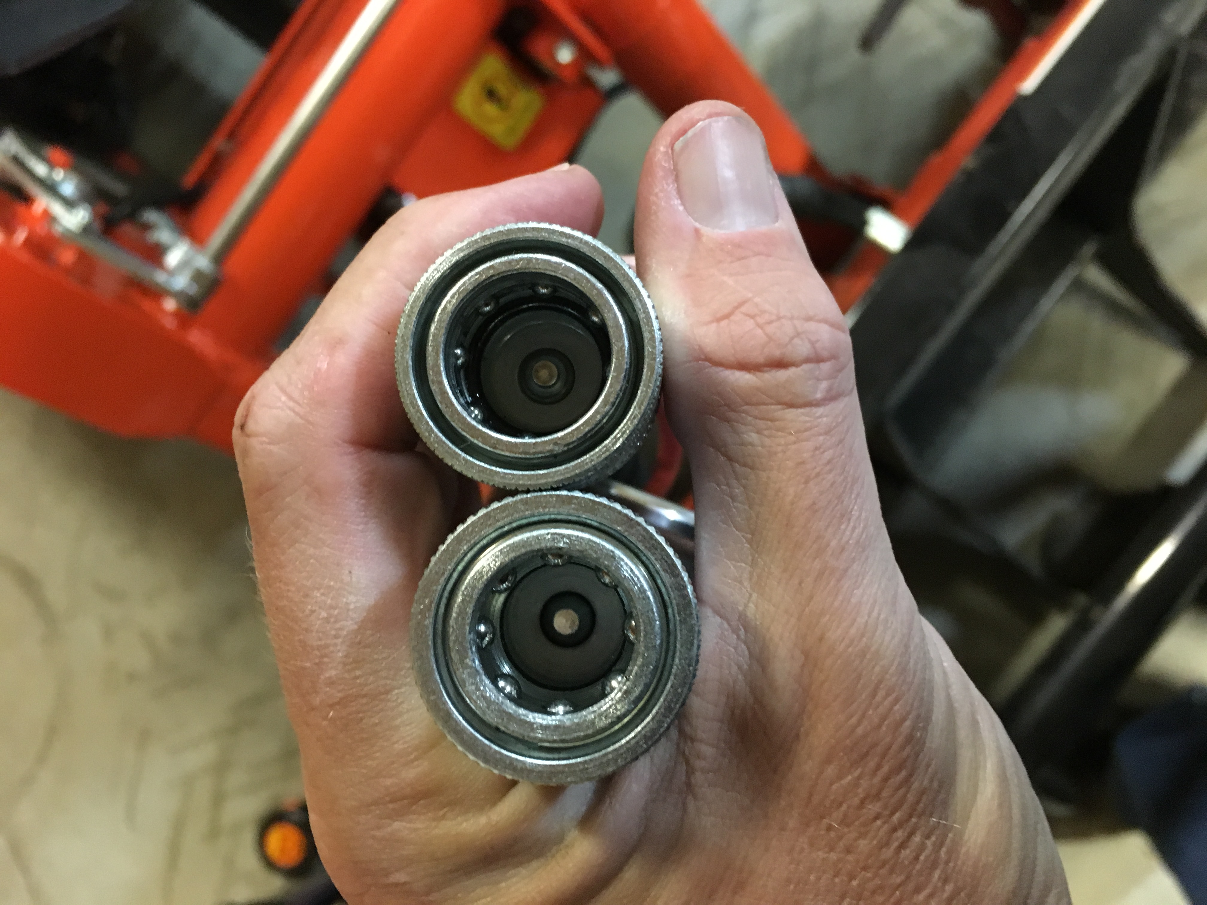

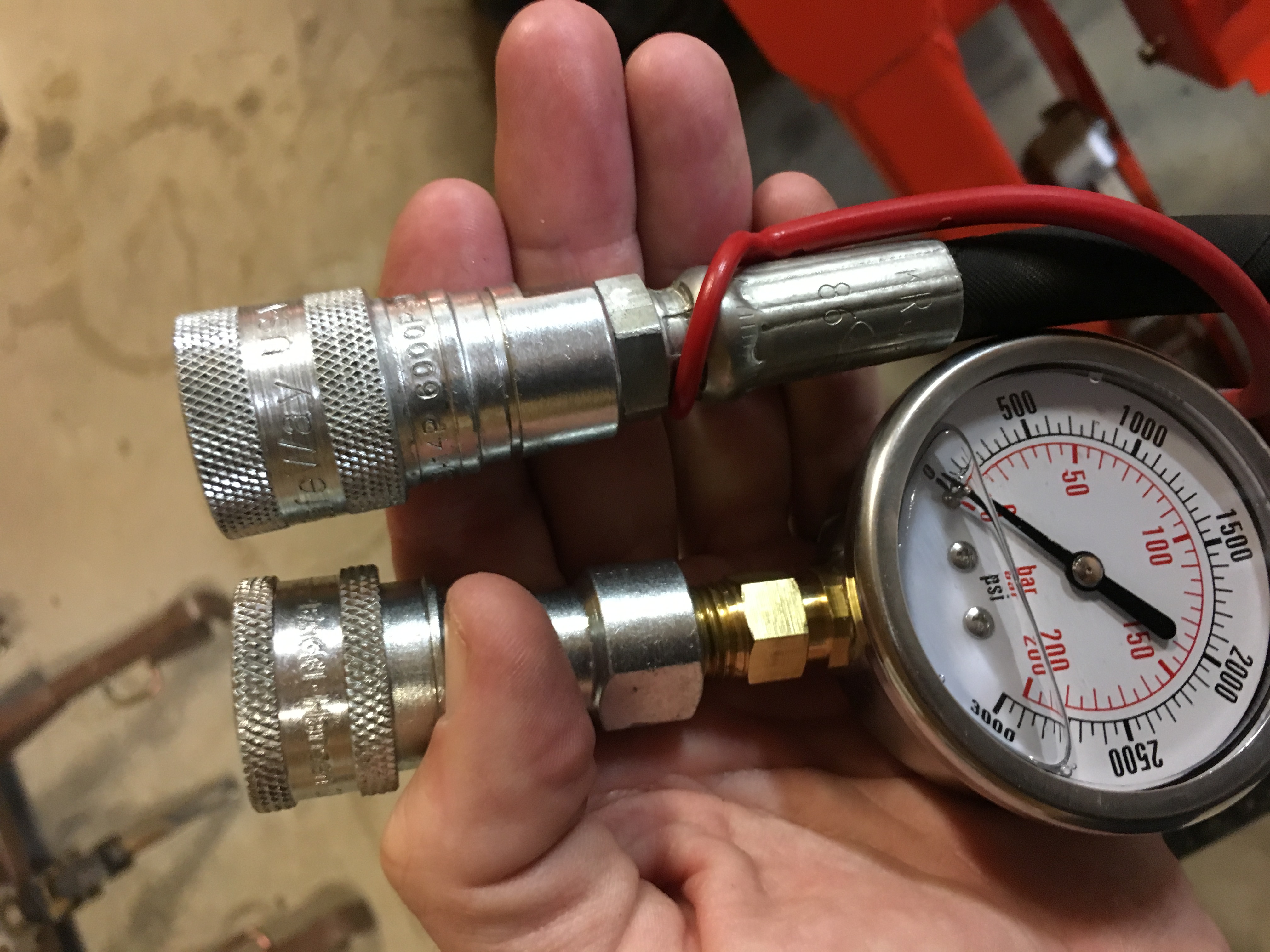

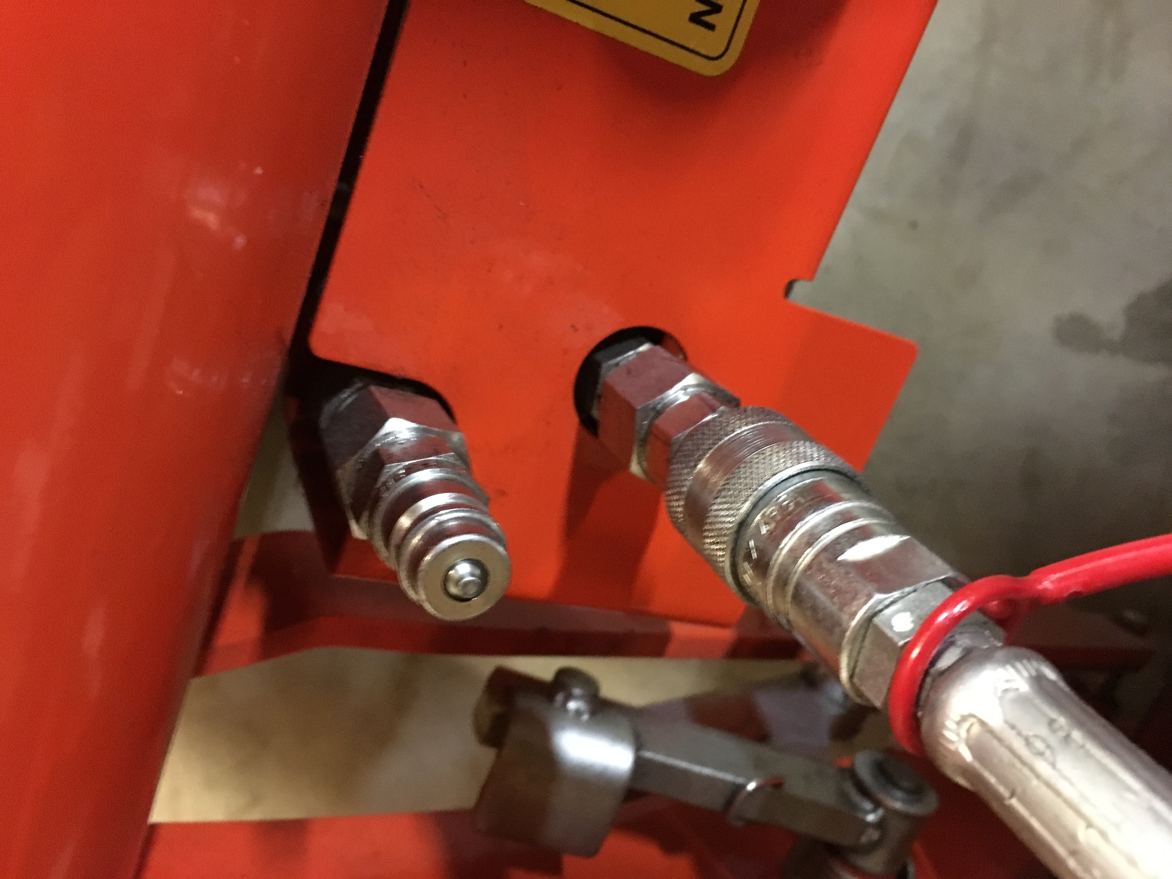

So I know the kit is not for the new 23s that uses flat face couplers. However I have the front 3rd function which uses the traditional pioneer couplers so I ordered it anyway. For the life of me I cannot get this thing attached. What am I missing. Everything measures appropriate it seems but I just can't figure out what is not adding up here. All pressure is relieved. The coupler part looks a little bit different, maybe a bit deeper on the Land Pride Grapple hydraulic coupler. Maybe some experts here can figure it out???

The couplers do look different. Maybe remove the male on from the tractor and try it on the bench. If don't go, you know it's incorrect.
Or check the part #s online of both pieces to see if they are compatible.

I suspect one is 7241 “A” coupler and one is a 7241 “B” . Post the numbers on them and we can verify.

Looks to be different diameter balls as well as appear to be inset different amounts...............Mike
Will do...are the numbers located just below the slip collar? and thanks!

There are several "flavors" of Pioneer or Ag couplers. The male couplers have different profiles. You have to check the ISO# to be sure. Take the gauge to a farm store or dealer and find a male coulper that fits.
ISO 7241A couplers look like this: ISO 7241-1 Series A Hydraulic Quick Disconnect Couplers
ISO 7241B couplers look like this: ISO 7241-1 Series B Hydraulic Quick Disconnect Couplers
ISO 5675 couplers look like this: ISO 5675 Agricultural Hydraulic Quick Couplers
VH series couplers look like this: General Purpose Hydraulic
   / Pioneer Coupler Question - Pressure Testing - (Pics) #7
They come in two different diameters so without being there to look for myself, I'm thinking that could be it.
