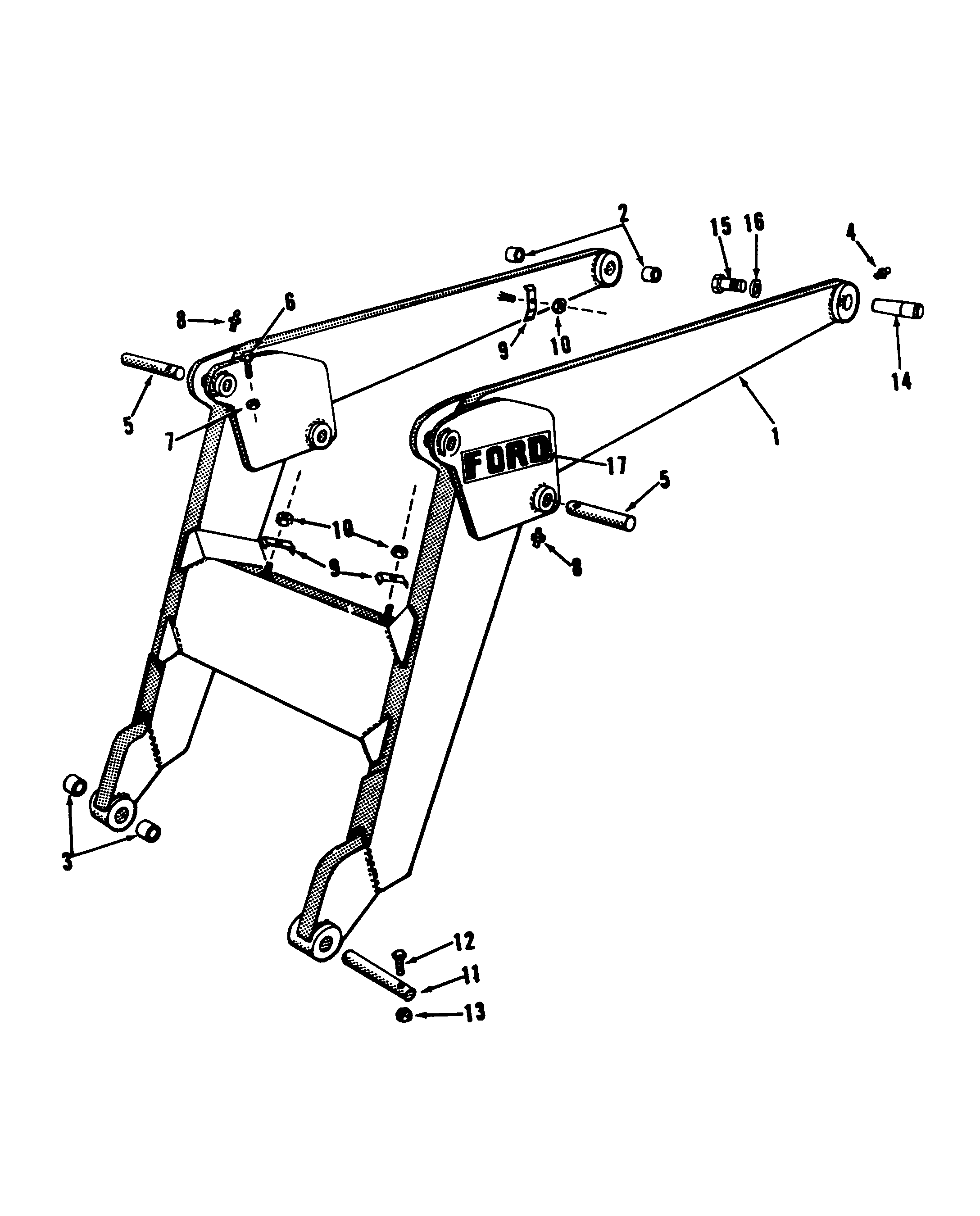

Ford 4500 Just noticed the loader attachment pivot pins. Two lowers are not grease able and one upper was replaced with a piece of pipe would like to replace all four .Nowhere to be found any help would be appreciated. 1 1/4” x 6 1/2 ” greaseable if possible. TIA

All pivot pins (fulcrums) need to be solid steel, not pipe and all should be cross drilled to accept grease fittings, no exceptions.
   / Pivot pins #5
Wow that sound spendy
Not really. Any good machine shop should be able to make them for you as they are a pretty straight forward piece. Order the bushings, 291548 before you have them made to give the machinist the ID dimensions of the bosses being made.
Parts book for the 740 loader show what they should look like:
Alternately, you could call a salvage yard and see if they would have or take off the bosses on a junk loader.

The issue with that is, most likely any take off boss will be oval. better buying new or making them up.
