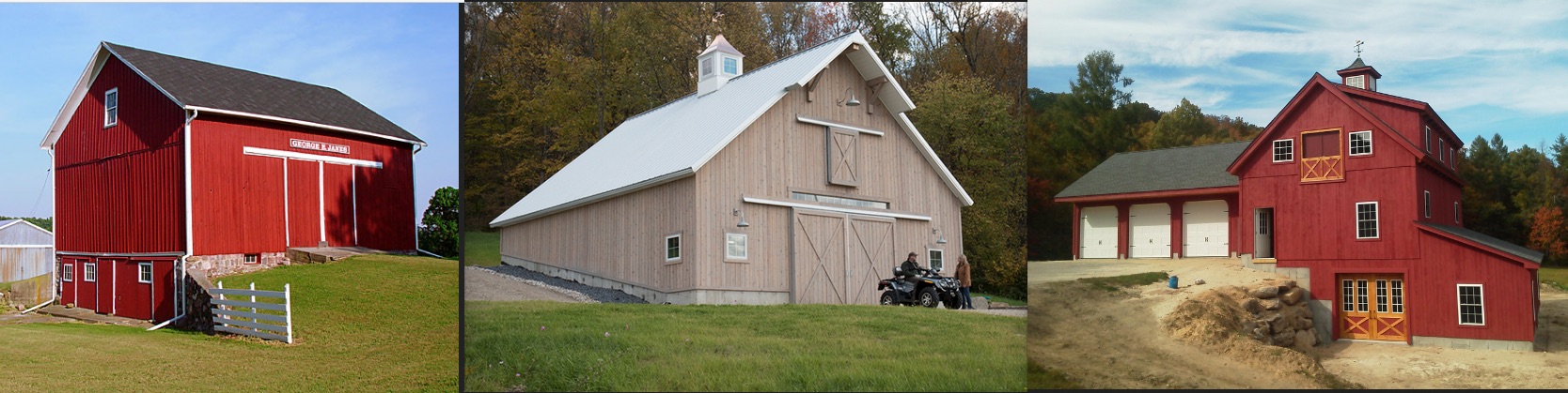

I've seen old barns built on a hillside so there was ground-level access to both upper and lower levels. Here are the first three I found to illustrate the idea.
Bruce

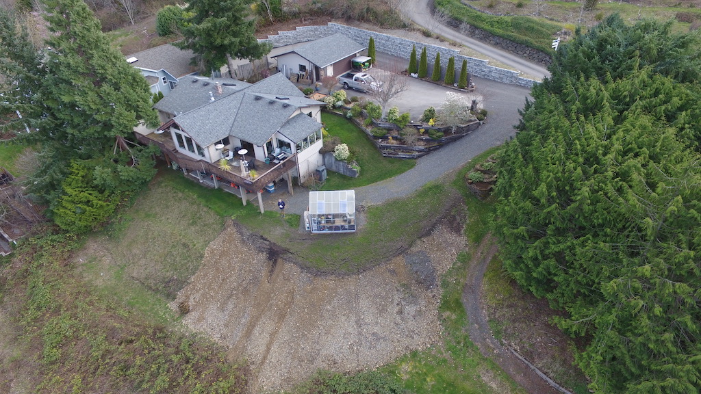

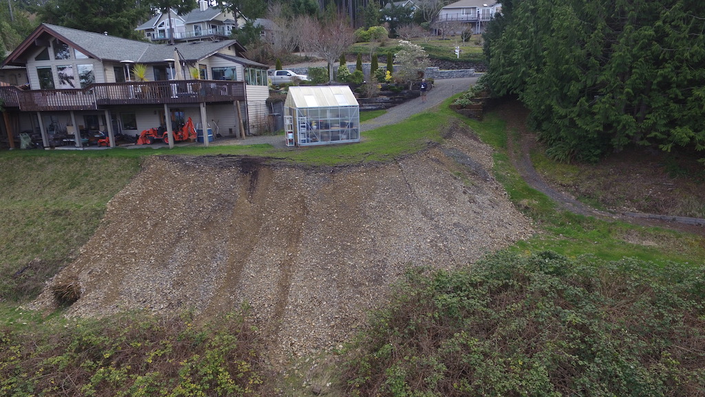

Okay found some pics, one from our recent record snow of 18in. I am clearing the shared driveway and entrance to our house.
These other two I took with my drone last year when my next neighbor had a new retaining wall built on an easement between me and the neighbor above. Notice the fill from the retaining wall project went on my steep slope giving me access around my greenhouse. Prior, I could not walk around the backside of it. The trees to the right in these two pics is where my #4 option would reside. Again very steep. Hope this helps describe the situation.
