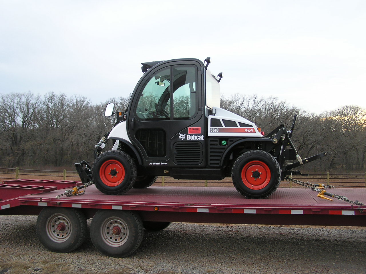

Instead of the Farmboy, why not get the 5610?
View attachment 373978 View attachment 373979
We considered getting the 5610 but decided we would rather have the bed then the PTO since the PTO isn't very powerful and we have a couple smaller tractors with PTOs already.
