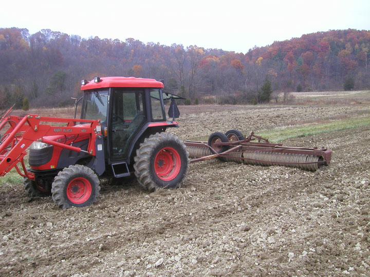

I probably do this different than most people, first I disc the plowed ground, then with a spreader I broadcast the wheat, then I follow with a packer that presses the seed into the ground. Time consuming but the disc is 18 ft and the packer is 15 feet wide.

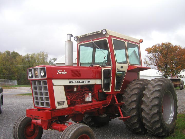

I've posted a pic of the packer, below this field is a smaller field that you can see, I got the IH 1066 and disc stuck there on Monday, I was stuck bad. I had to unhook the disc, pull the tractor out, get a chain and then pull the disc, which probably weighs about 4000 lbs. It takes two jacks to get the disc back on the tractor, all in all a fun afternoon.:) The IH needs the duals back on so I can get better traction.
