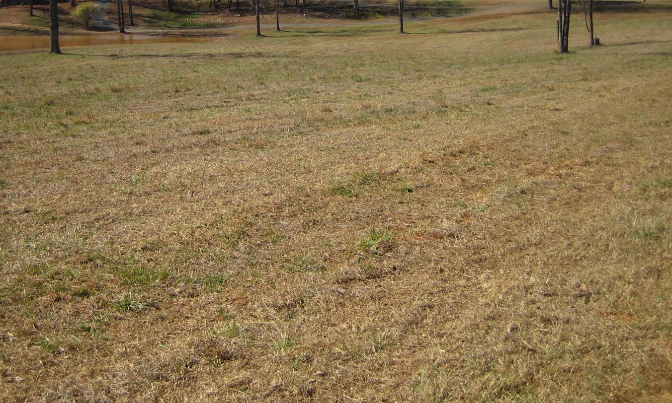

If I dragged this with a chain harrow and then spread it and then rolled would I get a good stand of fescue mixed with clover?
   / Planting grass/clover/other after clearing #10
Is that just dead grass on the field or soil? When you sow, you don't want any competition from old grass or weeds. Ken Sweet
