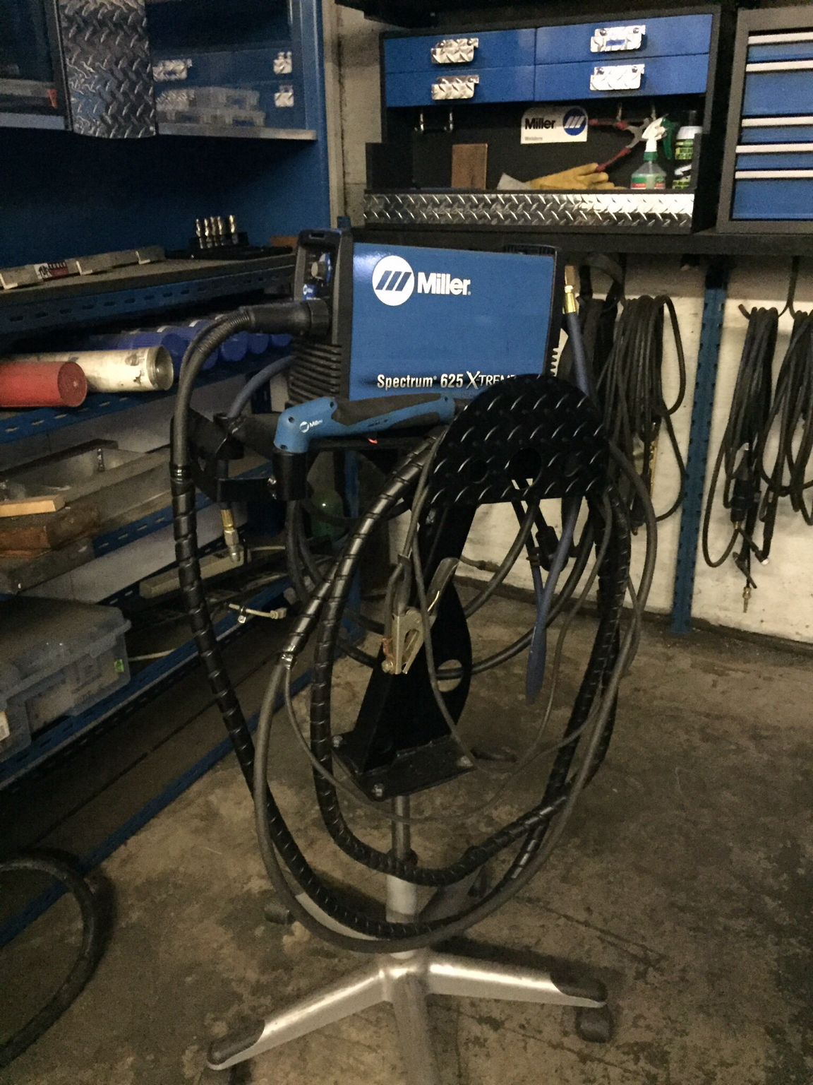

I have been reading a lot of good reports on the Everlast machines, but I havent actually seen one so I wont comment. Hypertherm seems to be one of the leaders, but they are a little pricey. I own a older miller 625 spectrum. I believe I paid $1800 for it new when I bought it several years ago. You can buy better and cheaper now. Its isnt one of the dual voltage machines, just plain 220v. Its rated at 40 amps, I have cut up to 2in thick with it, but its more chewing and knawing than cutting. 1/2in it does pretty good. I think they claim 7/8 ?? but for good quality cuts, I think thats pushing it. I have mounted it in my homemade track torch and got decent cuts on 3/4, but its slow slow slow. I usually hook up my gas torch for anything that thick. Now that I think about it, I have a bunch of 1/2 plate laid out and plan on using gas to cut them with. Not that the plasma wouldnt do the job, I just dont have the compressed air capacity to make those long cuts. I dont know which machine I would buy if I needed to replace what I already have, but I do know I would replace my air compressor first and I wouldnt buy a machine rated at less than 40 amps.

I'll join in here and agree with muddstopper and yomax4. If you plan on doing any amount of cutting (unless light gauges only) purchase 40 amp MINIMUM.
A couple of years ago I was shopping for a new 60 amp machine to replace my woefully inadequate early model Miller Spectrum. I came across a brand new 40 amp Miller on eBay which accepted my offer of 1/2 the going on-line prices.......
I SHOULD have saved my money for a bigger amp machine. :(
