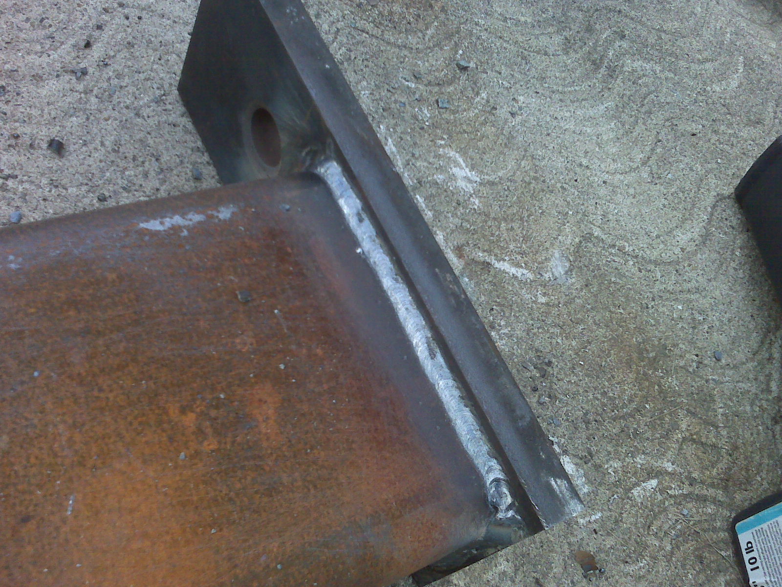

I have a 3-in-one 160 amp welder/plasma/tig, about 4 years old now. It's manufactured for Parker MP (a guy that was selling them on ebay), i believe manufactured china. It works great for me. I run 1/8 7018 rods at 120 amps all day with it without any problems. I use it almost every weekend. The plasma cutter works good on metals under 3/8. I've never used the tig part due to having a mig welder. It's a DC inverter machine. Running at 120 amps it has a 100% duty cycle. I am a certified welder at work, and compared to our miller machine there, I consider it a good buy for a weekend warrior.
attached is a pic of a root pass I did with it.

Sort of weld I dream about. I really don't do enough to become proficient. Still, each to his own, I'm sure I must have a talent somewhere. Must look under the workbench!!
