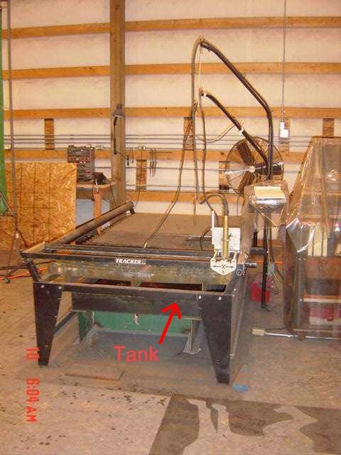

Curious what is it you are making @ 40000" of 10 ga / day? And how do you manage the dust and grit.
I did enough cutting with my DIY CNC plasma cutter to generate a LOT of dust, sometimes I would run it for five hours constantly,,
5/16" and under, I cut with plasma, 3/8" and up, I used oxy/fuel.
My machine was located 5 feet from the roll up door of the shop.
No matter the weather, if the plasma torch was cutting,, the door was up.
Most times, the door was up for the oxy/fuel,, too,,
I had an industrial 42" fan that was directed out the door,
if I was cuttin', the fan was blowin'!!
I still have the machine, but, I have not needed it since I moved it.
Some day, I will get it runnin' again!! :thumbsup:
Got a order for over a TTL of items. I do have 10 more months to make all of them. Have 1/4 of them make.
I have a 5'x10' table with a 3400 cfm fan under it.
I have a number of online shops and ship my metal signs worldwide.
jack707, the compressor cost 1K.
On a water table, if the water is close enough to catch all the dust, then it is so close it will short out the torch. Far enough away not to short out the torch, you will only catch app 1/2 the dust.
