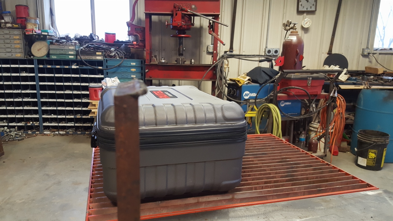

Crappy, rainy day outside so I'll dig thru my iron pile for examples of cuts.

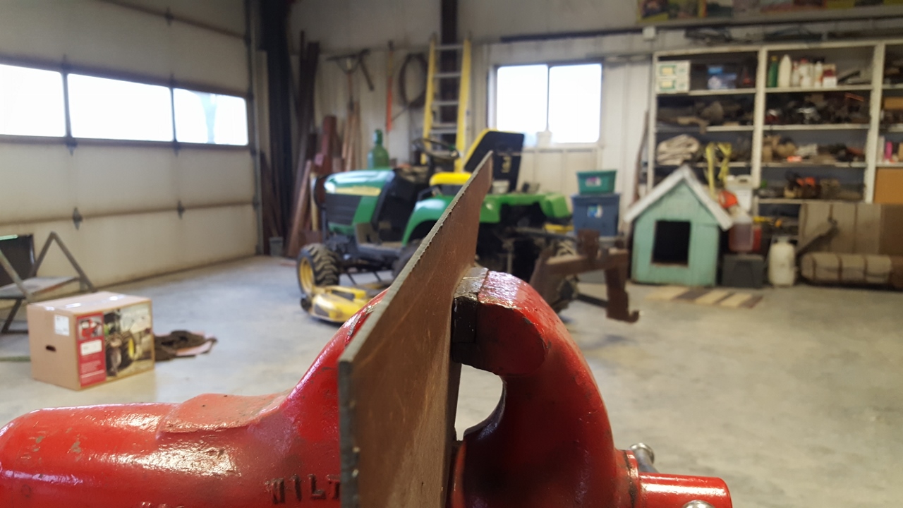

Here's the first I found. 1/2" mild steel. Excuse the quality of a couple of these, for some reason I couldn't get my phone camera to focus on the subject....
This first pic is an example of a bad tip. Notice how it didn't cut thru the flatbar at a 90 degree angle. The cut is "leaning". That's a typical result of a worn tip and/or electrode. Also notice the amount of slag. That's caused by going too fast.
These two pics are perfect examples of a bad operator (me)......
This pic better illustrates the speed problem. Notice how my cut is leaning and curved rather than straight thru the metal. I was in a hurry, obviously.

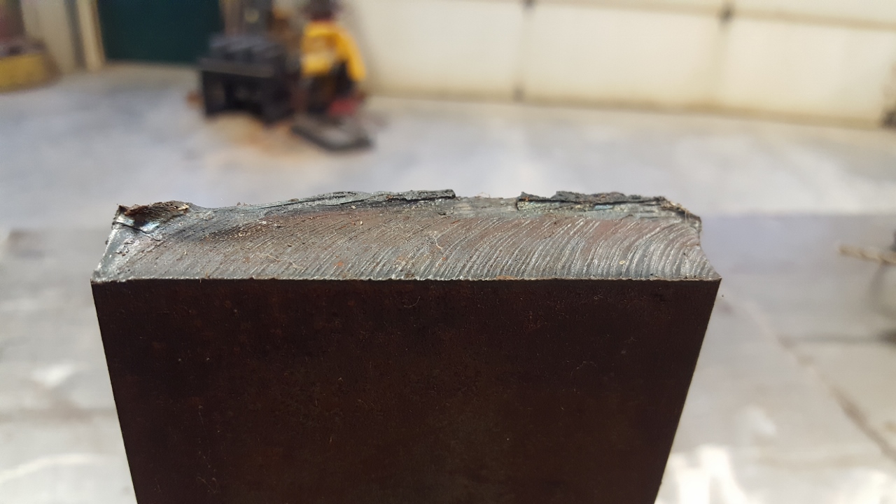

Here's a couple more examples.
First is 1/8". Using a guide. Probably not a new tip but at least a good one. Notice cut angles and minimal slag. Better speed control. Have no idea how fast I was going, but moving right along, faster than cutting with a torch.
This pic is 1/4" metal. Again, speed control was pretty good. Minimal work required to have a finished edge. What this cut displays is the result of cutting metal that's not smooth. Look closely at the cut and you'll see imperfections. These were caused by the roughness of the metal. Caused the tip to not travel smoothly. If this had been a new, smooth piece of metal, those imperfections wouldn't have been there.

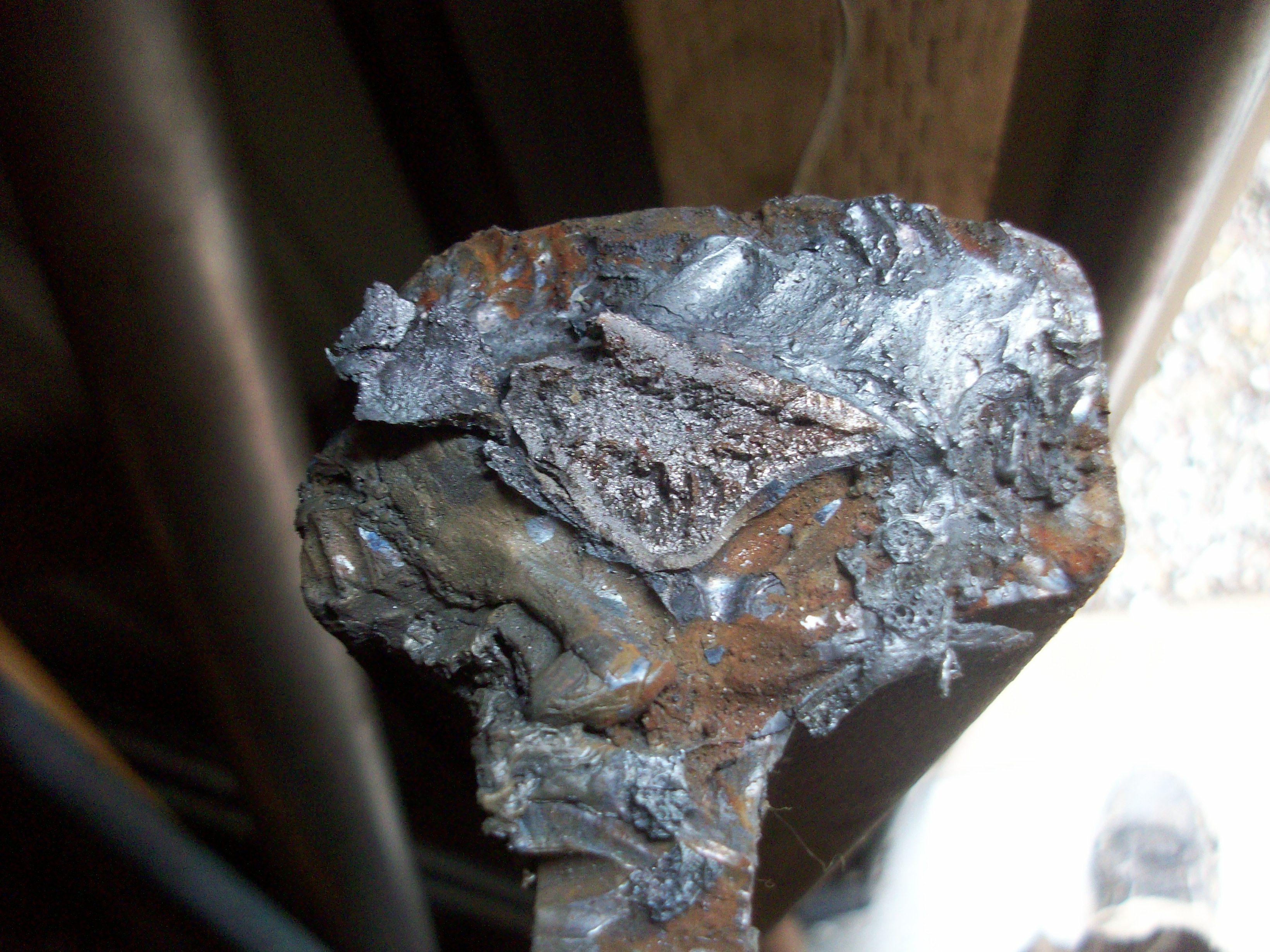

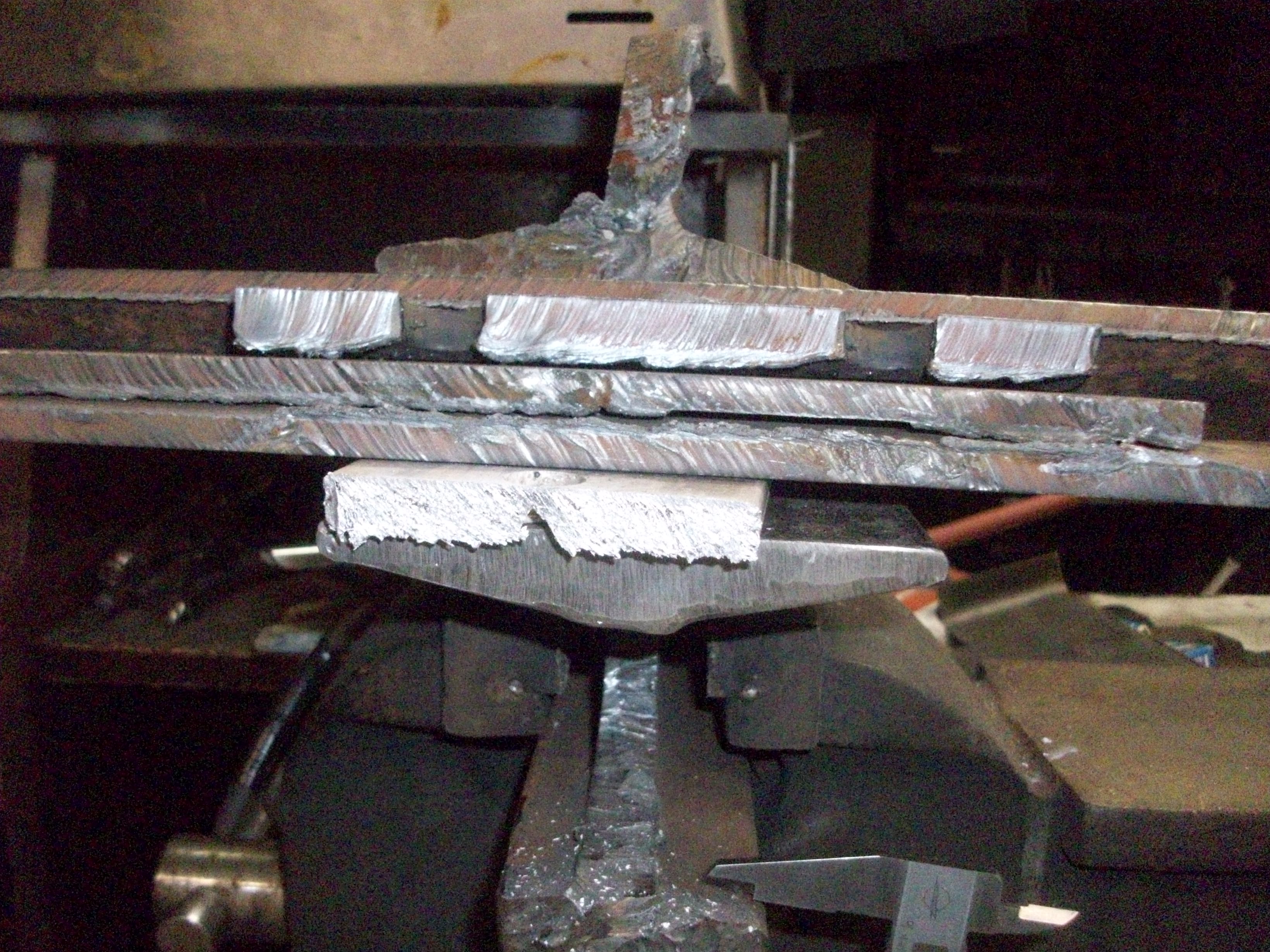

Dug out some of mine, the cut quality does have a lot to do with how steady of rate you can keep the torch moving- obviously I had some problems with the controlling movement.
One thing that has helped me improve ( lately ) is to watch the sparks exiting the bottom of the cut, there is a sweet spot that the plasma exits that seems to correspond with a good cut.
A really smooth straight edge with enough side height has been helpful to and also keeping the torch body as square as possible while moving along the cut line.
below the ugliest cut I have ever made:laughing:
