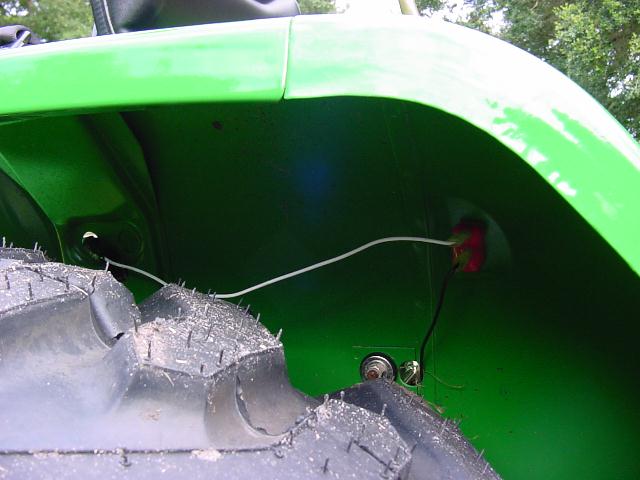

Now, maybe someone can help me with what I need to finish off the wiring under the fender, I know I shouldn't leave it like this but I'm not sure how to finish it off to look nice and safe (when it comes to wiring I'm out in the cold as far as cleaning it up and making it look good) Maybe some kind of rubber grommet to hold the black plastic wire holding thingy where it goes through the fender and how about the switch with the wires hanging there has to be away to clean that up?????

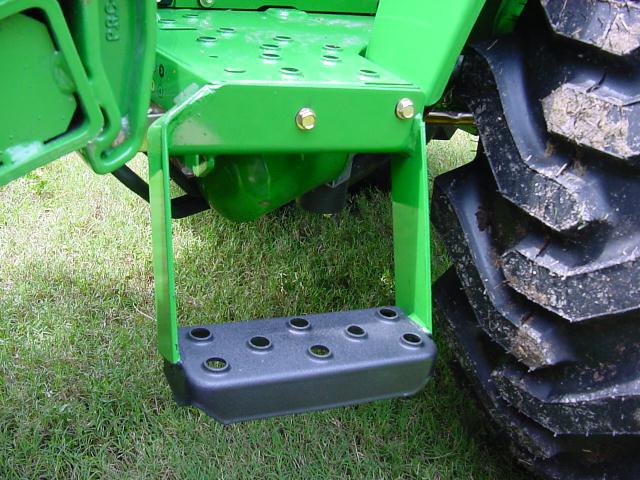

step...

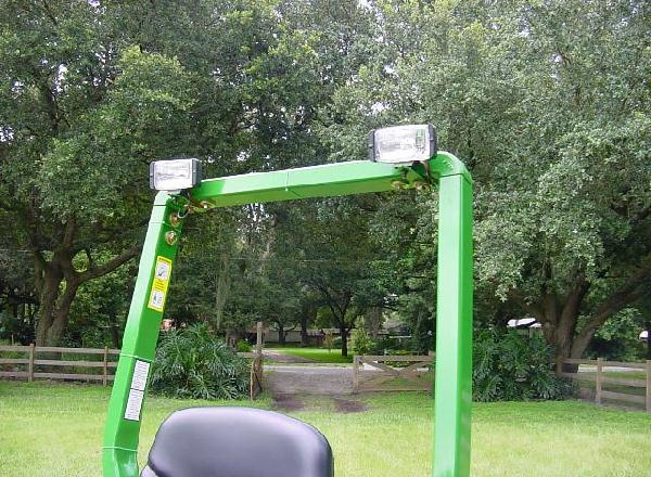

lights....

from ROPS to hole in fender, this is were I need some help cleanning it up???

</font><font color="blue" class="small">( and this shot is just plumb sloppy....is there wire covers to cover this mess and the end of the switch???
Whiskey )</font> Buy some conduit, just like what's protecting the wires going up your rops, at any auto parts store. Would also recommend getting those wires secured to the inside fenderwell nice and snug. There are some little adhesive thingies with small tie straps at your local home improvement store that will stay forever and not require any drilling to that sexy new machine. /forums/images/graemlins/cool.gif

registeragain has it. those thingies can sometimes be found in the cable tie section. i believe they use 3m adhesive to hold them.
you might also use some heat shrink , in black , to help.
