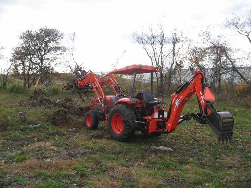

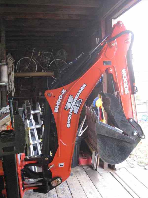

I stuck a Woods BH90x on my DK40se. Very nice piece of equipment. The BH80x is also nice and just a bit smaller. Either of those or the Kioti BHs would be good choices. These are all "name" products though so you may experience a bit of sticker shock compared to the Chinese 'hoe.
