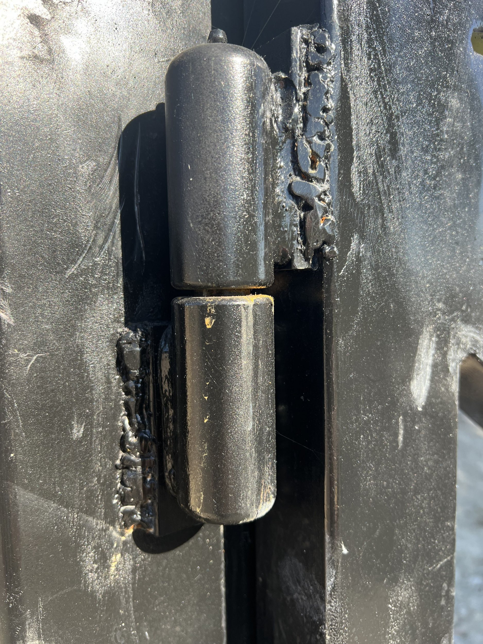

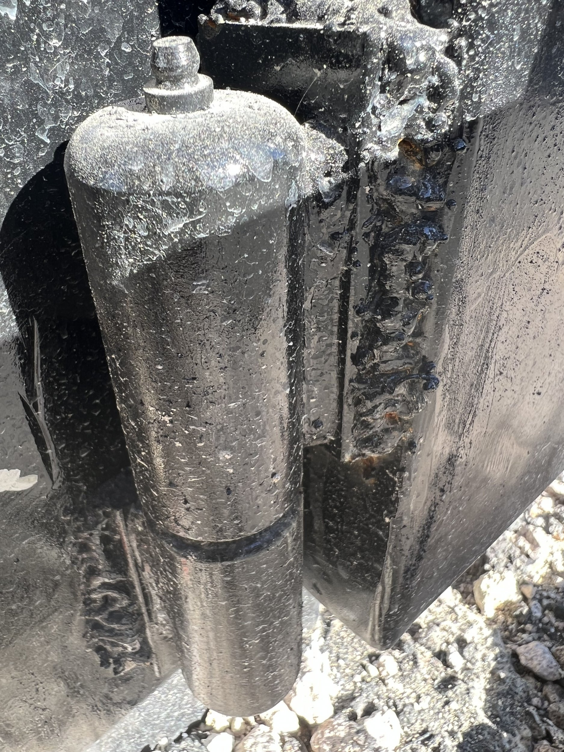

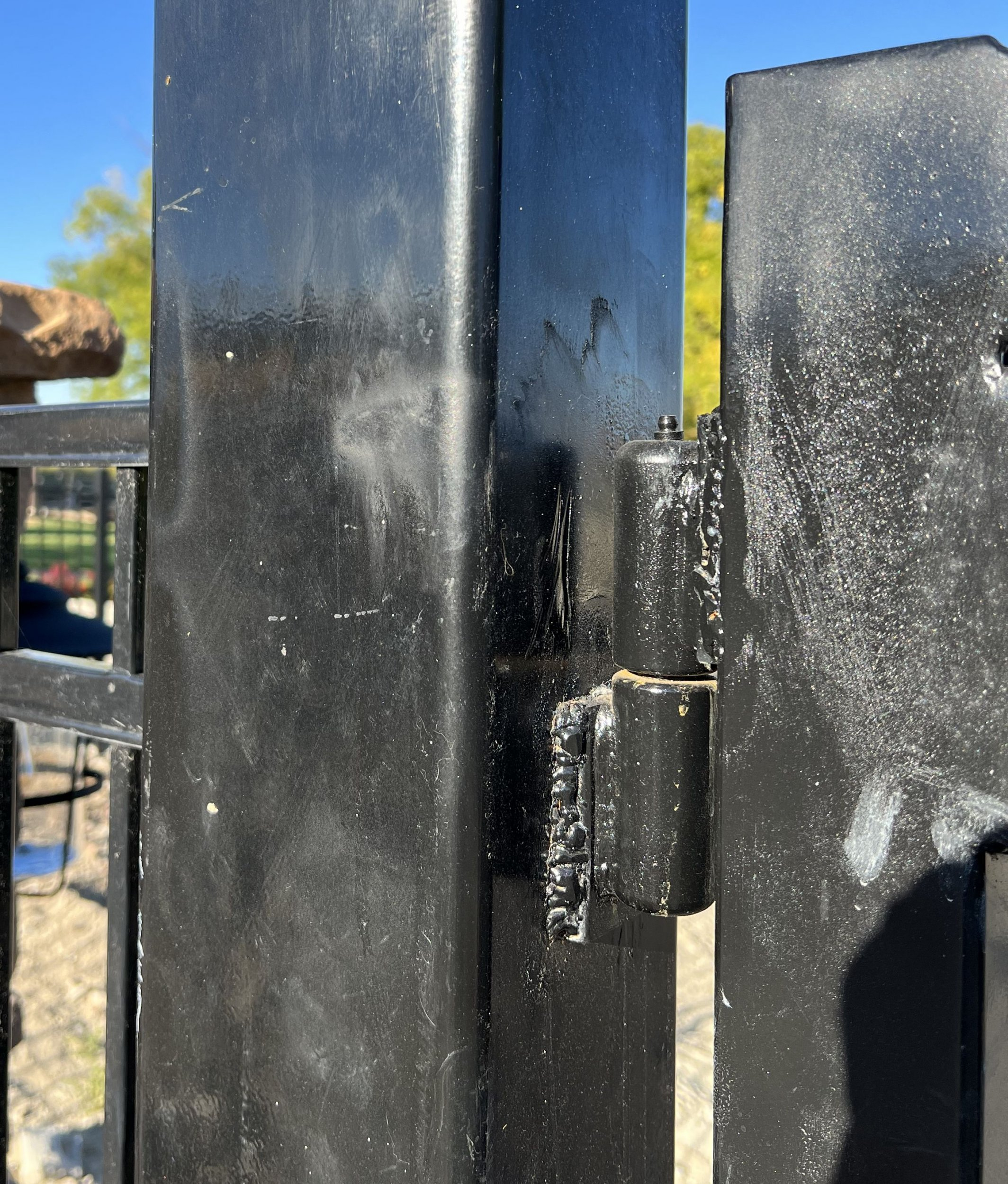

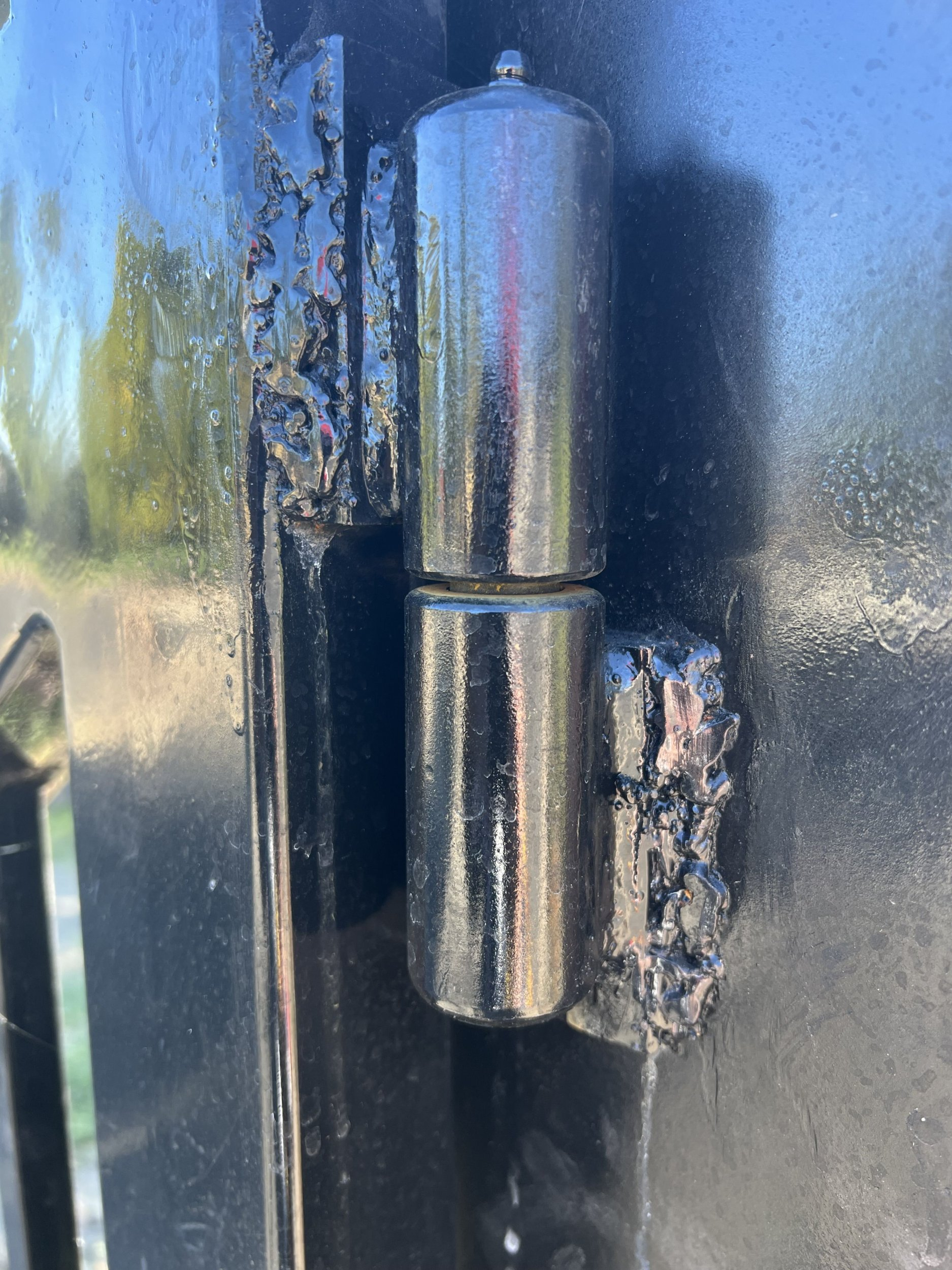

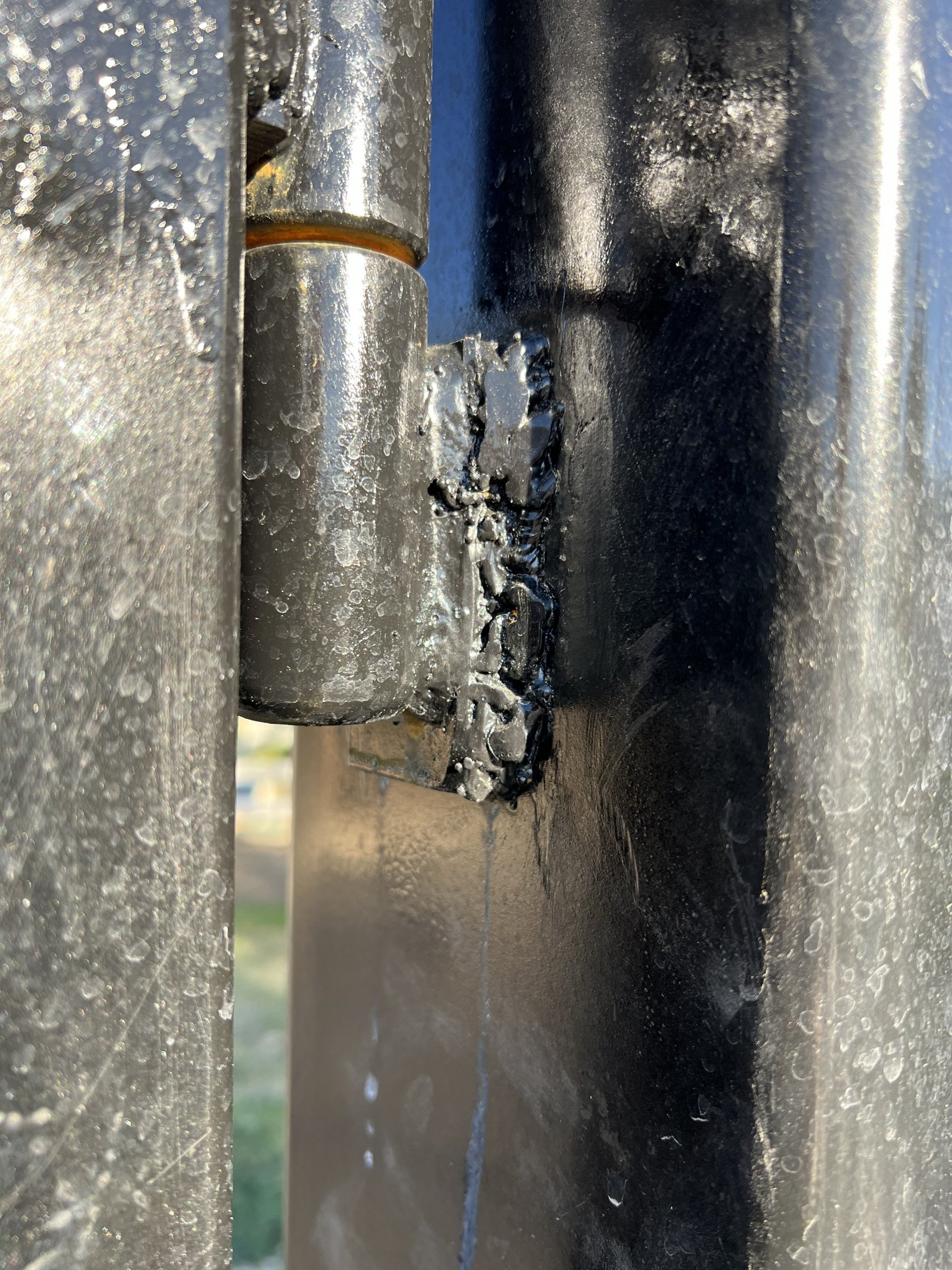

Jokingly I say your welds look like Crow poop on a fence post! I am retired from building power company line trucks and have welded for over 30 years. Guessing here, but it looks like you used a stick machine. Temp too cold with not enough penetration into the steel.
Solution; Brace up the gate. Angle grinder with stone wheel to gouge out the weld (bottom hinge first). Use 7018 rod and turn up the heat. Do a vertical test on two pieces of scrap metal.
Good luck

Did they like just use a car battery and some welding wire or what ? I’ve seen dirt cheap Chinese stuff come with better welds. No continuous pass , little to any penetration, porosity. I wouldn’t trust those welds for nothing. I’m honestly shocked the gate didn’t just fall off.

I am a NDE Level III (Non Destructive Examiner) (Level III means I am at the highest achievable level in this field) with 29 years experience in the nuclear industry. I currently am the program owner and level III in a USA nuclear power plant. I think I can speak to those welds as good as anyone alive. I do not even need my Ultrasonic flaw detector to interrogate these welds :) .
Pure trash.
Farm welds are typically no where near that bad. That said, I have seen some pretty crappy welds hold up to amazing abuse. I would have a real hard time paying for that bad of a job. If it was me doing the welding and that was the best I could muster from my $79 HF flux core MIG welder.... I guess that I would have to accept it. But paying for that would hurt a lot.
"$79 HF flux core MIG welder.... " Looks more like a 12 volt battery and jumper cables did this job.
