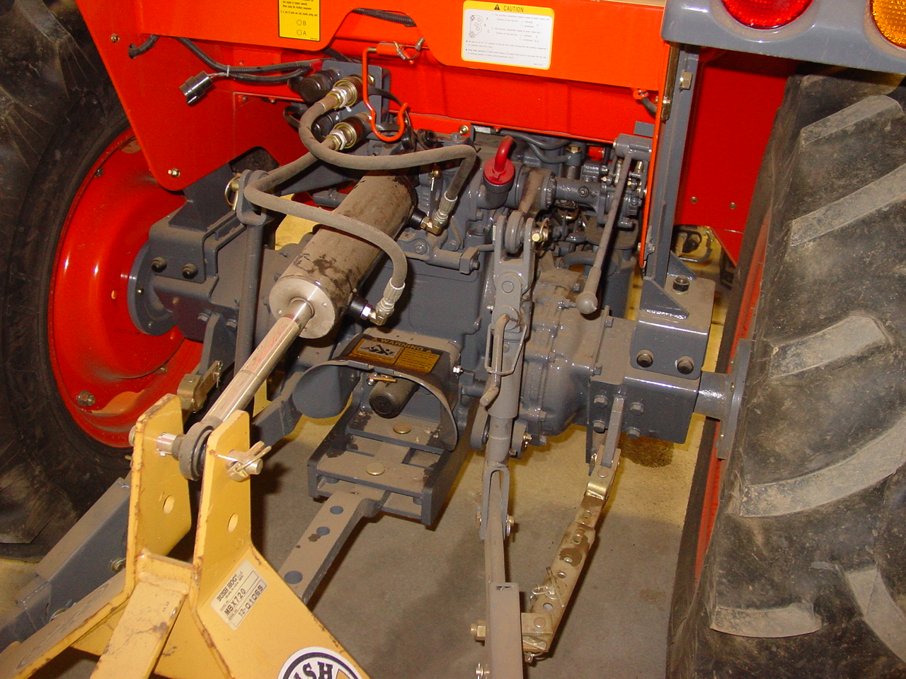

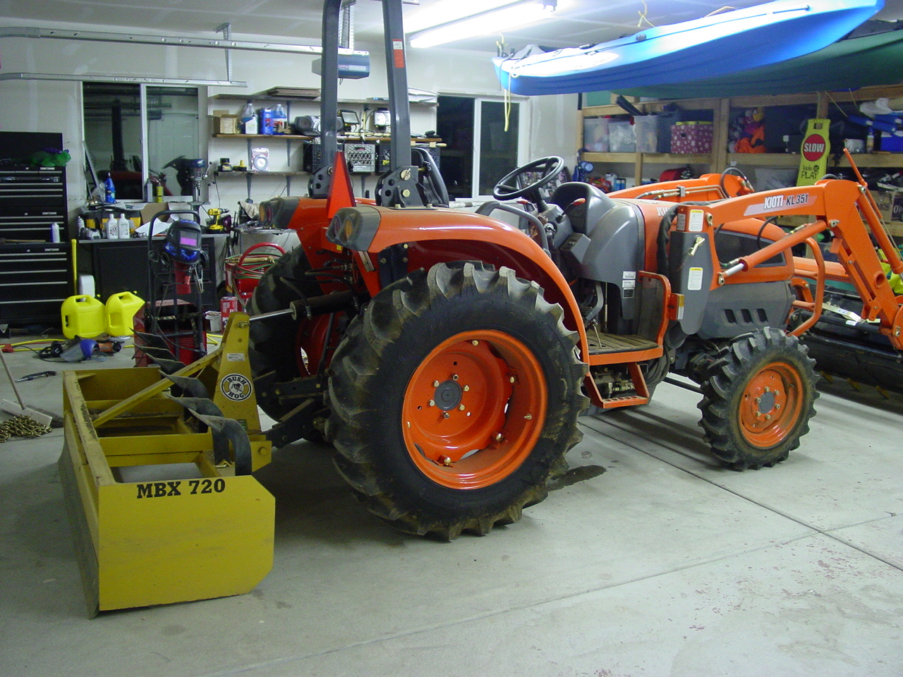

I just purchased a brand new Kioti DK35 and I am somewhat confused by the two 3-point levers. One lever shows the "arm" raising and lowering. The over lever show "deep" and "shallow"
When I pull either lever, they appear to do the same thing...lift the boxblade.
Also, they do not actually lift the boxblade off the ground until you get to about level 7 (of 10). Should it start lifting at 1 or 2?

One lever next to the right side of the seat (the outside one) is the position control and is used to raise or lower the implement. It should raise the implement almost immediately. The other level is the draft control and there is no reason to touch that unless you are plowing or using a subsoiler etc.
In the picture you posted you can also see a long grey lever on the right side of the 3PT hitch. That is a second position control level. Exactly the same function as the lever next to the seat I mentioned above but you can reach it while behind the tractor hooking up an implement.

As IslandTractor said, MOST work is done with the position control. If you are doing ground engaging work (and your box blade is ground engaging if you are using the scarifier teeth) you would use the draft control. The draft control will sense when the ground pull changes and compensate for that.
For instance,as an example we'll use a moldboard plow. All ground engaging implements would act the same to varying degrees. You would need to check you owners manual to see which of the top link holes to use for draft control. Notice that the casting with the holes for the tractor top link is hinged on one end. The other end is connected to the tractor transmission in some way, usually with a spring or rod. Some manufacturers use the top hole, others use the bottom hole. After attaching your top link on the tractor end in the correct hole you would lower the plow into the ground. The draft control will keep your plow at the depth you set, say for example 6". As you plowed, the ground hardness will change from time to time. When you hit some hard ground the draft control will automatically lower the plow to keep it from popping up out of the ground. When you hit a soft spot the draft control will lift the plow a bit to keep it from going deeper into the ground. All this will be automatic. The tractor operator does not have to continually raise and lower the plow as he would if he only had position control.
So even thought they at first appear to do the same thing, they are really very different. You would not use the draft control for mowing or any other non ground engaging work. However doing ground engaging work without draft control is a bit of a challenge. You have to try to sense when the ground changes and compensate for it with the position control lever. Most often you are a few seconds to late. Your plow is ether on top of the ground or 12" deep by the time you act. :confused:
