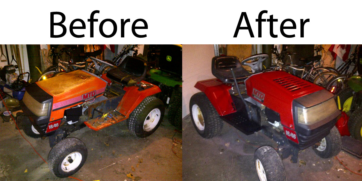

I have a twin briggs and stratton motor in my MTD and it isnt getting any fuel. It starts and runs fine if I put fuel down the carb throat. I bought the fuel pump kit but that didnt change anything. There is vaccume suction coming from the lower part of the engine but when I take my fuel line off at the tank there is no suction. I replaced the fuel lines and filter and there still is no suction. I need help to fix my problem. Thanks.
