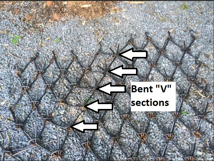

Hey guys. I recently bought a drag harrow and when it arrived, I noticed it was bent in areas. I guess someone tried to pick it up while it was still attached to something heavy and bent a section of the "V" pieces. I think it will still work but would like to hear some suggestions on how to bend those stretched out "V" sections back to their normal "V" shape. Fortunately the place I bought it from credited me back my full amount paid since it was damaged. I know I've said it on this forum before, but you just can't beat the customer service Agri-Supply gives here in NC. Great company.
So if anyone know's a method or tool I can use to close these stretched out "V" sections of the harrow, please let me know. I was thinking of some type of vise mechanism. The steel is very thick on this harrow. Trust me, it doesn't bend back with all my weight on it. I will need a tool on method. I thought about used the hydraulics of my tractor and lowering the bucket on each area to close them up but think that might be a little dangerous trying to hold it steady.
Here is a picture of the harrow.
   / Please Help. How to fix a bent drag harrow? #2
I would take a large plier and cut a slit down the middle of each jaw with an angle grinder with 1/16 cutoff wheel. That would allow you to grab around the wire and squeeze it closed.
   / Please Help. How to fix a bent drag harrow? #3
just use it you will not be able to tell any difference it how it works, waste of time trying to fix it
   / Please Help. How to fix a bent drag harrow? #4
I wish I could bend wire like that with pliers. :)
Bruce
   / Please Help. How to fix a bent drag harrow? #5
Bruce
That "wire" is actually as thick as your thumb or at least fingers. It's probably actually 1/2" or so rod.
   / Please Help. How to fix a bent drag harrow? #6
So use real big pliers.
   / Please Help. How to fix a bent drag harrow? #7
heat with a torch, bend or hammer it closed, then reheat and quench in oil. when it stops sizzling but still really hot, let it cool on its own in the air.
   / Please Help. How to fix a bent drag harrow? #8
Not worth effort of repair. Use as is.
