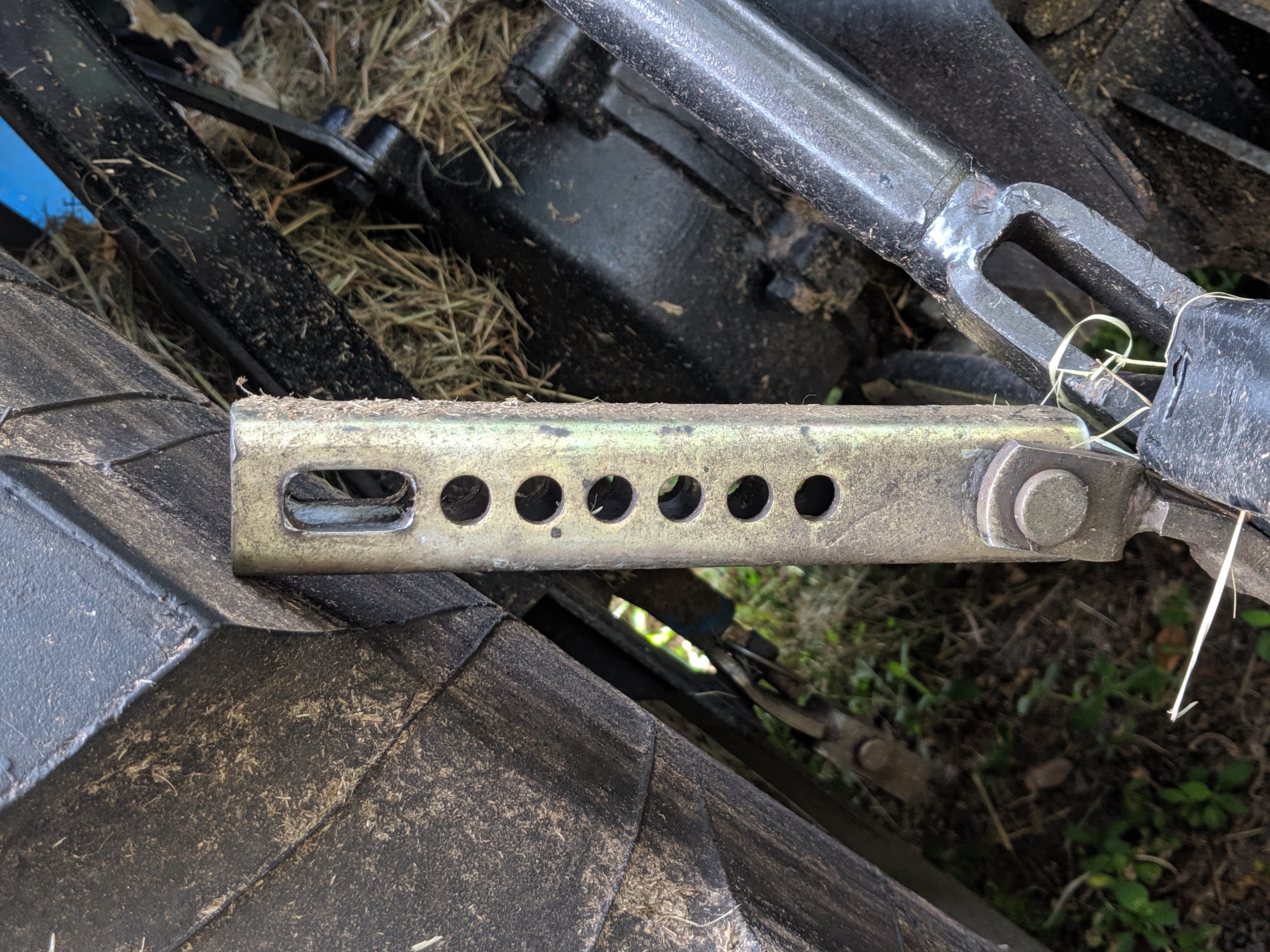

LS R4041 LL4101
Forgive my lack of knowledge....
Is this an LS specific part or a generic part? There is one on both the back left and back right to attach the bush hog to the tractor. This one broke - I know...unbelievable!!
Any guidance is appreciated. Than kyou.

That's a stabilizer. Should be generic. If you can't find one you can always take the square bar out of the other side and make one.
   / Please help me identify this part.... #3

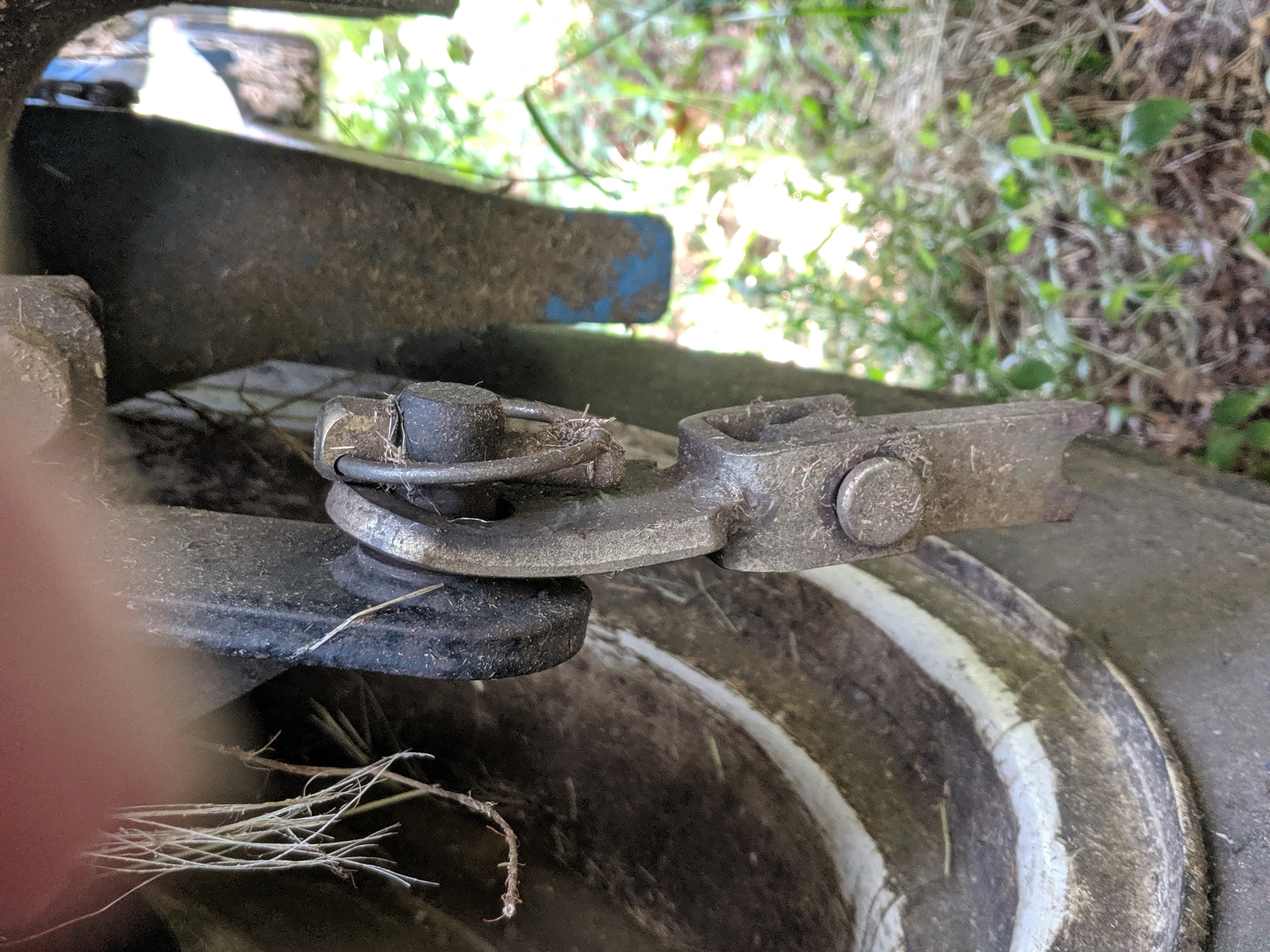

Its is your 3-point sway bar / stabilizer bar. They are both generic and specific to LS. Depends on what you want to do. If you want the one you broke, you will need to contact your dealer. They come is all different sizes and styles. This style has pins that hold the linkage in place. Others have turn buckles for the adjustment. They come in different thickness and lengths. If you replace that one with a generic one, you will need to replace the other side.
Come to think of it, I am not sure how the end connects to the arm. I think it's a welded pin? So, you might be better off getting the LS one.

You are looking at the Lift Arm stabilizer, They are left and right. Here the run $75.87.
I'll tell you how you busted it too.
The attachment you were using ether ;
1) while turning brushed up against something and pushed the attachment to one side.
2) the attachment was jerking sidewise back and forth and it busted.
3) while backing you did NO. 1
I've busted 2 of them.
they break when in compression . My dealer says LS does not sell the pieces separate.
They bolt to a welded pin on the frame. The new style of bracket is a clevis style the bolts on. they are $65 a piece.
