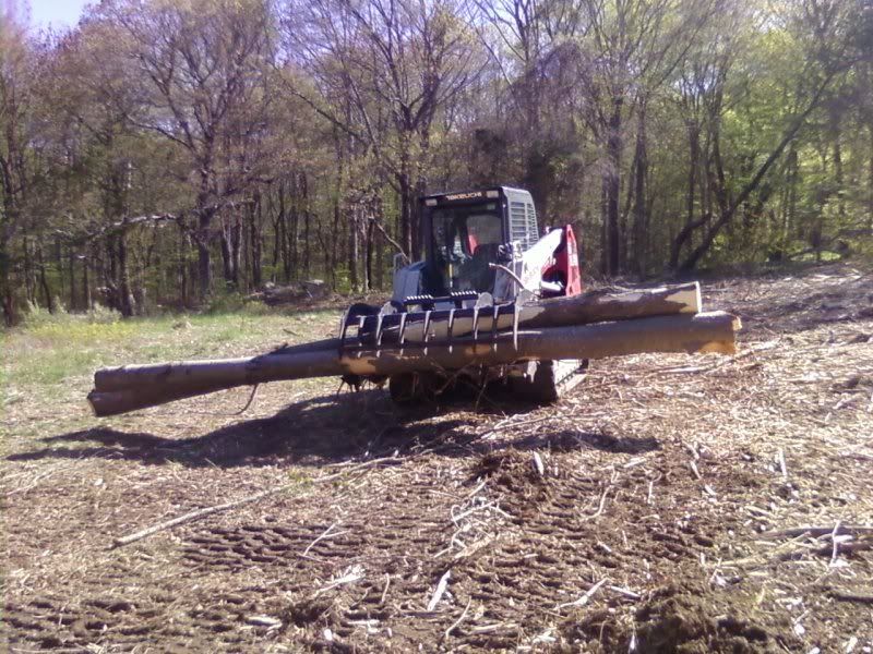

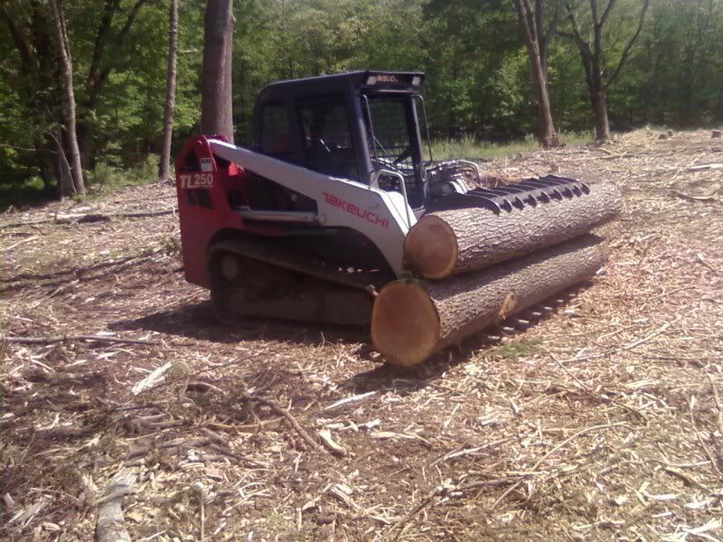

I bought the bobcat brand grapple 2 years ago and have worked it pretty hard picking up large trees. So far it has held up great. You can see a pic of it when it was new at keenlandclearing.com

Four years old and holding strong. It works good on popping small stump and raking mulch in to piles.. When I get another it will be the 84" instead of the 72" that I have now.
